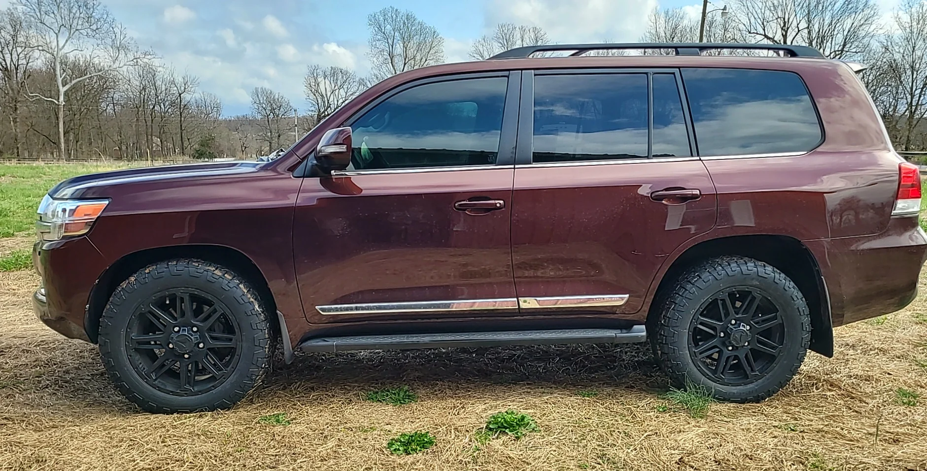

275/65R18 (32") BFGoodrich All-Terrain KO2, Tundra wheels. 91lbs each tire + wheel. Test fitment and test drive before installing on my brother's Tundra (not the green one shown below). Turn in slightly more responsive than Grabber ATX, which I attribute to the stiffer sidewalls of LT rating.
275/70R18 (33") General Grabber ATX, 2018 Land Cruiser wheels. 78 lbs each tire + wheel. Installed Nov 2021, so not many miles to give long term feedback. I'm still experimenting with on-road tire pressure in the 31-38 psi range. Initial feedback on-road is noise levels on par with the KO2. Noticeably more, but certainly not objectionable, noise than the OE Michelin Latitude Tour HP, but those are very street biased, crossover tires . So far, my wife and kids have not mentioned one iota about tire noise. (very) slightly softer ride than KO2, but I attribute it to the load rating SL (General) vs. LT (KO2) and slight bit of additional sidewall. My first choice was KO2 because of the rugged appearance and legendary performance, toughness, and durability, however the feedback about sketchy wet weather traction turned me off. This is my wife's daily driver and family trickster, so I didn't want to be concerned about wet traction. Furthermore, 90% driving will be on road, but I wanted the capability, confidence, and assurance of a capable all-terrain tire when the chances and opportunities present themselves. The only rubbing was the outboard shoulder against the front splash guard inboard couple inches at nearly full lock. That was remedied with a heat gun and 2x4 reshaping the plastic a bit. These are the summer tires; Bridgestone Blizzak DMV2 (255/70R18 = tall and skinny) serve winter duty. Therefore, winter traction wasn't very high on priority list for all-terrain tires.
Now that I've had the 33s on, there's no going back to smaller tires. I like how they fill the wheel wells. All these view with suspension set in N mode.

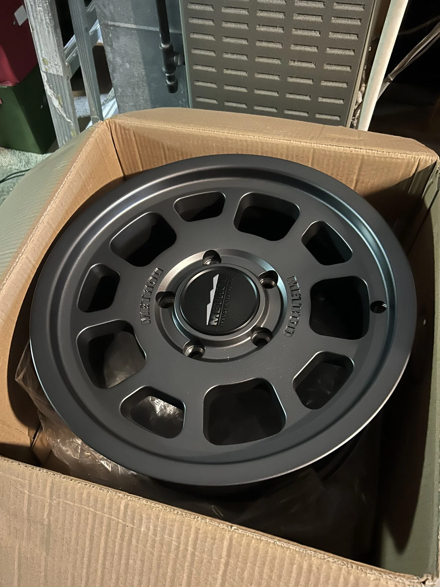

I just picked up a set of MR705 Methods in a +35mm. Does anyone have a suggested lug nut for them? Due to how shallow the center of the wheel is, I would like to keep the nuts as short as possible.
Picture stolen from a for sale thread in the classifieds of the same wheel I bought:

I bought the method lug nuts 💁🏻‍♂️

The ones they sell are extended and suspect they will stick out pretty far. I have some like that already from my F150 wheels and was hoping for something a bit shorter.

So the ones that are called "extended", are not usually extended out past the wheel face, they are extended down the wheel stud. This is to get more thread engagement between the lug nut and the wheel stud. Usually extended is what you want with the aftermarket wheels.
edit:
Well, looking at the pictures, maybe Method's lugnuts are just longer. I guess what i was talking about was actually called "ET style". I always just assumed that was "extended thread" or something like that. So not sure on the Method version. NOt sure if these wheels require the spline drive, but most spline drive lugnuts are pretty tall.

I was looking at the ET style with the sleeve that extends into the bore, I'm just not sure how far out the studs will stick out and how deep the nut needs to be. But, yes, I think the method lug nuts are just tall/deep.
I ran longer nuts, which look exactly like what Method shows, on my F150 wheels but they were +12mm and the nuts still sat flush or just inside the wheel face. The +35mm MR705's have almost no depth to the lug nut pockets and I dont want it too look like some mad max/deathrace 3000 car :rofl:
