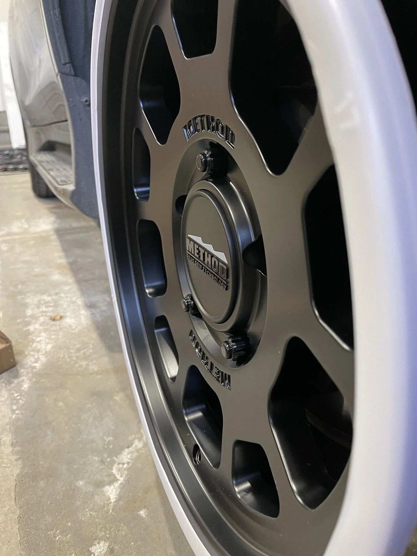

I was looking at the ET style with the sleeve that extends into the bore, I'm just not sure how far out the studs will stick out and how deep the nut needs to be. But, yes, I think the method lug nuts are just tall/deep.
I ran longer nuts, which look exactly like what Method shows, on my F150 wheels but they were +12mm and the nuts still sat flush or just inside the wheel face. The +35mm MR705's have almost no depth to the lug nut pockets and I dont want it too look like some mad max/deathrace 3000 car :rofl:
@tbisaacs

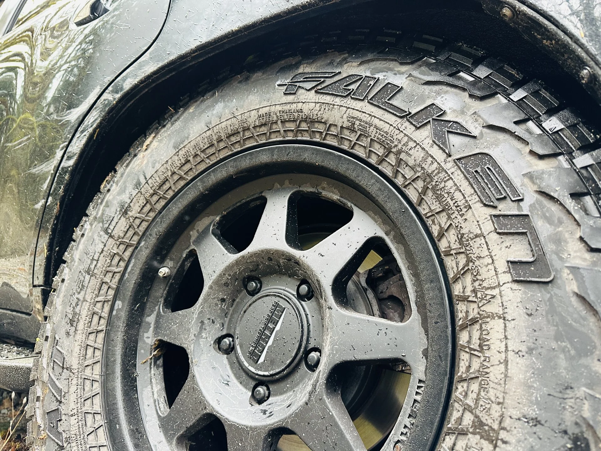

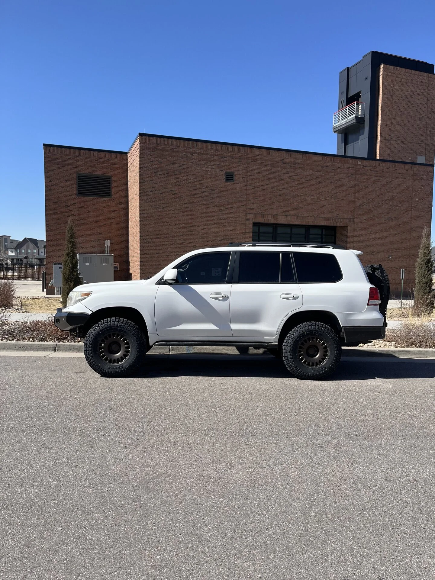

Yours definitely look better than the few pictures of Tundras I saw. Your wheel appears to pretty much have the same face as the one in question. I wonder if you have the extended or regular lugs (I'm guessing regular).
65a6124a-b850-41a6-9f9e-d2adb2995c9a-jpg.676894

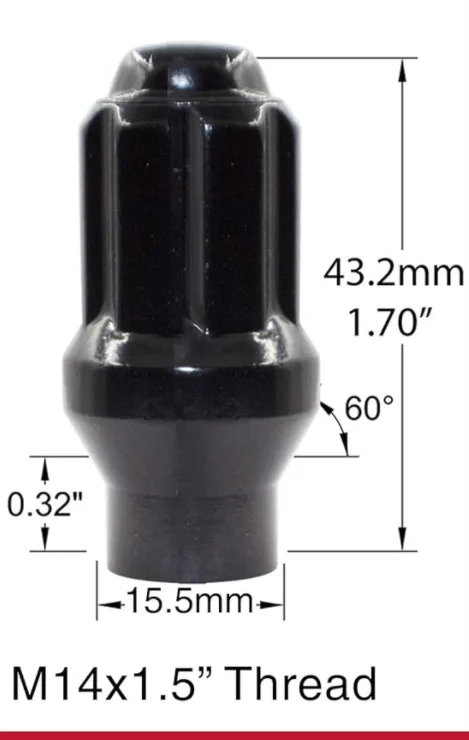

If you take the vehicle filter off at Method's website, it will show you more lug options, including a M14x1.5 (not extended for a 6 lug vehicle). If nothing else, I'd order the 6 lug version whether going extended or not, since there is no price difference on Method's website. Might as well have 4 extra lugs for the parts bin.

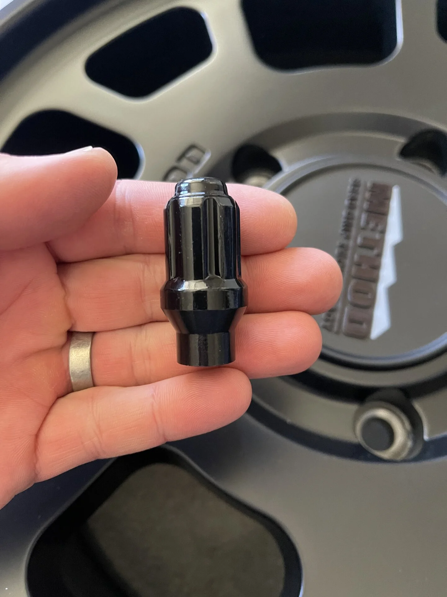

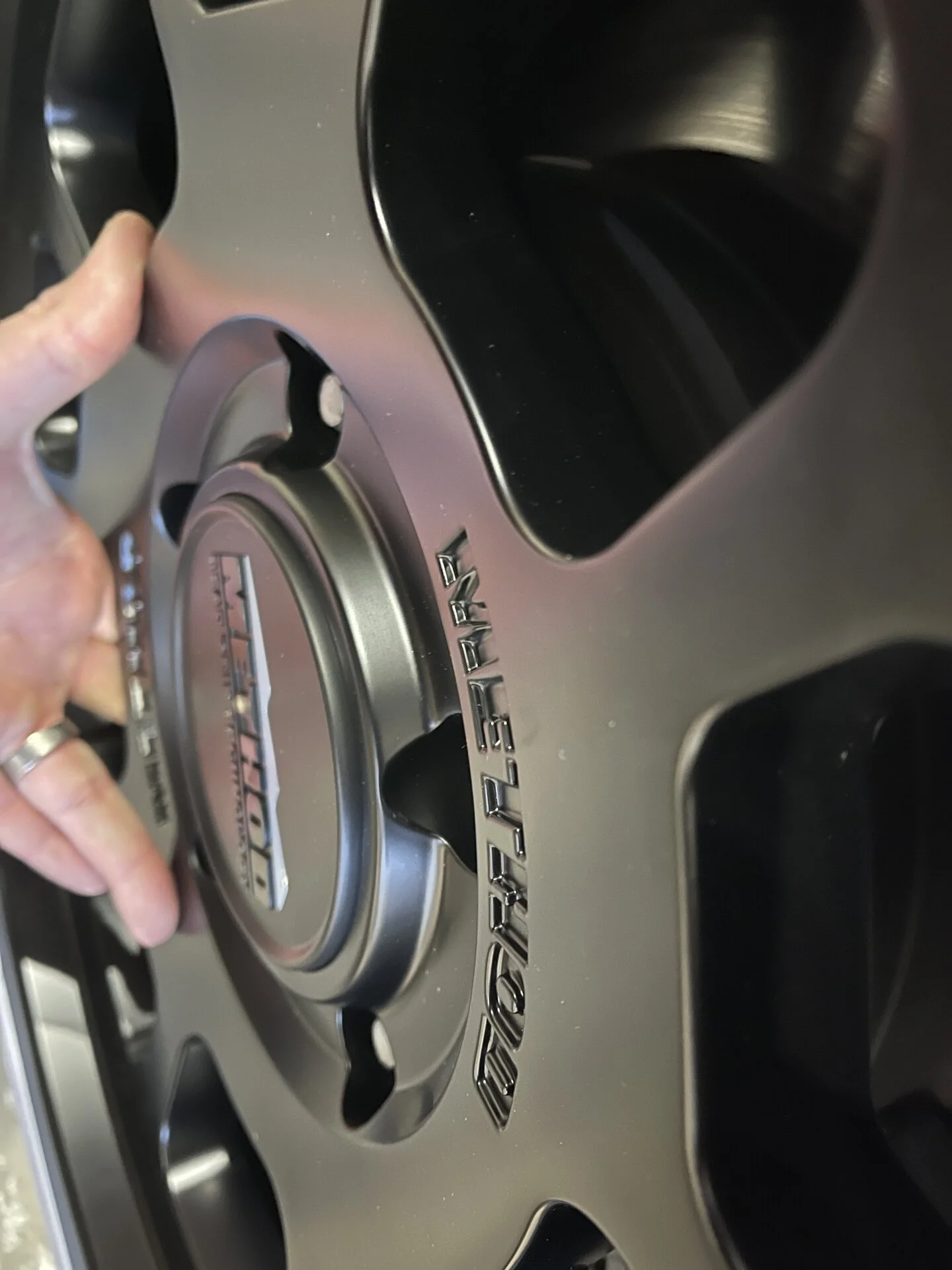

Got my +35 MR705’s and bought these “stubby” ET nuts off Amazon and they sit pretty good. Hopefully they are deep enough for the studs.
The studs done even stick out past the face of the wheel so there is plenty of depth to the nuts I bought

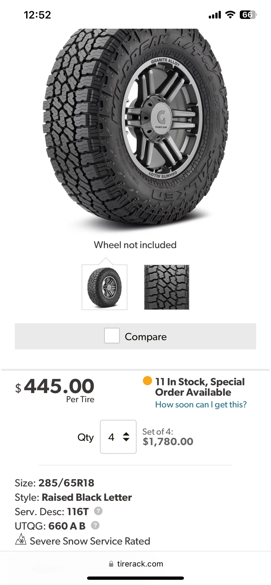

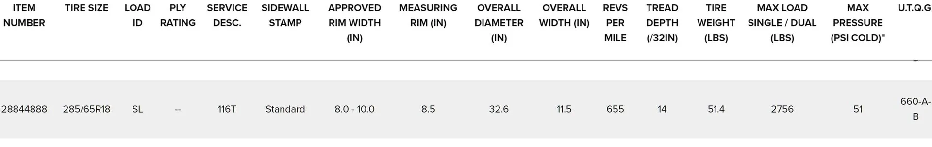

Do the falken wildpeak A/T4W in a 285/65 SL r18 meet the load ratings for a stock LC200?
Before this thread gets any more confusing - or off the rails with misleading (i.e. false) information...
Assuming you mean this tire:
The short answer to your question is, yes, these tires have plenty of load carrying capacity for use on your stock LC200.
The rationale for that short answer is as follows:
The stock tires on an LC200 have a Load Limit of 2,512 lbs @33psi RCTIP (Recommended Cold Tire Inflation Pressure)
For the Falken ISO-Metric 285/65R18 SL 116T tires to achieve the same Load Limit as the stock tires, they must be inflated to an RCTIP of 33psi. This will actually result in a Load Limit of 2,579 lbs which is slightly higher than stock, but 33psi is the nearest whole psi value above the required 2,512 lbs.
So...
The detailed answer to your question is, the Falken tires should be inflated to the same 33psi as your stock tires to achieve the same load carrying capacity as your stock tires.

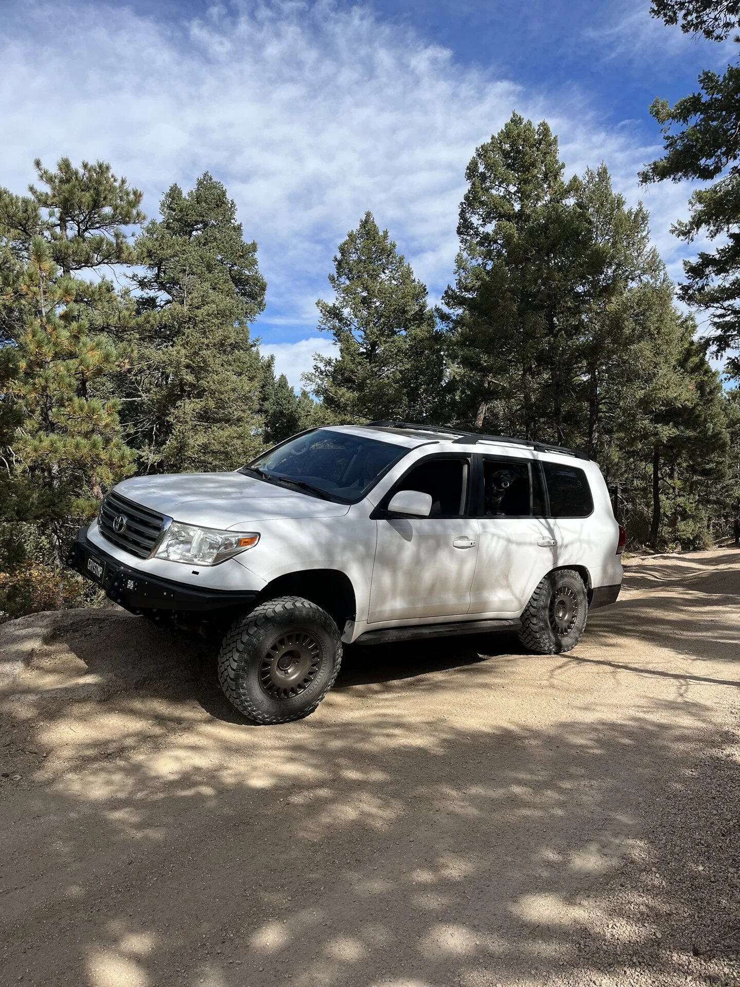

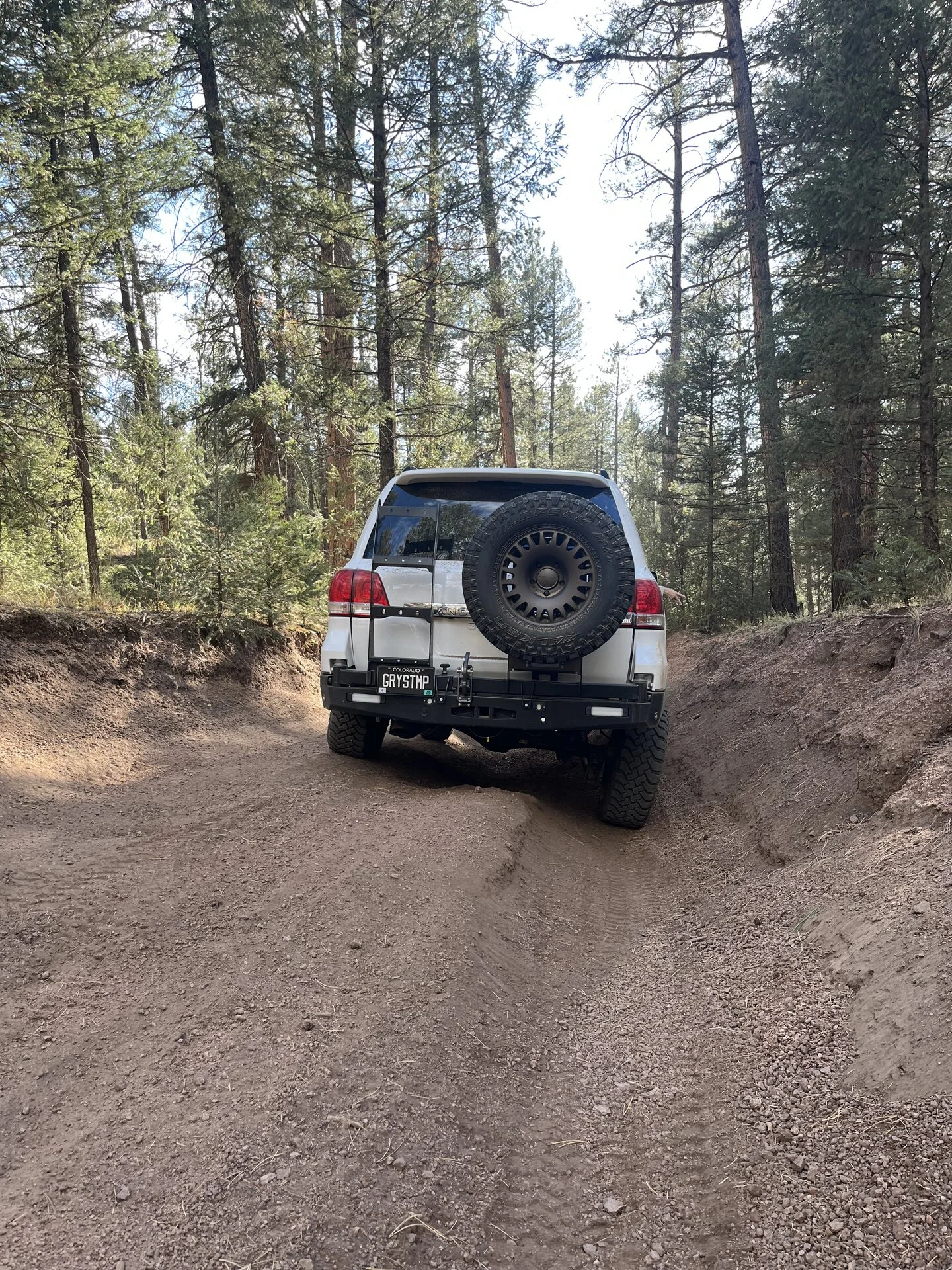

Here is our 200 running Nomad Sahara's 17" with 0 offset and LT285/70R17 Falken Wildpeak MT01. Will probably swap the Falkens out for some Kenda Klever's 35x10.5r17 soon.
View attachment 3458129View attachment 3458133
Awesome! I have been considering the Nomads as well (Convoys), but i was a little concerned with the 0 offset.
Any issues? Everything tuck nicely while articulating?
No issues with the 285/70 r17s. I now am running the 35x10.5 r17 Kenda Klever RT. They are narrower and taller, so I had to trim some plastic out of the side skirts on the inside.
