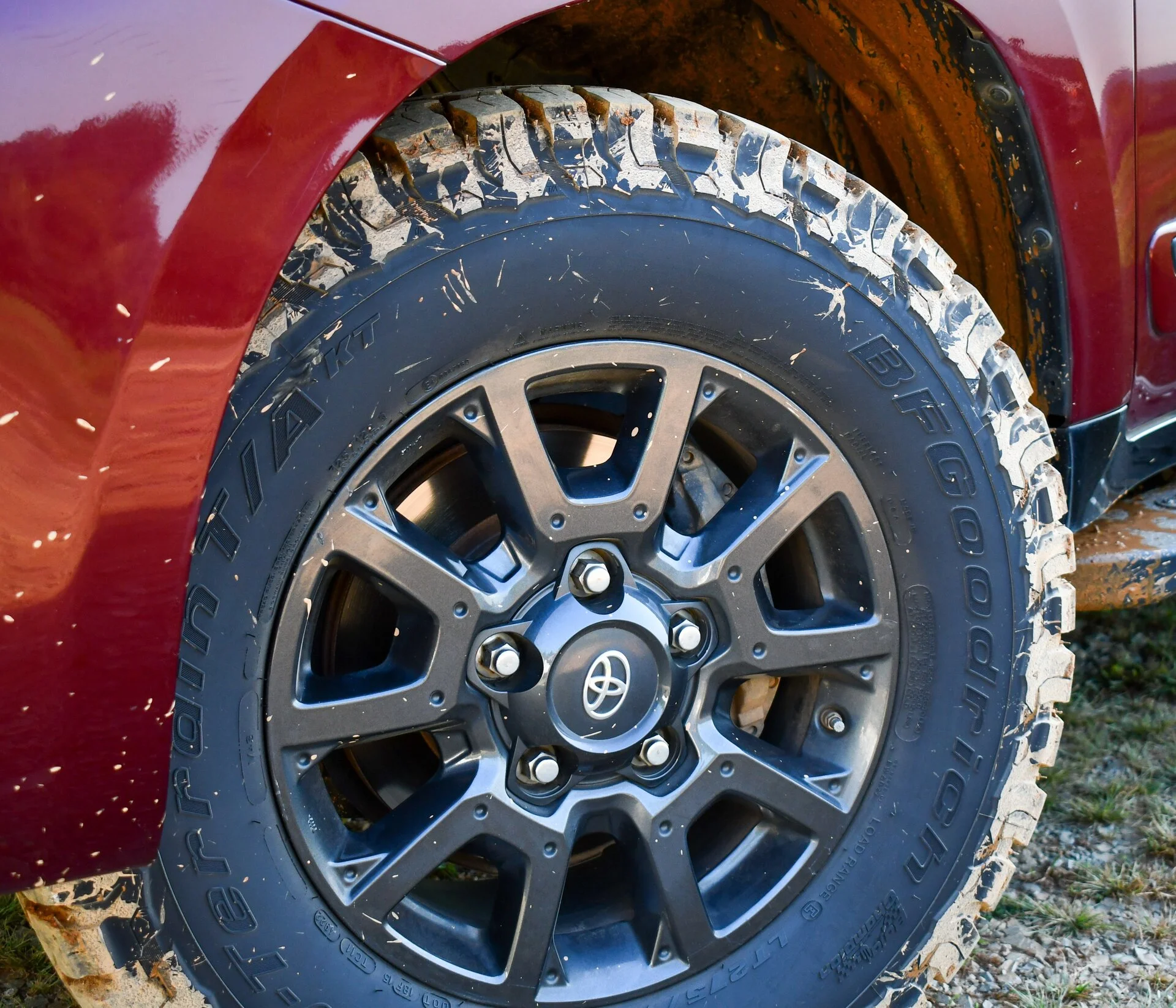

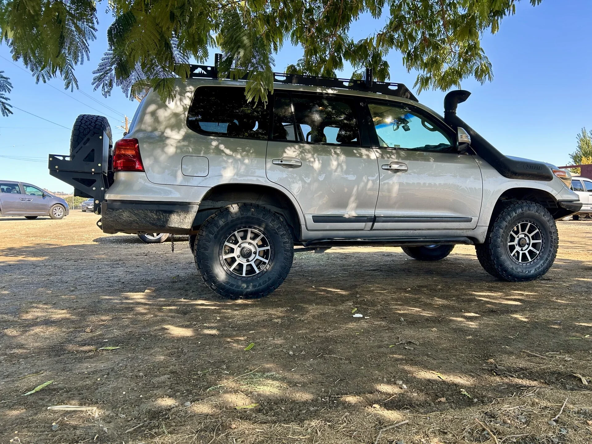

Does anyone know if these are OEM or simply painted Tundra wheels? Might be able to get the answer from @LFDOffRoad as it's the pictured LX on their website. They appear more grey than black and like the look of them.
Hey, that's my LX. They're Tundra Trail Edition wheels, they come in that grey. Its almost the MGM paint color.
I've got BFG HD Terrains on them now

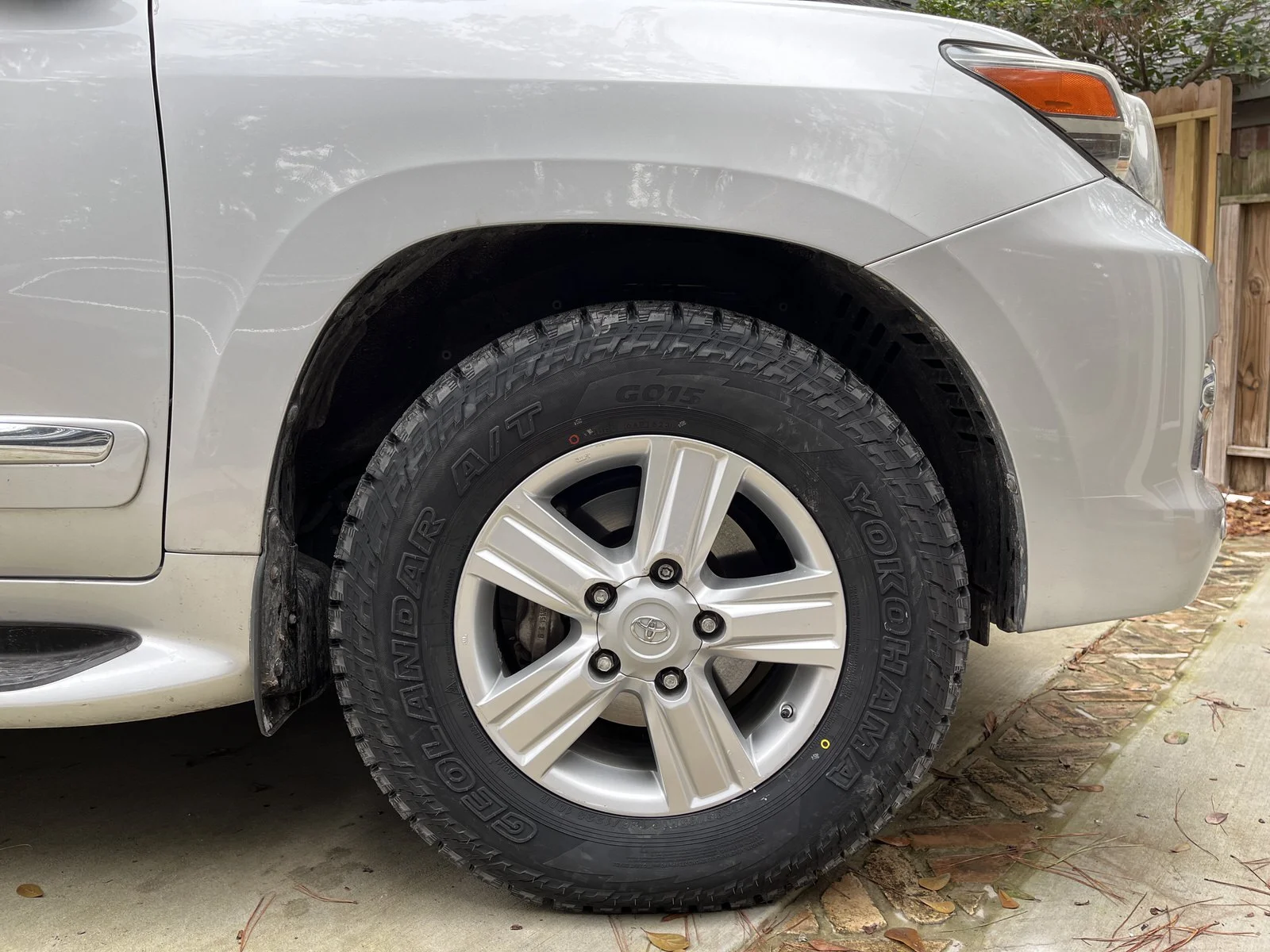

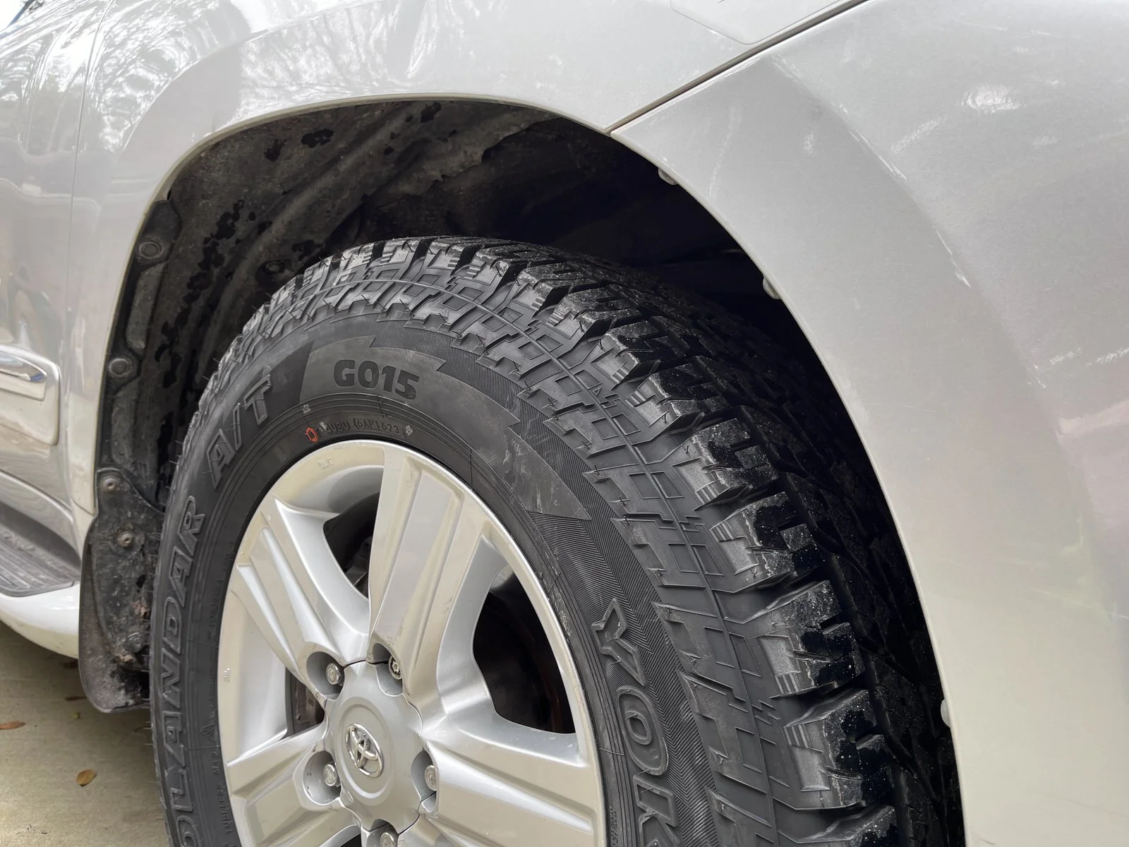

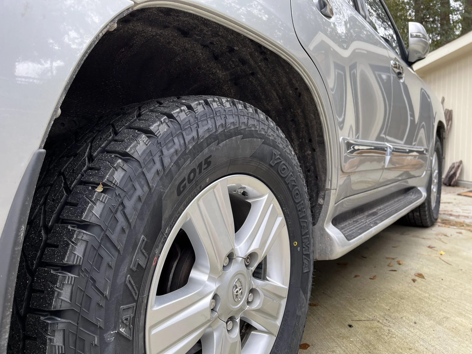

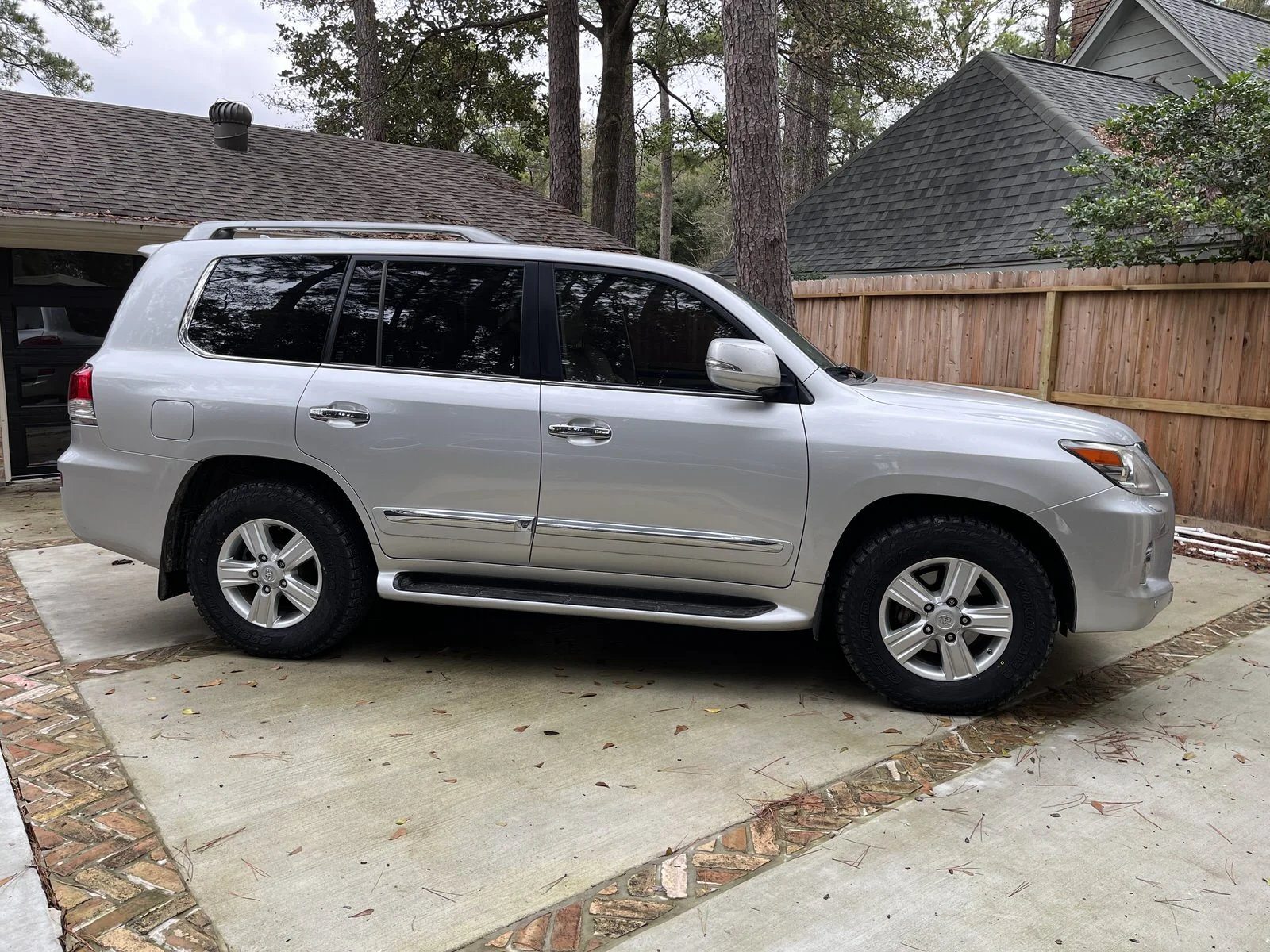

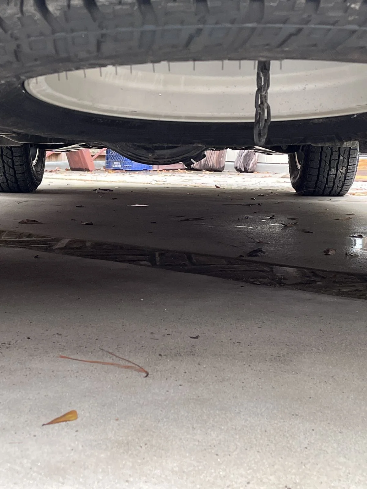

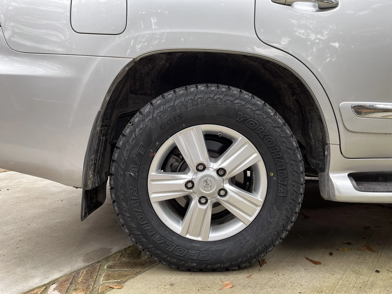

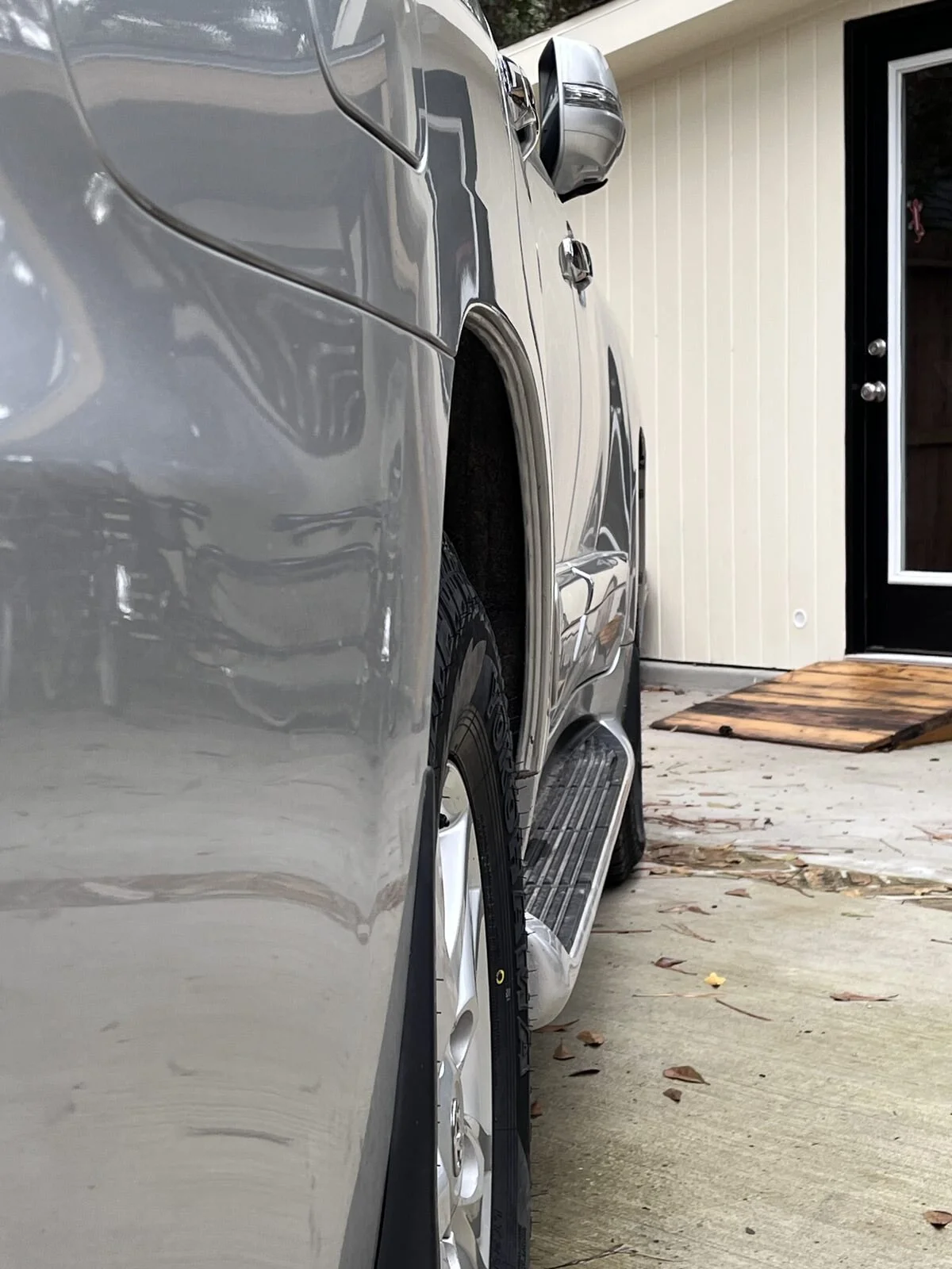

Just installed 2015 LC wheels on my 2013 LX with Yokohama Geolandar A/T G015 LT 285/65 R 18. No rubbing, just absolutely barely clears control arms, flaps and plastics. Perfect fit if you don't want to modify (that said, my mech did adjust camber a bit in anticipation of bigger wheels, so perhaps that saved me). The tires are 32.8". $275/tire from Discount Tires (price matched to Amazon). Thanks a ton to everyone who provided input and for all the existing info on Mud (@TeCKis300 @gaijin @bloc

Nice. Looks like you're all set for your trip!

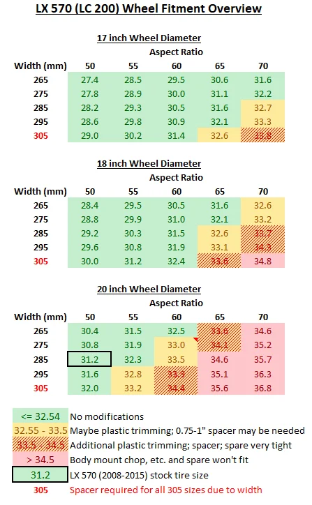

In my research on here and search for tires on my 2013 LX, I created the below matrix. This is based on comments here and in the Google Sheets database. It is not an absolute so do your own research! But I thought it might help some folks.
Note:
  • This assumes stock wheel offset
  • Actual tire height can vary fractionally so check the manufacturer's stated size.
  • Tires have different cross-sectional curvatures (I just made that term up) (i.e., 90 degree vs sloping) according to Discount Tires, so that could be another nuanced fitting factor between brands in the same size.
  • This may not apply to a 2016+ LX (mine is a 2013) as I am not sure if the plastics and control arms are identical to pre-2016. It also may not apply perfectly to the LC, but at least the tire heights are useful.
I'm happy to revise the notes or add more detail if the experienced folks have suggestions/advice. I can also set this up as a Google Sheet if desired. Just want to offer something up that may be useful in exchange for other's help here.
