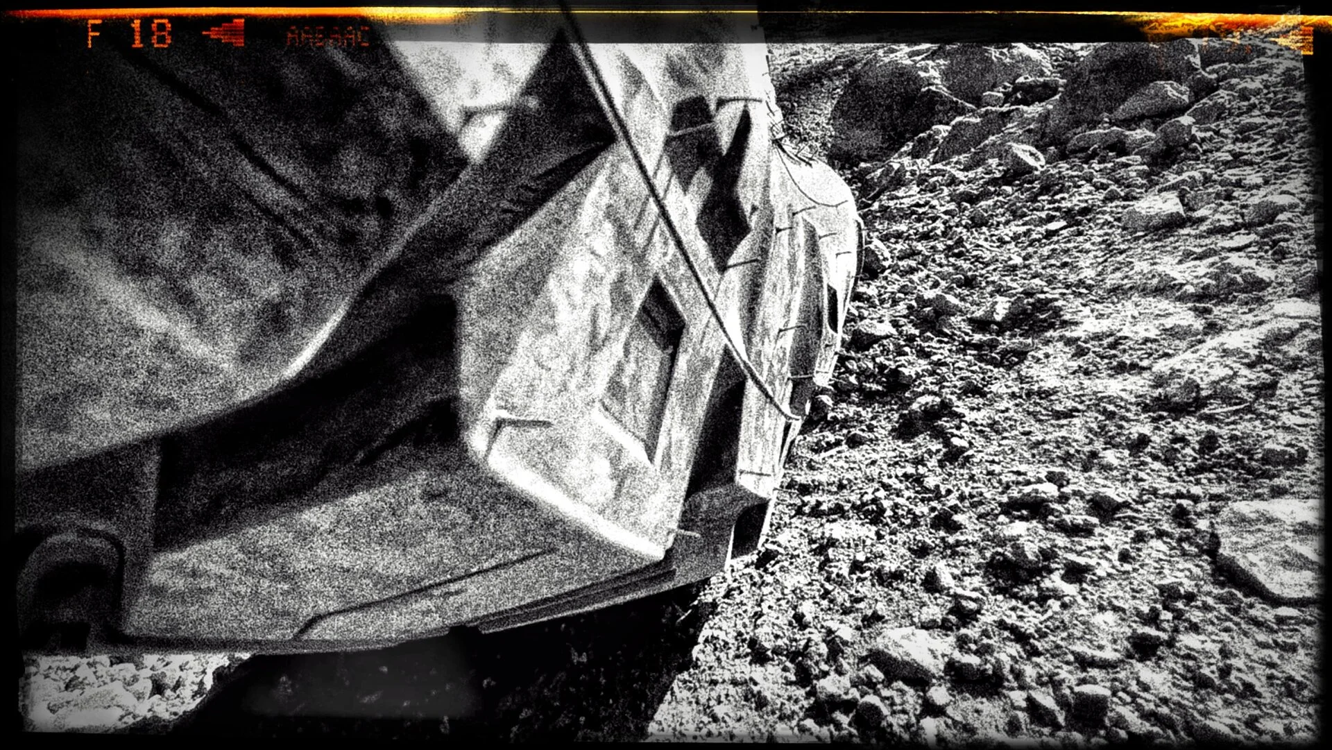

Just joined 35” club. For the 200 anyway. Been on 35’s for 20 years in my fj40. Running a 2” Ironman lift with 17 x 8.5” Icon rebound wheels. Just replaced 34x 10.50 BFG’s. They were pretty good but on the smallish side.
*** had to remove the mud flaps

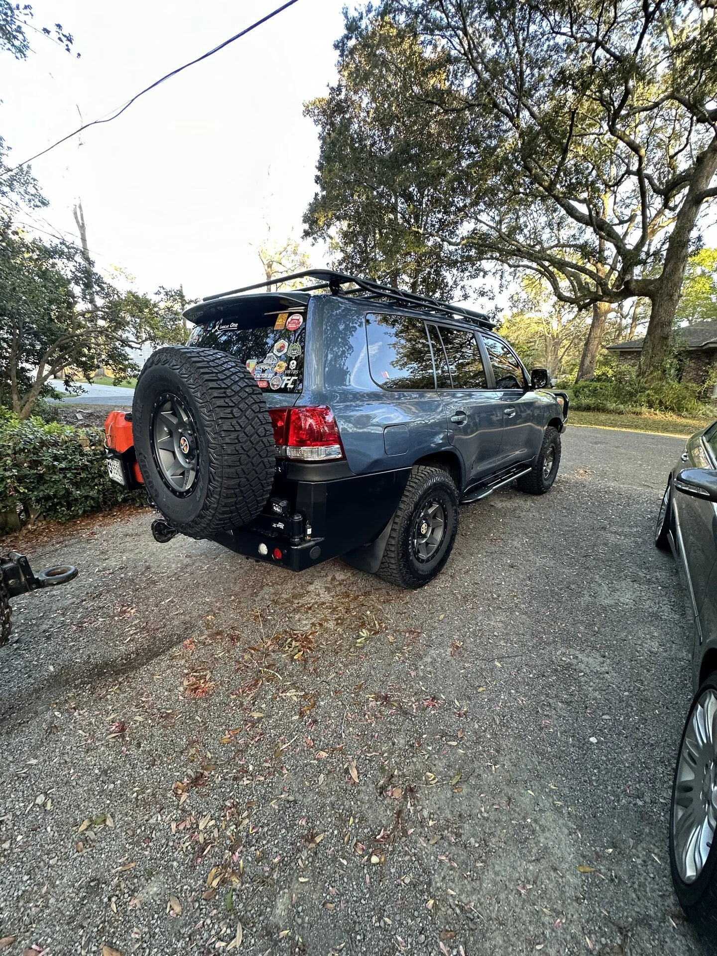

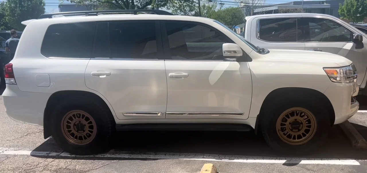

Thinking about running 285/75/17 on Rock Warrior wheels on my stock 200. Any feedback on any trimming that I need to get done? Or if they fit no problems?
Just got new OEM shocks installed with the OEM 1/2" front spacers to level the height.
Thanks in advanced!
I’m running that size with cooper at3 xlts. I was running 35s, which needed trimming, but I doubt you’d need to do much else with this size if you have a lift and can mold the flaps and plastic bits. The wheels are also 0 offset so that probably helps, but I’ve seen others here with a suspension lift easily accommodate the size

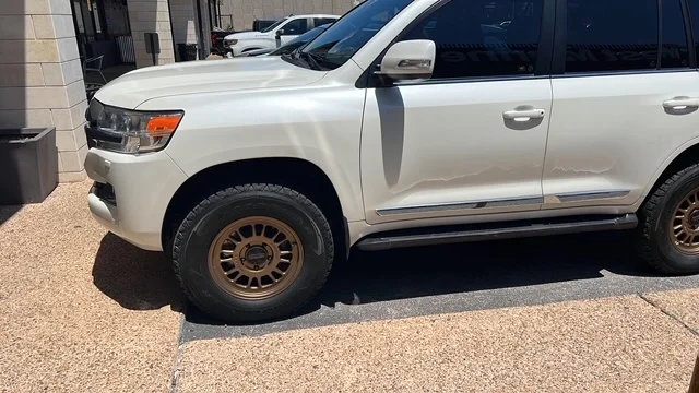

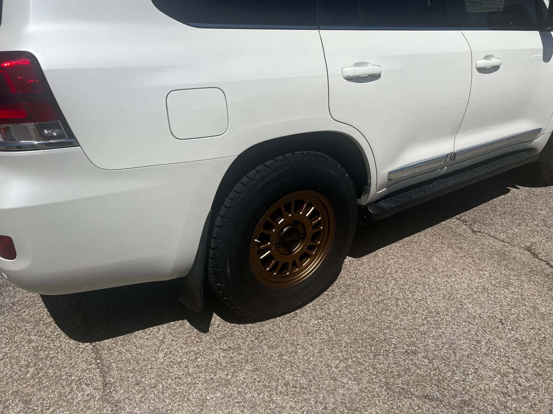

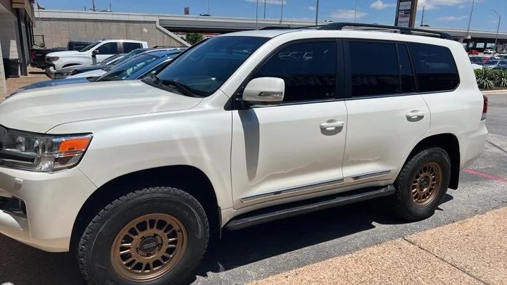

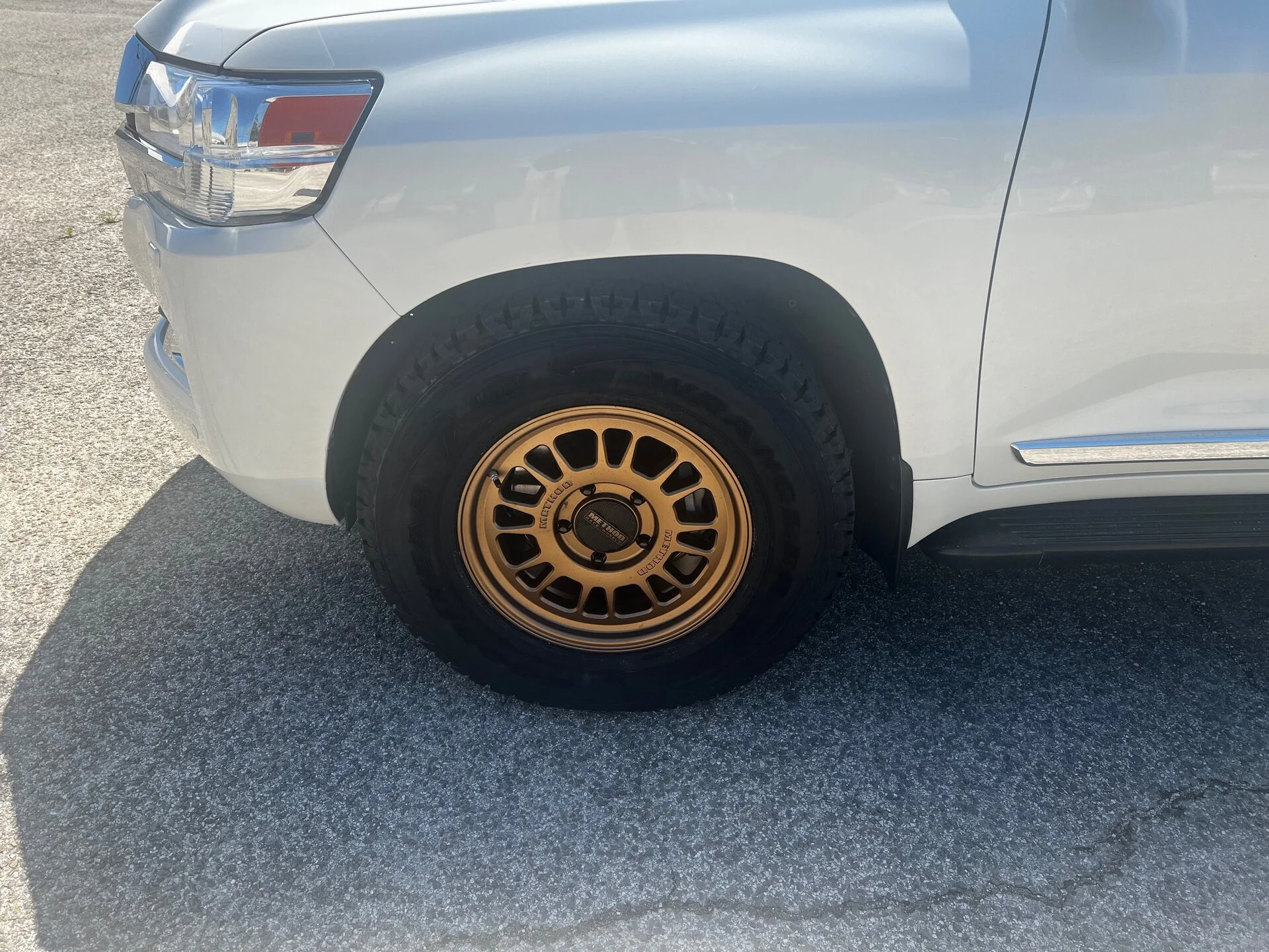

275/70/R18 Goodyear Wrangler All-Terrain Adventure with Kevlar on Method 318's in +40 (18x8.5 | 5x150 | 40/6.27")
My suspension is stock and the fronts rub at full lock. I ordered the Bilstein 6112/5160 setup (47-311145, 25-311402, 25-311419, 53-292018) which I hope will cure the rubbing. If not, I'll bust out the heat gun.

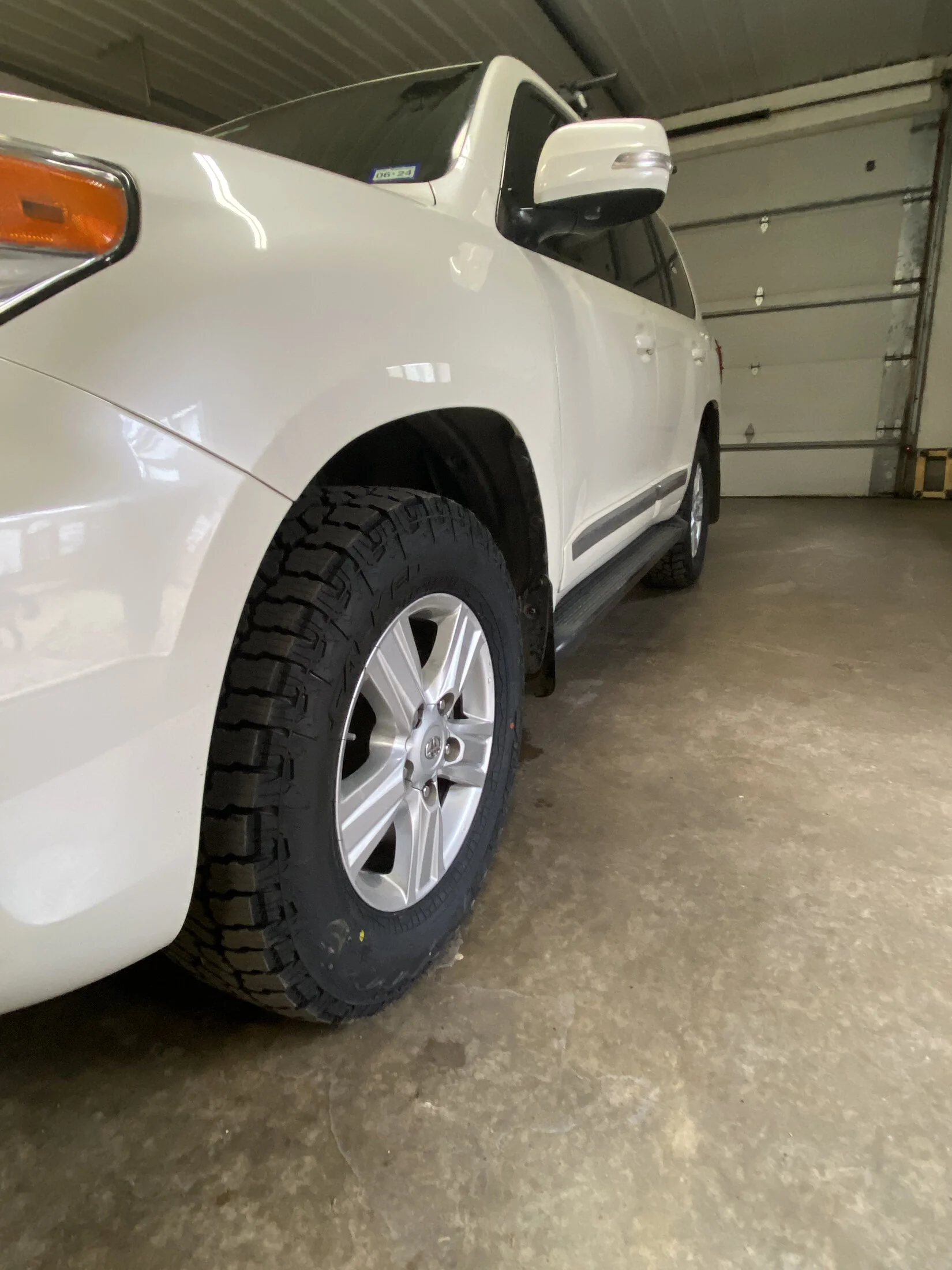

I just ordered up some 275/65/18 SL Wildpeak AT4Ws today. Decided to play it safe with something just slightly larger than stock but a more aggressive tread. I currently have have LTX AT2 in the same size, I just don’t like the look of them and they’re not great in snowy/slushy conditions. I also didn’t want to fuss with any sort of rubbing. Will report back tomorrow after they are mounted. Either I’ll love them or feel like a d-bag for not getting bigger tires.
View attachment 3595437View attachment 3595438View attachment 3595439
I put on the Bilstein 6112's with the height set to 2.2" (perch 4, per Bilstein) and the rear 5160's and 1.75" springs (53-292018) and still have considerable rubbing. I haven't pulled the wheels to hit the areas with a heat gun, but they DEFINITELY do need some massaging to fit without rubbing.
The rubbing was fairly minor before the lift (a little rubbing at full lock,) and minor again before the alignment (rubbing at full lock when backing up with the wheels full lock to the left), but following the alignment, it is considerably worse and now needs to be addressed. I think those Goodyear Adventures are bigun's!

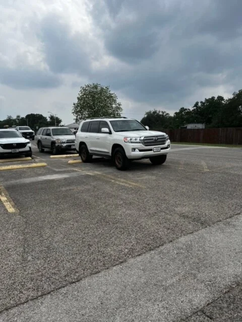

Not the best photos but here are the 275/65/18 SL Wildpeak AT4W. I do also have the front spring spacers installed. Initial impressions - smoother ride than the Michelin LTX AT/2 of the same size and also quieter, surprisingly. Can not comment on MPGs yet, have only driven around my own neighborhood so far but at 8lbs heavier per tire than the LTX I expect a very small decrease in fuel efficiency. I think the sizing is great for someone (like me) wanting an aggressive upgrade of stock size, but also with no rubbing and still plenty of wheel well, and these are $290/per compared to $445/tire to jump up to the 285/65/18. I have no regrets.
