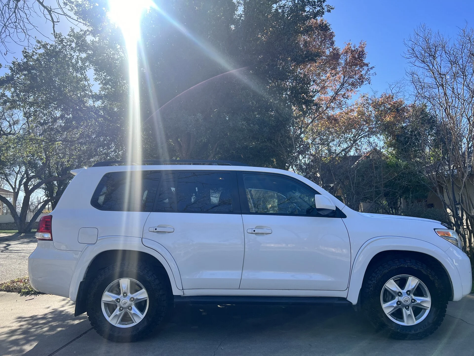

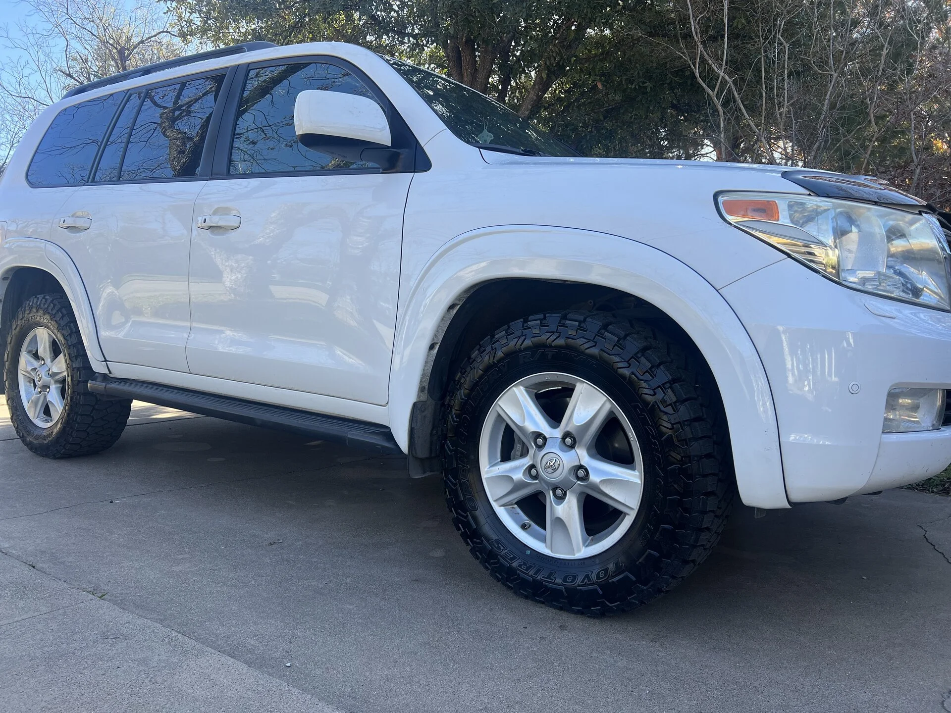

Just added my info to survey. In short:
No modifications to truck
275/60/R20 KO2s
~5k miles since install
No rubbing
~10% drop in MPG (to be expected)
Barely noticeable increase in road noise, honestly might just be in my head
shown below with AHC set to high

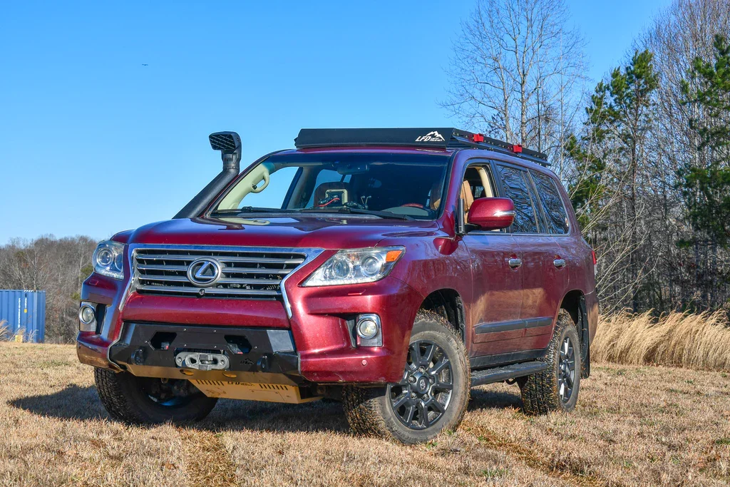

Does anyone know if these are OEM or simply painted Tundra wheels? Might be able to get the answer from @LFDOffRoad as it's the pictured LX on their website. They appear more grey than black and like the look of them.
  • Like
Reactions: D19
they are definitely Tundra wheels. Some models came in a solid black, I believe the first year or 2 of the TRD Pro came with this wheel in solid black. One of the other TRD packages came with it with a two toned machined finish. Lots of people have powder coated and painted these as well, so could be either.

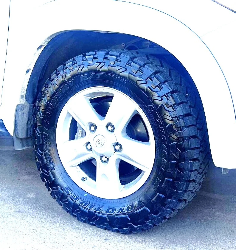

Posted on a different thread but will post this in database thread for everyone's reference.
Toyo RT Trail 295/70r18
Normal height:
Side view:
Spare just fits in spare location like a glove. Was waiting for black ET lugs to come in but had to use chrome ones temporarily. Have since changed them out.
Zero rubbing after mud flap removal and plastic trim and bracket bend on front-rear and fenderwell liner pushed forward on front-front.
