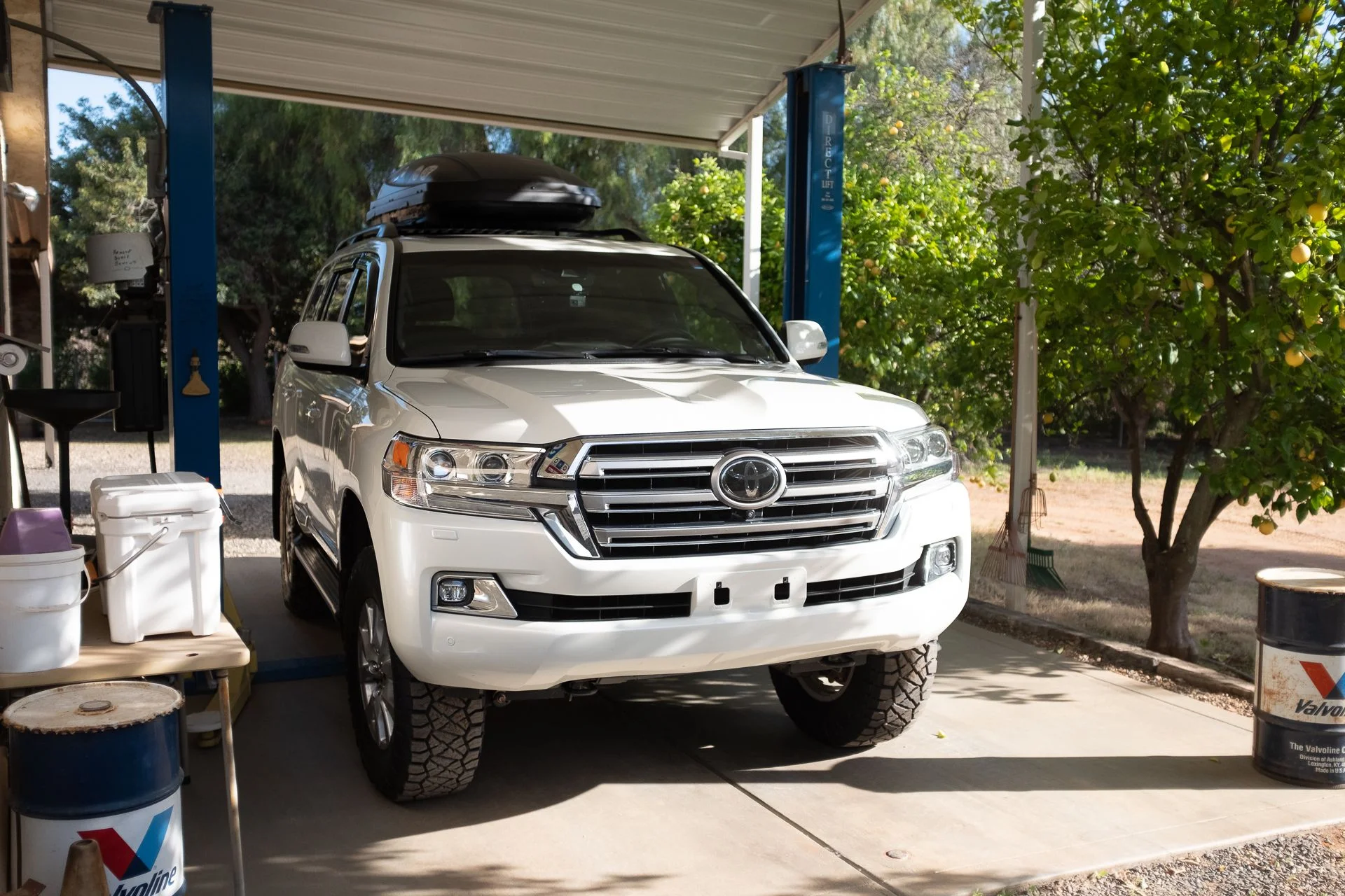

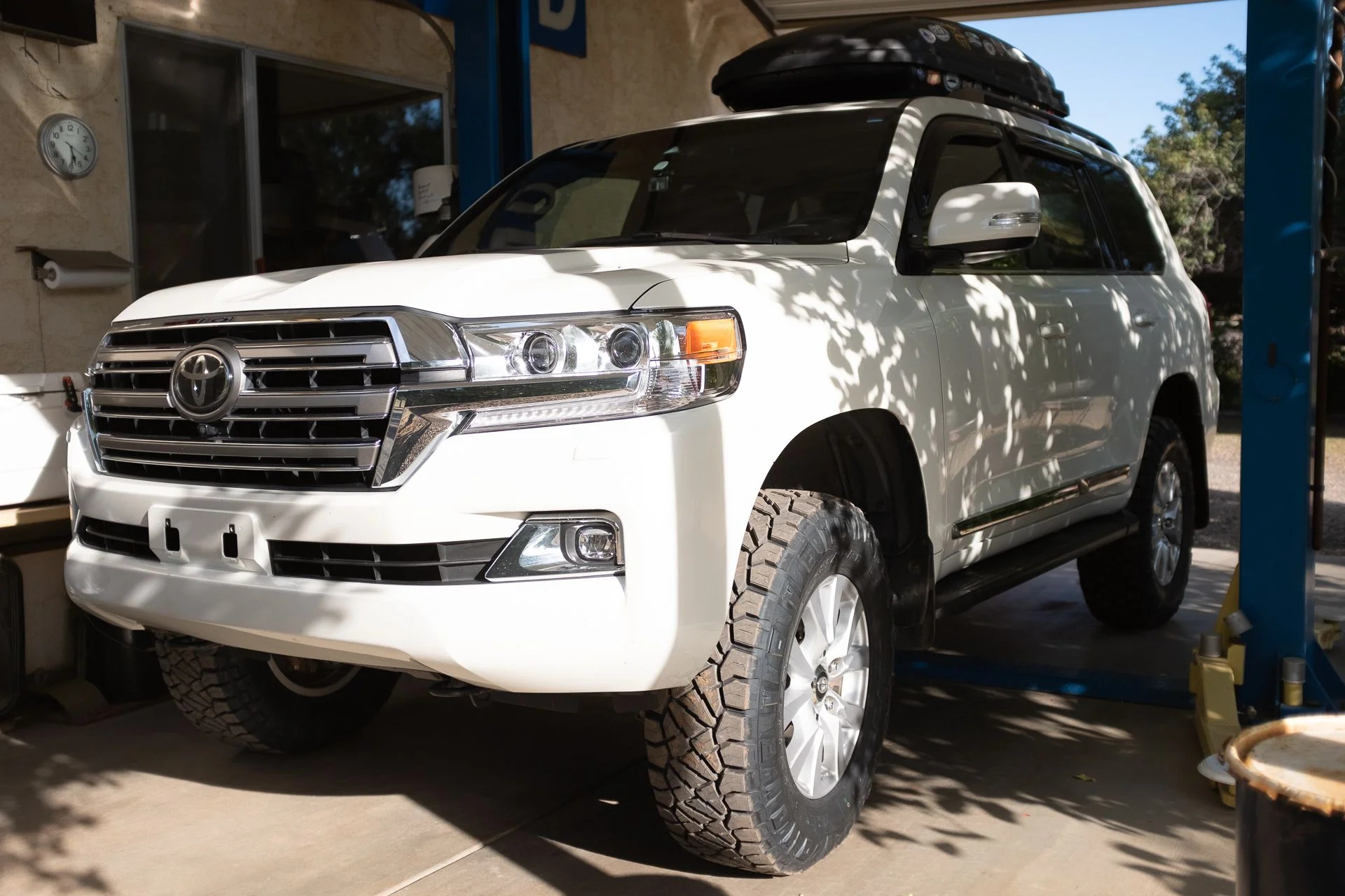

New here, sorta. Just haven't posted yet. Here's my 2018 after Icon suspension and Nitto Ridge Grapplers. I've been around the country twice already, sleep in her, have a Dometic inside, Thule on top, and I'm happy as a clam. Waiting now for my Slee sliders and Gobi rack to arrive. Oh, and some lights. So many fun things to do. I'm a bit of a originalist, so I'll probably stop about there. Not sure yet. It's like crack. LOL. I love seeing everyone's LC!
What size tires? Looks great!
i see you were able to keep your front mud flaps. Are you running UCA’s/Spacers? What sort of trimming did you do?
No spacers. No trimming, but it was the largest I could go. I do get an ever so slight rub on a full crank turn. They really do look awesome, and wide, and big. Enough for me at least.

Oh, I love information like that. I'll ask my guy at ORW about the specifics. Thank you! I'm not a mechanic, how will that affect the Icon Stage 1 2.5" lift or not?
Happy to. Several considerations.
- With a 2.5" lift, the track width narrows because the control arms are at a steeper angle.
- 33.7" diameter tires change the scrub radius geometry which can cause the steering to pull, reduce cornering traction, and steering stability. This can be fixed by using spacers to change the offset of the wheels/tires.
1" spacers would put you in a great place, increasing track width by 2" overall, and correcting suspension geometry for the larger tires. It also keeps the terrain off the side of the vehicle, by pushing the tires further out to meet the track.
