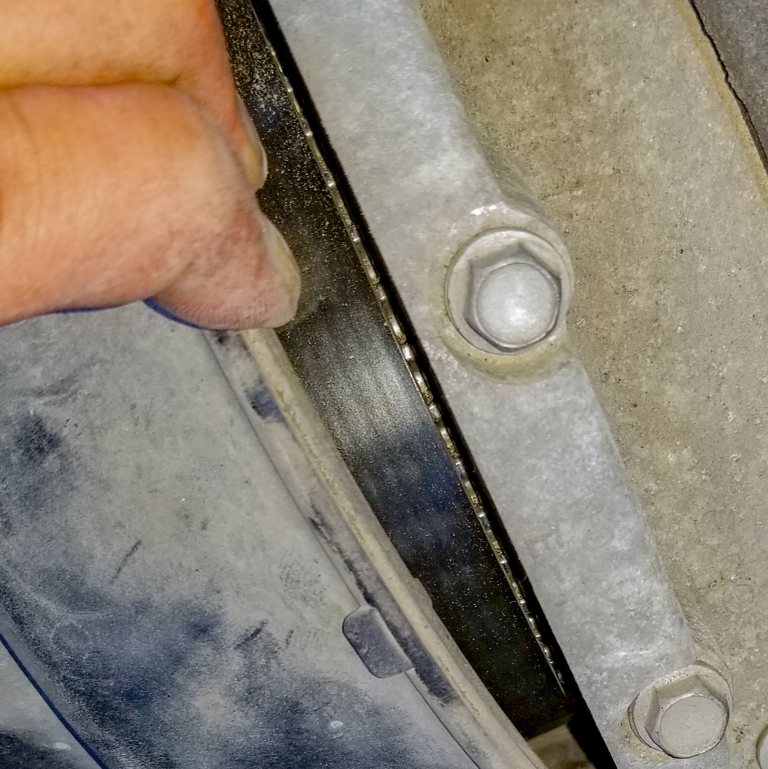

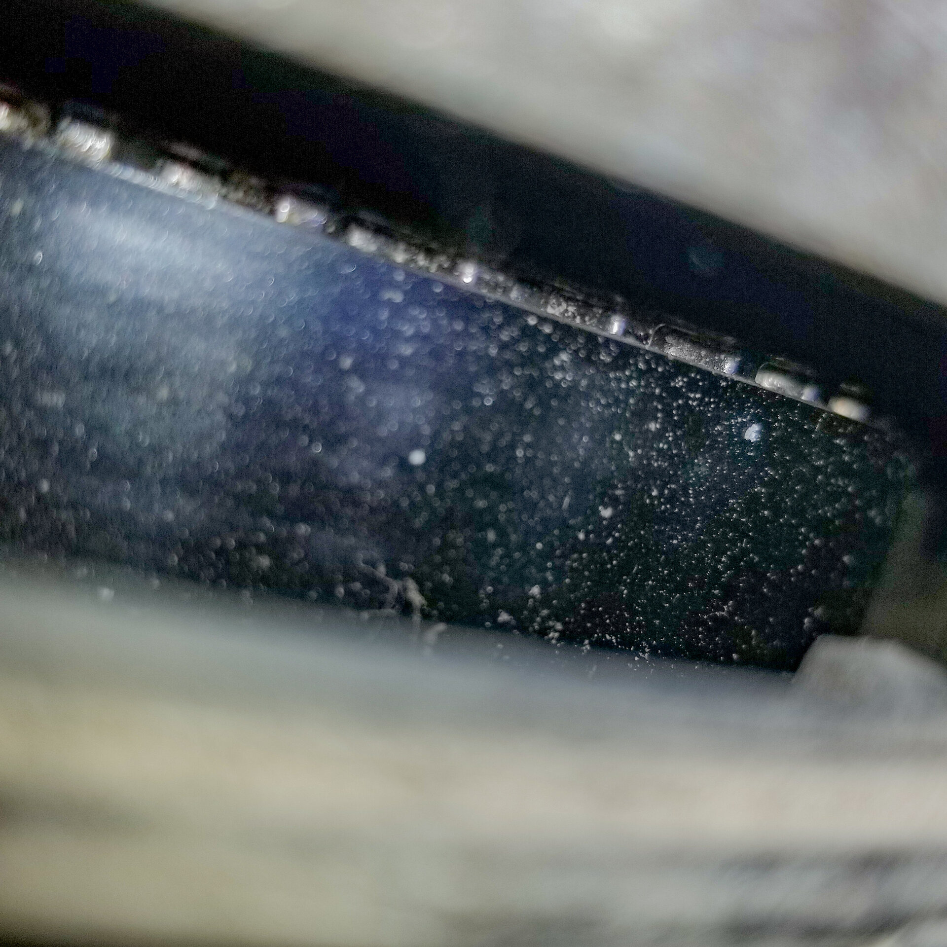

Decided to open the cover yesterday and this is how it looked.
Looks very good to me!
Very smooth, with no cracks.
Thought I share the pictures!
At 80k miles now, driving ~3k miles per year, will definitely change it at 100k mark!

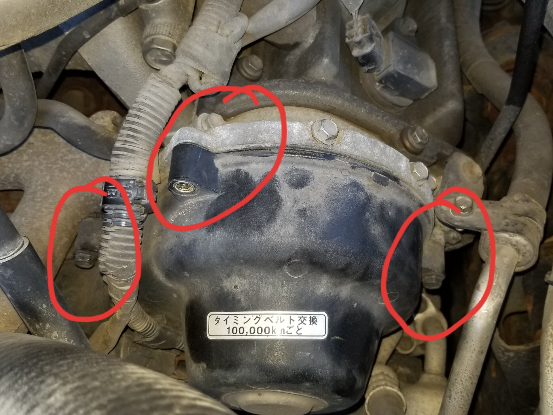

I over tourqued one of the 3 screws when I put it back and it broke inside!🙃
Thanks for sharing!
View attachment 3326960View attachment 3326962View attachment 3326963
Bummer about that screw!!! I have broken many over the years. Drill it out, retap and insert a new one. You may have to go a size larger, but there looks to be enough meat on the housing.

I appreciate your feedback.
After doing so much reading and seeing people going over 200k on the original belt, I decided at least to check how mine looked like. Based on the visuals & the fact that the water pump is not leaking, I am very comfortable now leaving it as is until 100k.
If it breaks, it breaks, this car is the least of my worries :)

I appreciate your advice, but when I change the belt I will have the mechanic take care of it, should be ok for now.
FYI, you didn’t inspect the belt correctly. You need to look at the other side, the side with teeth. You need to bend it over in your hands while looking at it on this side to inspect for cracks. That means it needs to come out.
It does look good from your pics but proceed at your own risk.

I appreciate your input, thank you! :)
Yes, I was told that, however, at this stage I should either just replace it or keep it, and I am very comfortable keeping it until 100k.

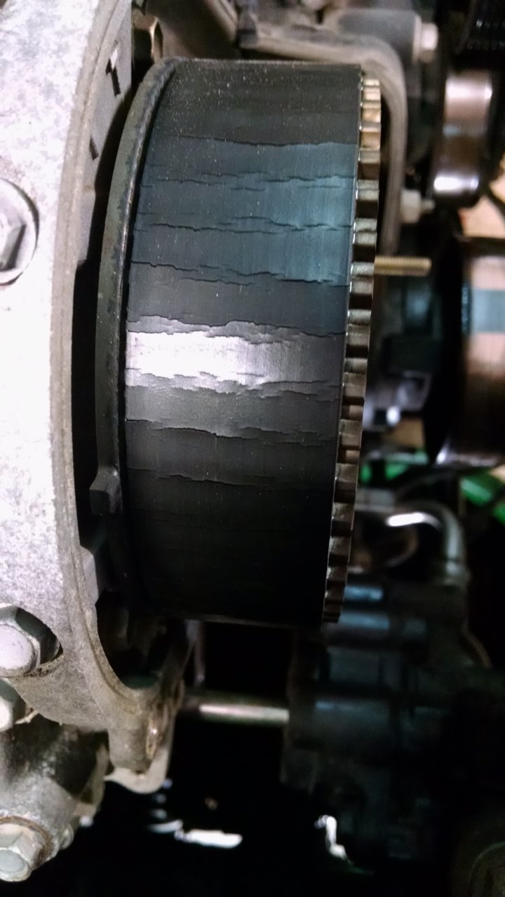

If it had 1 of the 100s cracks the belt in the pic below has I would've changed it immediately, but no cracks whatsoever.

Water pump was fine, belt looked ok but it spent the first 18 years in southeast Ohio so temperature variations even on a hourly basis can be pretty crazy year round. I just figured it was time.
I hear ya and Cruisers have surprised me more than once. I could tell stories about it but won’t here.
I personally feel an once of prevention is far better than a pound of pain. 😉
