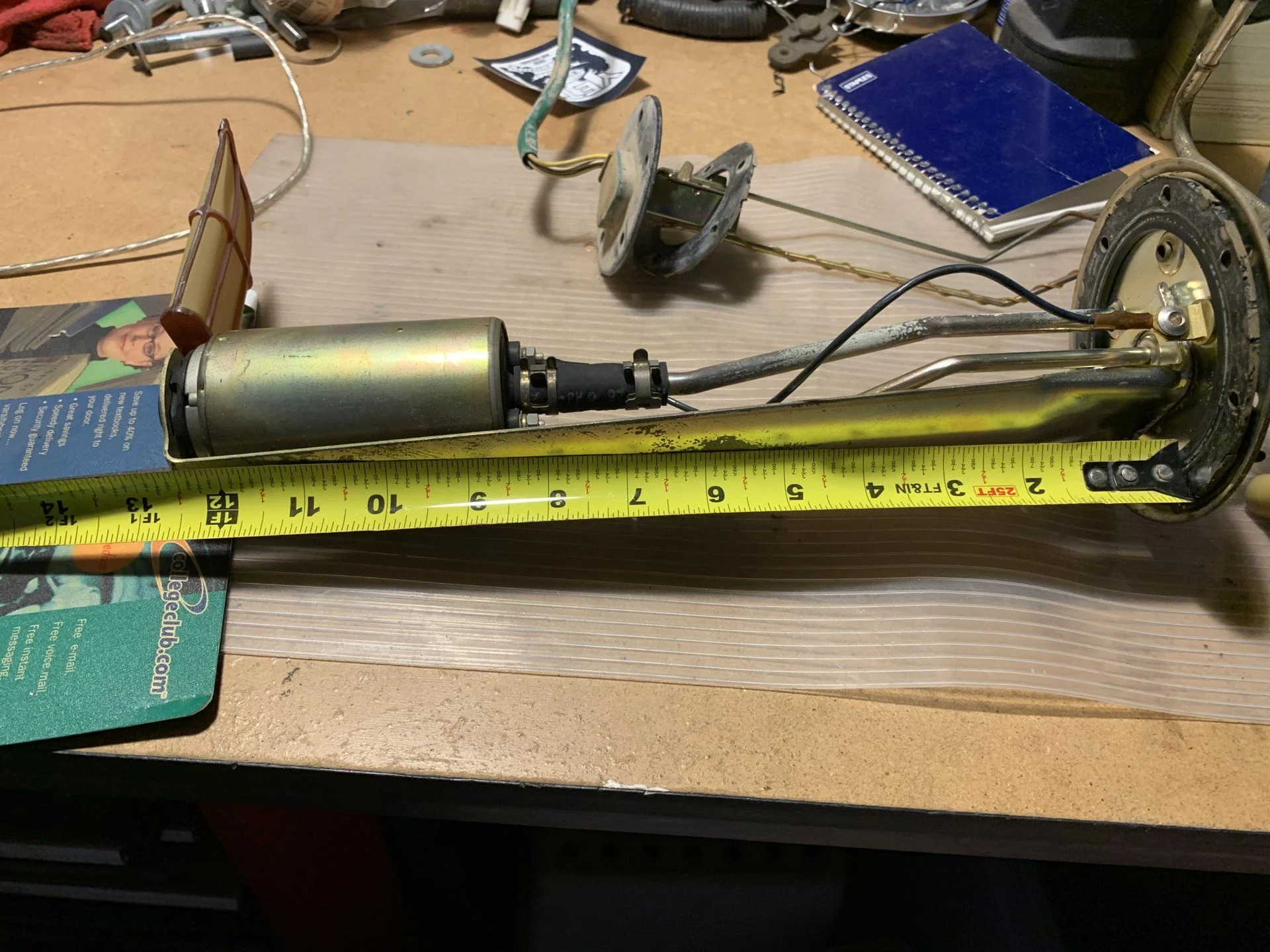

TLDR: Can people with a known 17 gallon tank or a known 14 gallon tank measure the depth of the fuel tank at the midpoint of the tank about where the fuel pump hanger/fuel inlet hose is? Fuel pump hanger depth from a known tank would work too I guess. Thanks

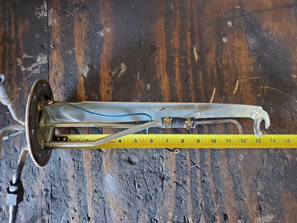

Answer: 12.75"
I literally just pulled the fuel pump bracket from a tank I believe was a 17 gallon. I ended up leaving the tank because it was missing the skid, and because it had been bashed in like mine.

Answer: 12.75"
Thanks :cheers:
I can tell you the senders are different. I've had the two side by next. Of course, I didn't take pictures.
12 3/4” it is.
I guess I already have a 17 gallon tank. Could I ask a favor to see how deep your current 17 gallon tank is? Just to confirm unless you are confident about the the tank size it came out off
Now to just figure out the fuel sender issue and why running on empty I still have 4.5 gallons in there.
