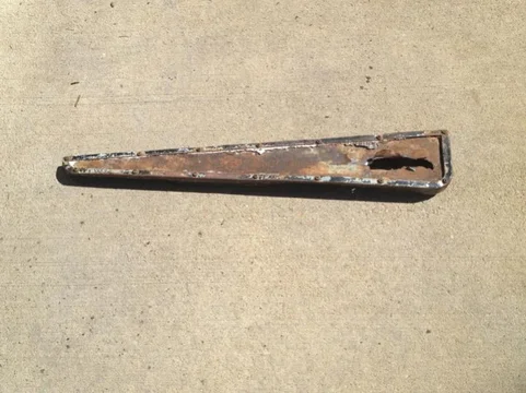

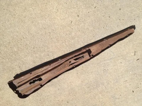

Before I start cutting and welding on the tub, I thought I should practice on something a little less expensive. The old running boards are in pretty tough shape:
I cleaned them up with the angle grinder and cup brush, then started straightening them with pliers, followed by some hammer and dolly work.
I split off the support rails underneath and cut out a big section. Made a patch to fit and tried my first attempt at welding:
Not beautiful, but I think it will work! Still have some more welding and a lot of grinding to do.
