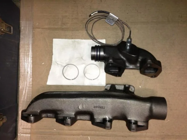

Thanks for those replies. It makes sense in the the physics sense.
Which makes me wonder about my relatively high temps now.
My sensor is installes like in the attched picture. As mentioned. my temps routinely go above 700 deg Celsius (1300 F).
I had the Head off recently for rebuilding valves and piston rings( no problems detected).
Can this be ? I checked the sensor today to make sure its reading correctly.
N/A will read high as it really needs more air to burn more efficiently and cooler.
3b's will read this high or higher as well.
Its one of the reasons a turbo is a good thing if properly installed and tuned
I can also mention that a free flowing dump pipe and exhaust can assist in removing the additional heat too.
In past projects, I have seen a 150 C temp reduction at cruise just from a 3" dump pipe.
