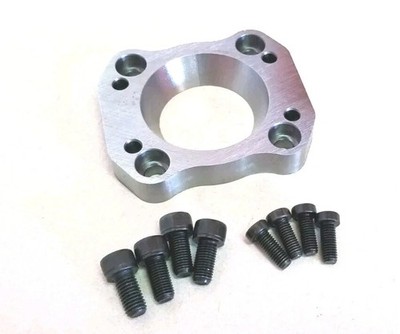

When I did a CT26 to TD04 on a 13BT I got my adapter from this eBay shop.
I used the same shop for my Holset on my BJ74. Works great. I didn’t do eBay, just called direct.
The ebay customfabshop adaptors will cost about £150 (£175 for stainless) $190/$220 with P&P to UK.
I think possible to have them fab'd locally for less.......I see there was a pdf of a CAD file for the Subaru TD04 so I might see about going this route, anyone tried ?
There do seem to be more Subaru (3-bolt) options available for the Turbo as well
Any decent fab shop would be able to do this if you have the files or info. I was going to do the same thing locally, but by the time I found a matching file, found a shop that would take it and have them set it up, it was the same or more than the shop I used.
Not to mention they may never make one so it who knows if it’s right or not. That said it’s not a hard part but saving $25-$50 may cost me $250+ if I have to re do it. The shop online sells a ton of those.
Being overseas complicates the shipping, but might be worth emailing/calling the shop to see options but I can’t imagine you will be much cheaper than $150 shipped. I think I paid $107 shipped 3 states away for an adapter he hadn’t made yet.

But seems expensive compared to DIY version......TD04 turbo 200, adaptor 150, lines, gaskets, etc 100.......total 450 ?
