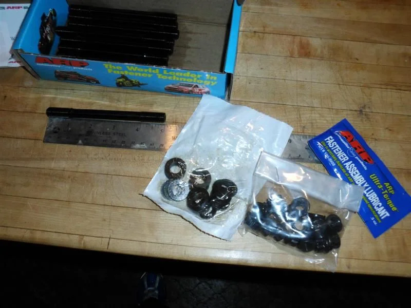

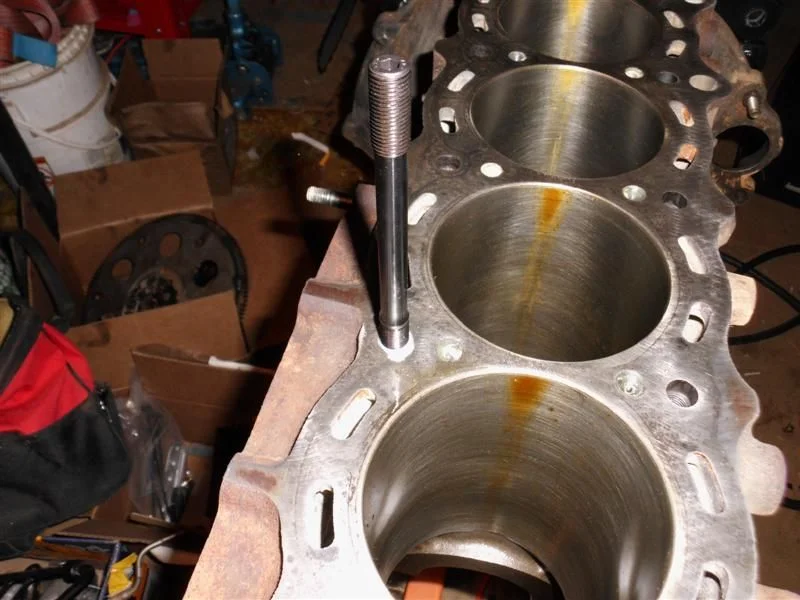

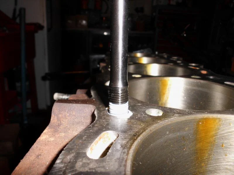

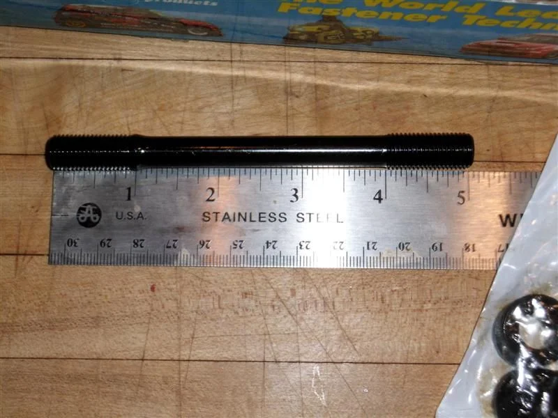

Just FYI the total price, drop shipped to my door was $229.02 for the ARP fasteners

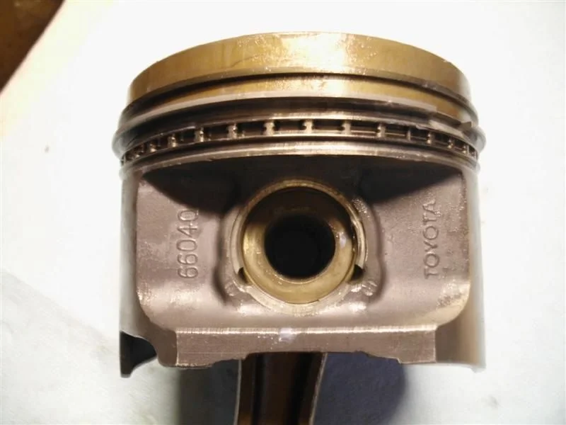

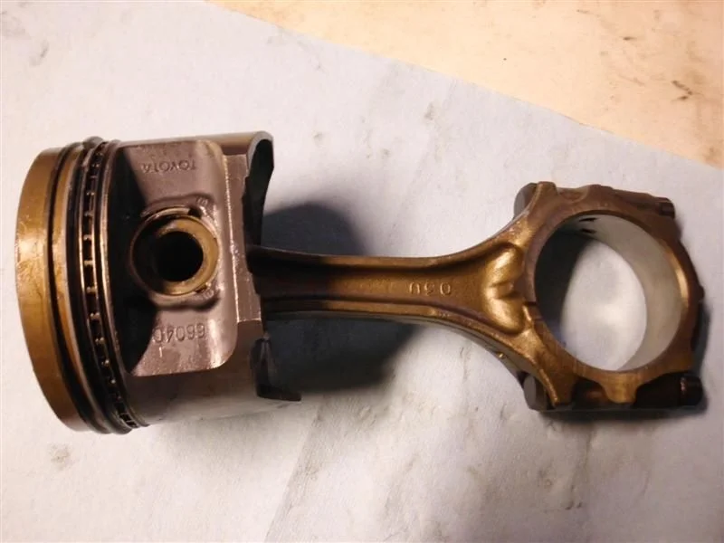

Here is a picture of the fresh piston with new rings. Kind of neat how all the rings have to be oriented.

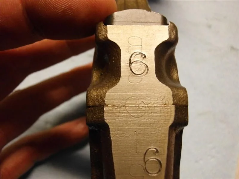

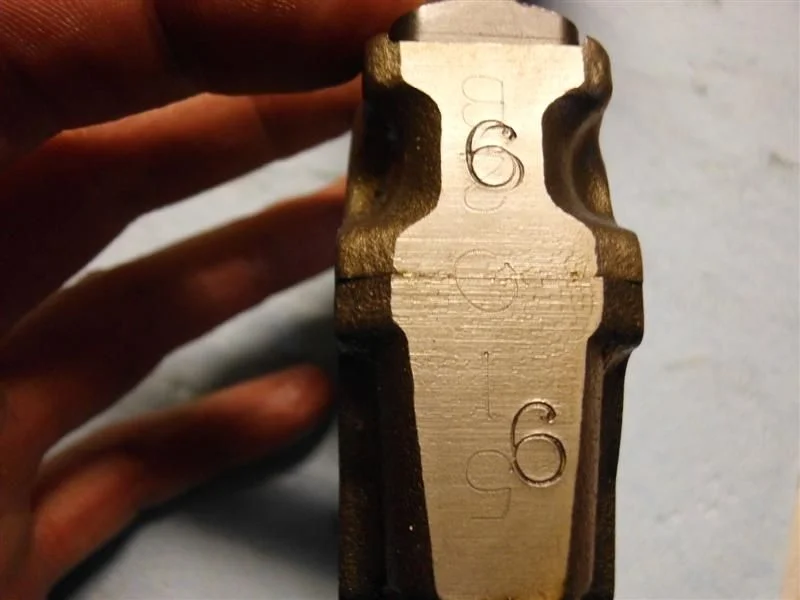

here is a picture of the numbers that are stamped on the connecting rod that help identify which bearing you will need. The heavy stamped 6 is from my machinist that did that before we realized i had to read the lightly stamped numbers. Luckily we could still read them all just fine.
