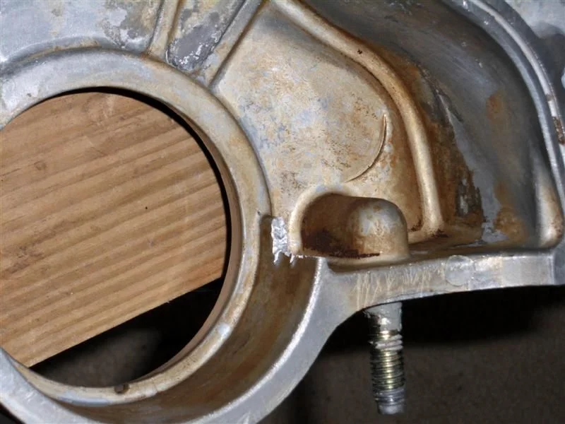

Was doing some assembly today and stumbled upon this :eek::frown:
You can see one side has a few wear marks but the other is completely broken off. What in the world could of caused this? I can only think this must have happened when i was tearing the motor down. Maybe when the timing chain dropped down as i removed the head, it could have gotten jamed down around the gear and when i removed the gears and chain and flywheel bolts i may have torqued it enough to break....
what do you think? :popcorn:
I was thinking about just smoothing it down and moving on. Also i'm going to inspect other parts in this area for damage. Maybe i need to add a new timing chain to the parts order list? :o
I would sand it down and move on.
I would do the chain and also the slipper and tensioner. You'll kick yourself if you don't and if you want it to run for another million miles, it's good insurance !
Rgds...
Rgds...
DANG!! Yep, tensioner is what i forgot to order!! Shoot, guess i'll do that and throw in a chain with it as well.

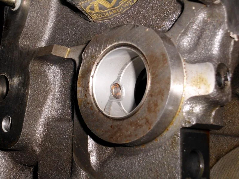

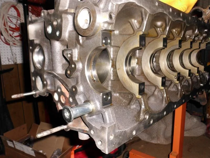

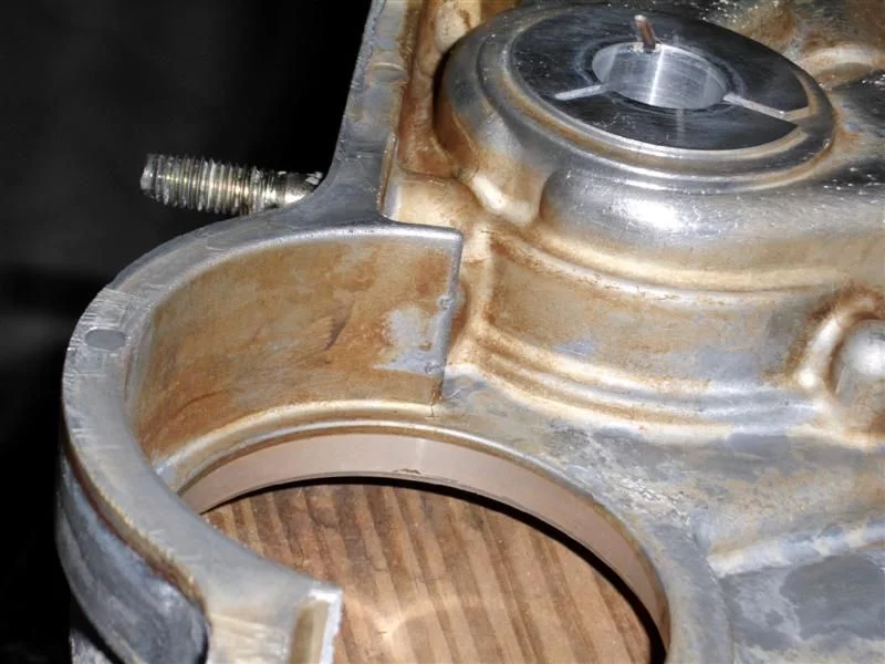

Has anyone noticed the oil feed and the oil pump bushing and perhaps maybe the bushing may have spun just a little? Or do you think that is stock? Hard to get a picture.

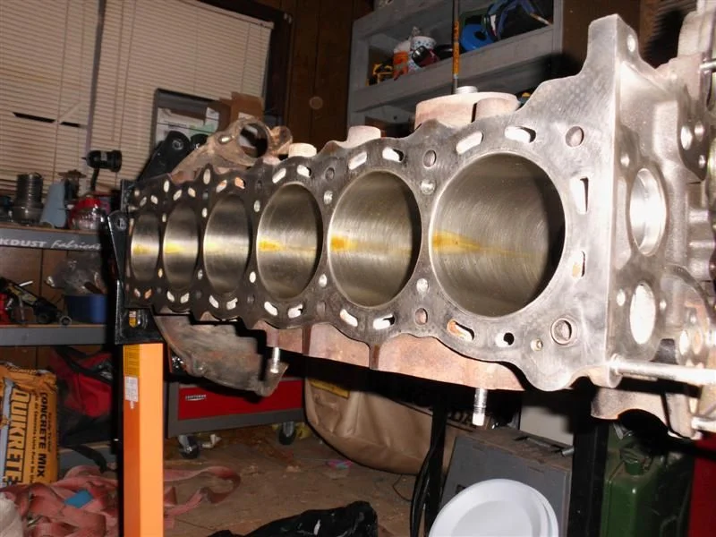

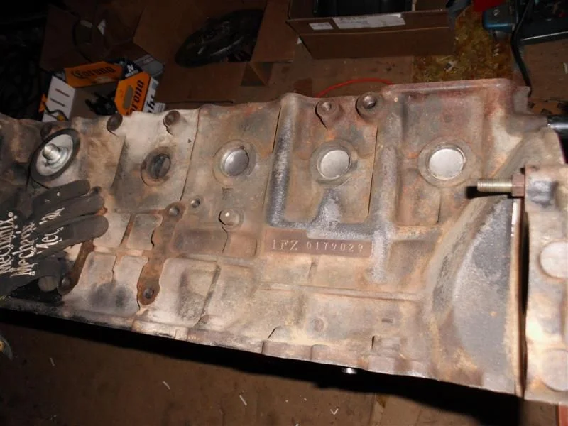

Also, i warned the guy and i guess i scared him. When i picked everything up, i was happy except the block was relatively dirty on the exterior. The cylinder walls and everything that was machined looked great. He said he was so worried about that oil pump bushing that he didn't dip it and he said he doesn't bake. He said just spray it out and air it out good before re-assembly, but i'm hesitant. Is it OK to take it back and have him dip it? It will take forever with a wire wheel! Plus i'm worried about the residue in the cooling jackets and oil passages! :eek:
Suggestions?
Suggestions?
If it was me, and I've kinda been in your situation, I would try find someone who can/would dip it and knows about the bushing.
I can't imagine going so far and spending that much money and not feeling 1000% satisfied about the block/oil passages & galleys etc. I'm not sure I could sleep at night if I didn't do it !
But then again, so many others have said I went 'way overboard' so I'm probably not a good barometer !
Rgds...
attachment.php
it looks like it could be positioned a little better for aligning to the journal.
I do see some where at the 12:00 o'clock position as orientated in the pick. That is from the helicut gears.
I would put the drive gear in there as check the play in that bushing. I also posted up a few picks of a bushing I replaced and you might compare what your's looks like to that one.
I had a tool made for pulling that bushing and also installing it. If you want to dip the block I can send you the tool so you can pull the bushing and reuse it.
I just may do that! I saw where BJowett rigged up a series of nuts, washers and a bolt to pull it out.
I just want to do it right.
How/where did you get a new bushing?
I will try to get some better pictures up.
Rgds...

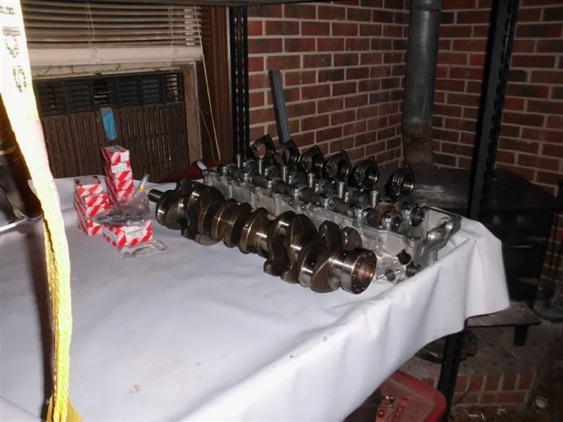

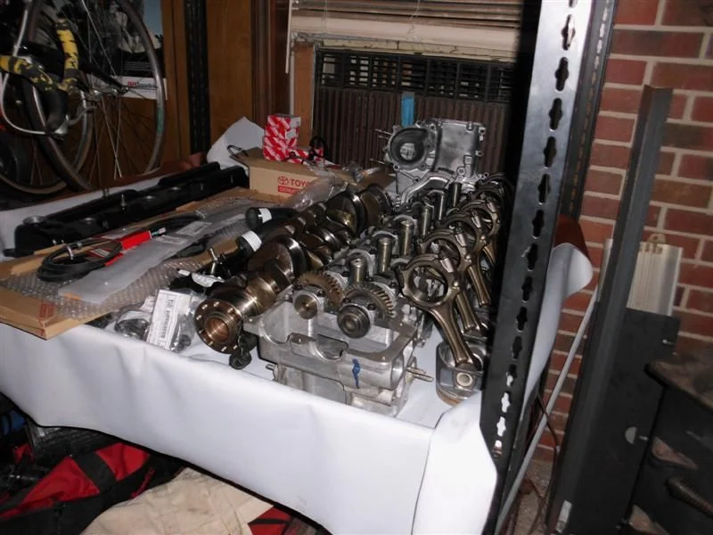

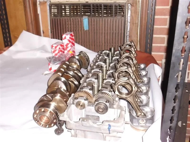

no i agree. that's why i have not began reassembly. Everything is ready. While i'm putting the motor together the intakes were being dipped and bead blasted. Also, the oil bung for the turbo is being shipped and should be here either tomorrow or monday to weld onto the pan. And, the ARP head studs should be here either tomorrow or monday. That's really it, everything else is ready.
