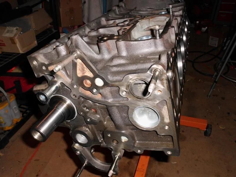

Made some pretty good progress today. Stopping for dinner and then will finish up after.
Cleaned the block out real well with air and brake cleaner. Got some FIPG and more shop rags and some block paint.
Got everything cleaned up and ready to go.
Then pressed in two new oil seals.
Installed the main bearings making sure to double check my math.
Installed the crank and main bearing caps. It is a little intimidating to torque the main bearing caps down to 54 ft/lbs, mark them and then turn them an additional 90 degrees.

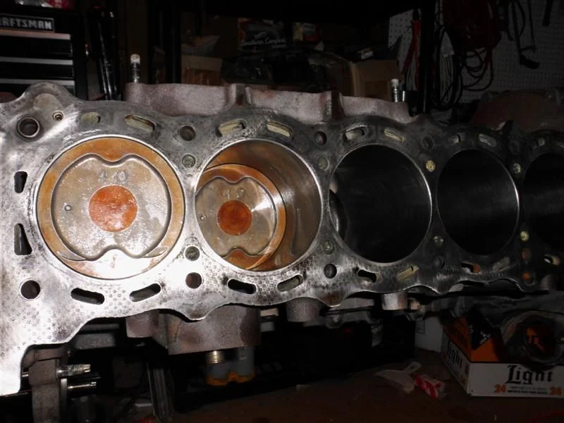

Then i installed the pistons and connecting rods. ONly got two done before stopping to eat!

stayed up until about 1:00am getting all the pistons in and everything torqued.
I have attached a few pictures showing that on both the main bearing caps and the connecting rod bearing caps, you torque each down to a specified torque (IIRC main's to 54 ft/lbs and rod caps to 34 ft/lbs) and then mark the bolt and torque an additional 90 degrees.
The connecting rod caps have a nice mark in the bolt head that you can use to measure your 90 degree turn very easily and accurately.
It is very important that as you insert the piston/rod into the cylinder head, you do not let the rod or the bolts touch the cylinder wall or the connecting rod counter balance. I was able to do this by having an extra set of hands, plus as i was tapping the piston in i had the motor turned sideways so i could reach my left hand up and into the bore and could guide the rod accurately into a good seat on the crank.

Showing the motor turned on it's side so i could "bear hug" with tapping in the piston with my right hand and guiding the rod with my left hand. :cool:

Where's all the beer cans?
lol...

Had my friend come by who knows his stuff so we could push further in the rebuild and as soon as he got here he insisted that we pull a piston and check the ring gap. He said he has been thinking about that since he left the last time. I'm glad we did!
Pulled the #1 piston out and found that the ring gap was perfect, BUT, i had not cleaned the ring groove out on the piston and the assembly lube had started letting the carbon ooze out of the ring groove. SO, i ended up pulling every piston back out, cleaning all the ring grooves, reorienting the rings, putting the pistons back in and retorquing the bearing caps.
So now i'm exactly where i was, but now i KNOW it's right.
Lesson learned is take your time and don't skip any steps. As i looked back in the FSM it does say to clean the groove which i did not.
