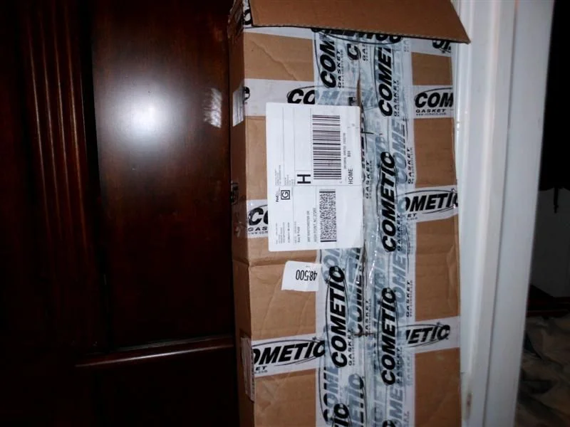

to conitue the madness..... this came in the mail today! :grinpimp:
This should be going on this Saturday. I think i'm done ordering parts for crying out loud... talk about a money pit! :hillbilly:
Except for the block heater... i'm done ordering parts.... for real this time. :rolleyes:

Got your power steering pump yet ???? :D Sparkplugs?
Dunno how many last pieces I ordered. Looking good though and that is a seriously beef HG.
Glad to see you got the HG.
The Cometic HG sure is a work of art and it's a shame it's hidden.
And as for buying parts, like you, I can't believe how much I've spent to ensure things are done properly. The OEM parts I got were the biggest contributor to budget blowout, glad I'm not alone HAHA!!!
Yes, thanks. Luise at paradiseracing was really great to work with! He said he is going to jump on this board and see if he can supply some parts to us cruiserheads.
