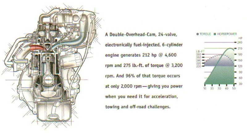

I'm not a master at this, but if you look at the torque curve of the 1FZ motor. The torque peaks at around 3000 rpm, maybe that is why you've not feeling that "uumph" on higher rpms. It just the way the motor is designed maybe? Plus, the cruisers are really heavy.
untitled-jpg.204645
I would fight this argument and say that the torque curve is pretty flat from 2000 to 4000 RPM. Note that HP keeps gaining all the way up to just past 4000 as well. This is because torque and HP ARE related (HP = torque x RPM / 5252). As long as the engine is creating constant torque, it should be creating more and more power (HP) as its RPM increase. I am not seeing this...I am feeling almost a flat HP response after 2500-3000 RPM, which tells me the torque curve for me is falling there and the power output is not increasing with the RPMs.
