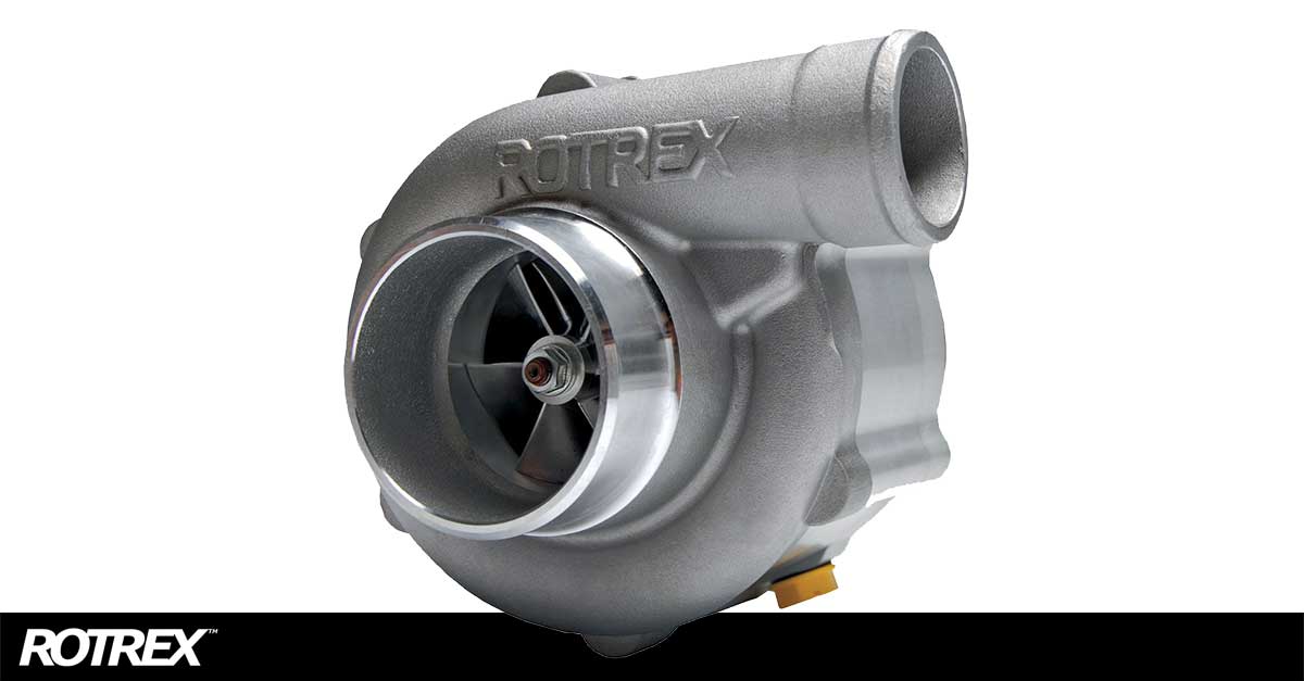

Have you ever heard of Rotrax superchargers? I learned about them fro the UAE website. I think that is what I would try if I was going for a boost.
This style supercharger is used quite a bit in Australia in various cars because they are easier to fit under the hood
