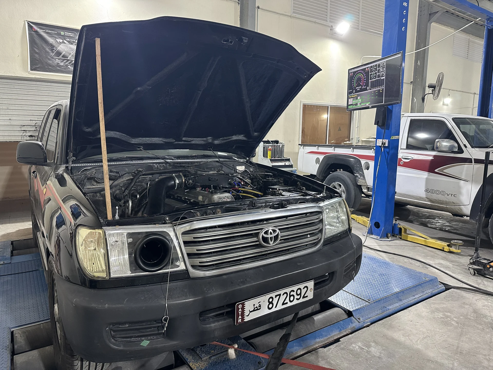

Hello everyone, just thought Id share the results of my new 1FZ-FE Stroker build. 583 Foot pounds of TORQUE on pump gas TO THE WHEELS!

Engine Power Characteristics & First Impressions:
Amazing torque down low, peaks at 3500 RPM, even the part throttle acceleration feels much more potent, the power dies off after 5500 RPM due to the small cam, not enough duration to allow it to breath! Which is why I set the rev limit to 5700 RPM (ignition cut on limit). My goal is to get it to rev to 7500+
Although in terms of street use, the setup as is is perfect, it has a tone of power down low which is to be expected with this much displacement divided into 6 cylinders even with the wide cam LSA. Especially since that displacement is largely the result of the stroke. The air intake scoop is obviously not suitable for daily use, and especially not for off-roading, the only thing filtering at this point is the oil filter...

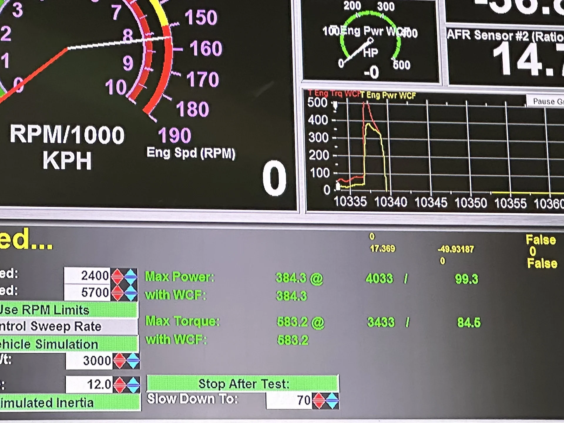

Something doesn't seem right. I've been watching a lot of dyno videos lately which has given me a basic idea of expected dyno results. 1fzfe motors with a fairly decent amount of boost don't put out that much power from what I've seen anyway. You are making 5.9 cummins turbo diesel power with a naturally aspirated petrol I6 according to those numbers. Some shops will purposely have a dyno adjusted to give exaggerated numbers to draw in more business or just dont have it dialed in well. Either way it seems your happy with it and it runs well which is all that matters in the end.
Something doesn't seem right. I've been watching a lot of dyno videos lately which has given me a basic idea of expected dyno results. 1fzfe motors with a fairly decent amount of boost don't put out that much power from what I've seen anyway. You are making 5.9 cummins turbo diesel power with a naturally aspirated petrol I6 according to those numbers. Some shops will purposely have a dyno adjusted to give exaggerated numbers to draw in more business or just dont have it dialed in well. Either way it seems you’re happy with it and it runs well which is all that matters in the end.
I totally see where you are coming from, I have seen posts here with boosted 1FZs making 190-250whp. It does seem ridiculous for an NA motor to make that much relative to all that.
Although in terms of the Dyno being adjusted to give exaggerated numbers, no I don’t think so. Since this Dyno is not associated with the workshop that built my 1FZ, what would be the intent? It is a known Dyno and I have not heard anything like that from people around me.
I actually ensured the Dyno was calibrated by inserting proper parameters before hand such as the right tire size (circumference), curb weight, gearing.
I also did the run in fourth gear to ensure a 1:1 ratio.

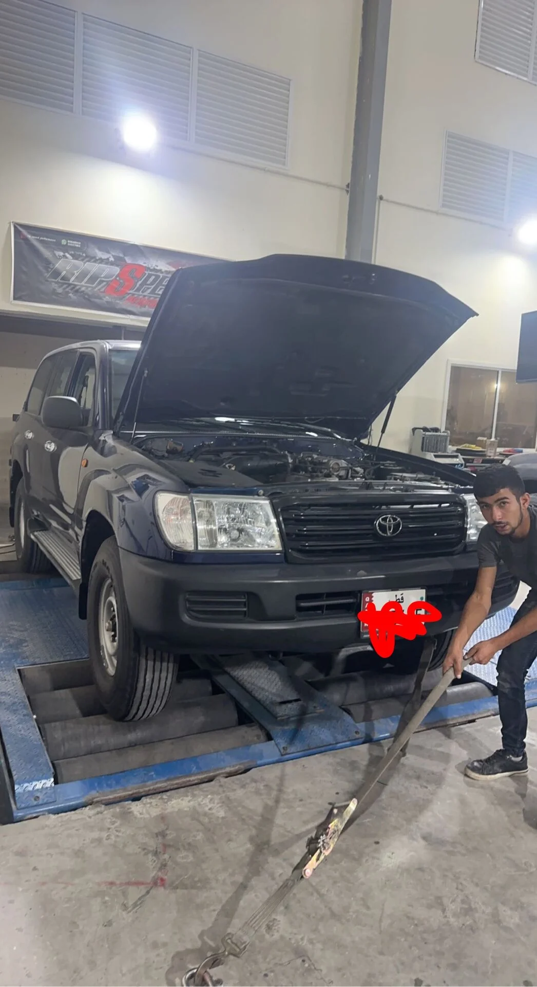

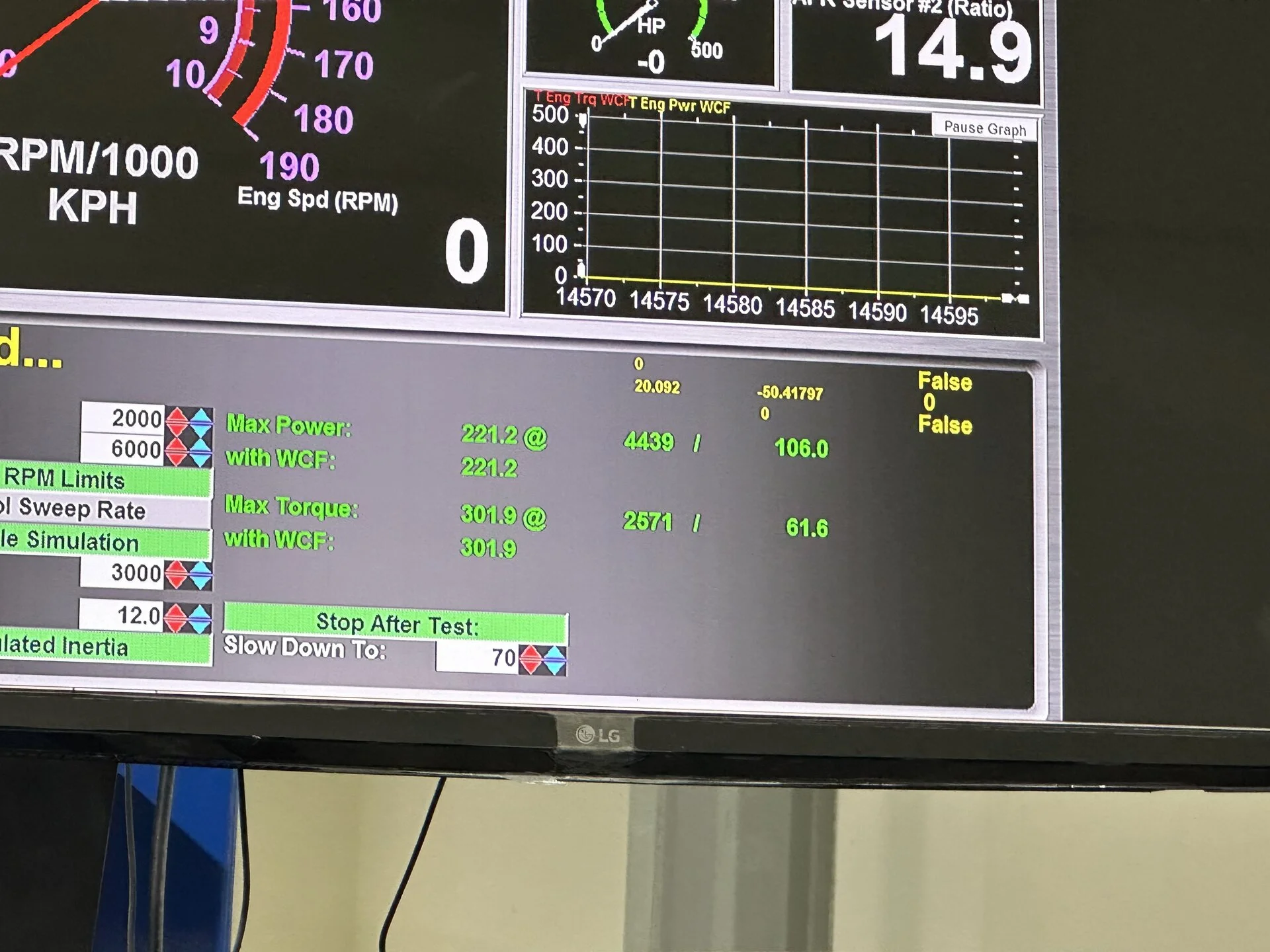

On top of that I used this Dyno a while back to test another gen 2 1FZ-FE, that engine was bone stock on the inside however it was freshly rebuilt with .50mm overbore pistons. It had a 3.5 cold air intake and a full 3 inch exhaust with 6-1 headers and the same ECU that I am running right now the EMTRON SL6. It got 220whp to the wheels which was no surprise, 220whp from a full exhaust, intake, stand-alone ECU only 215-225whp is the expected result with those mods here with bone stock internals. Not to mention that this test was done with 34 inch off road tires(I am a ware of the exact drivetrain loses with bigger heavier tires are but I am sure they are relevant)
It is also worth mentioning:
This stroker build was Dynoned and currently is running 30.5 inch road tires with Lexus 16 inch wheels.
Current tire weight: 13.5 kg - 29 lbs
Current wheel weight: 6.5 kg - 14.3lbs
I’ll also do a 0-60 and quarter mile test to see if those numbers match the current power and torque output in some way.
Here is the test results on the same Dyno of my other 1FZ Land Cruiser that I just mentioned.

Look forward to more feedback as you get some time with the truck. I do agree the dyno readings seem a touch high but you have so many modifications and such a different setup than we had here. I don’t think anyone can really compare apples to apples. Unless someone ran a bone stock Gen I 1FZ on the same dyno.
And the math does work out for that to be ft/lbs of torque not Nm. Hp=(torque*rpm)/5250. The torque peak at 3433 =381hp. And then a couple hundred RPM later you have your hp peak of 384. So it’s not like some of the Aussie dynos that are off by a factor of 2, because they are only picking up RPM signal from 1 of the 2 wasted spark leads
