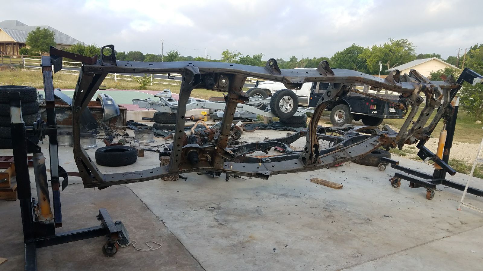

1998 TLC UZJ100 frame off resto build log
There is something oddly satisfying seeing bare clean steel :)

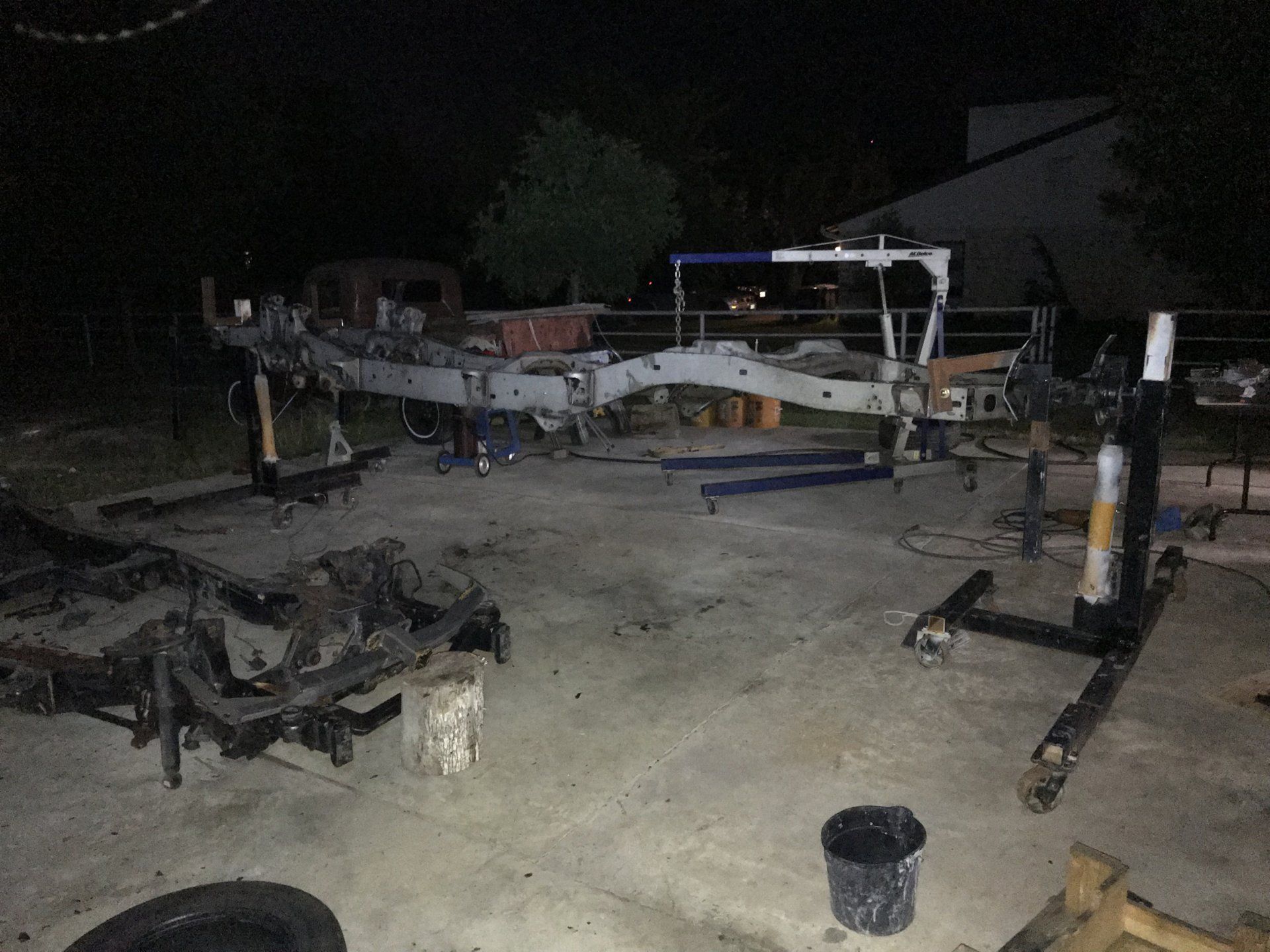

Today we hit the bubbled paint left from the aircraft stripper with the power washer.
Finally found some time to repair the rotisserie and mount the frame
Next is to degrease the bare steel frame, wipe it down with phosphoric acid and a scotchbrite pad, rinse and dry.

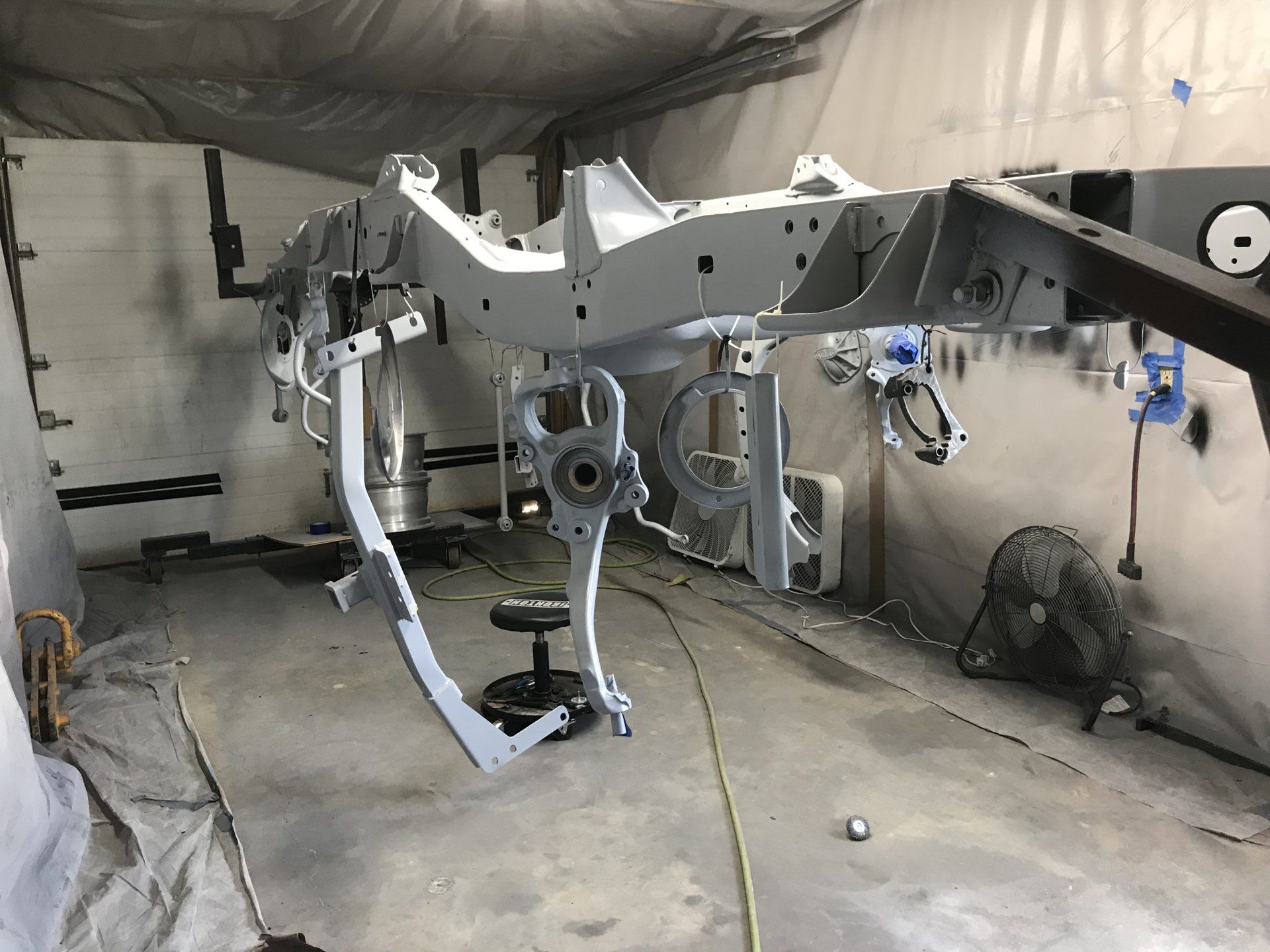

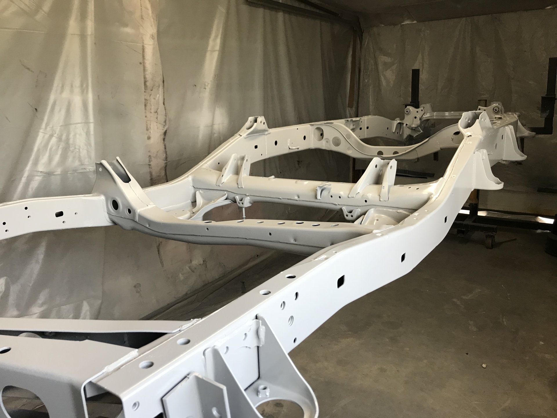

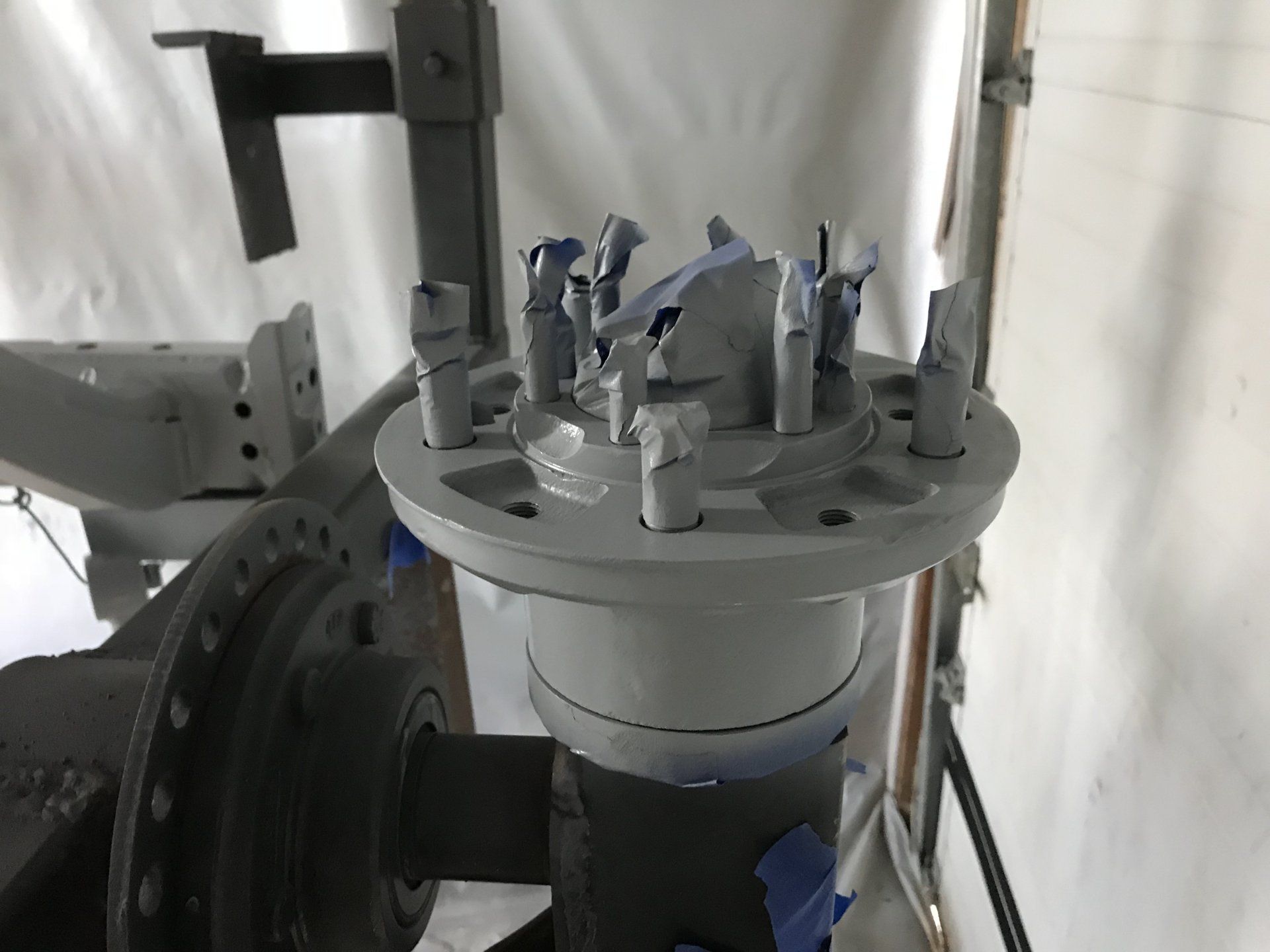

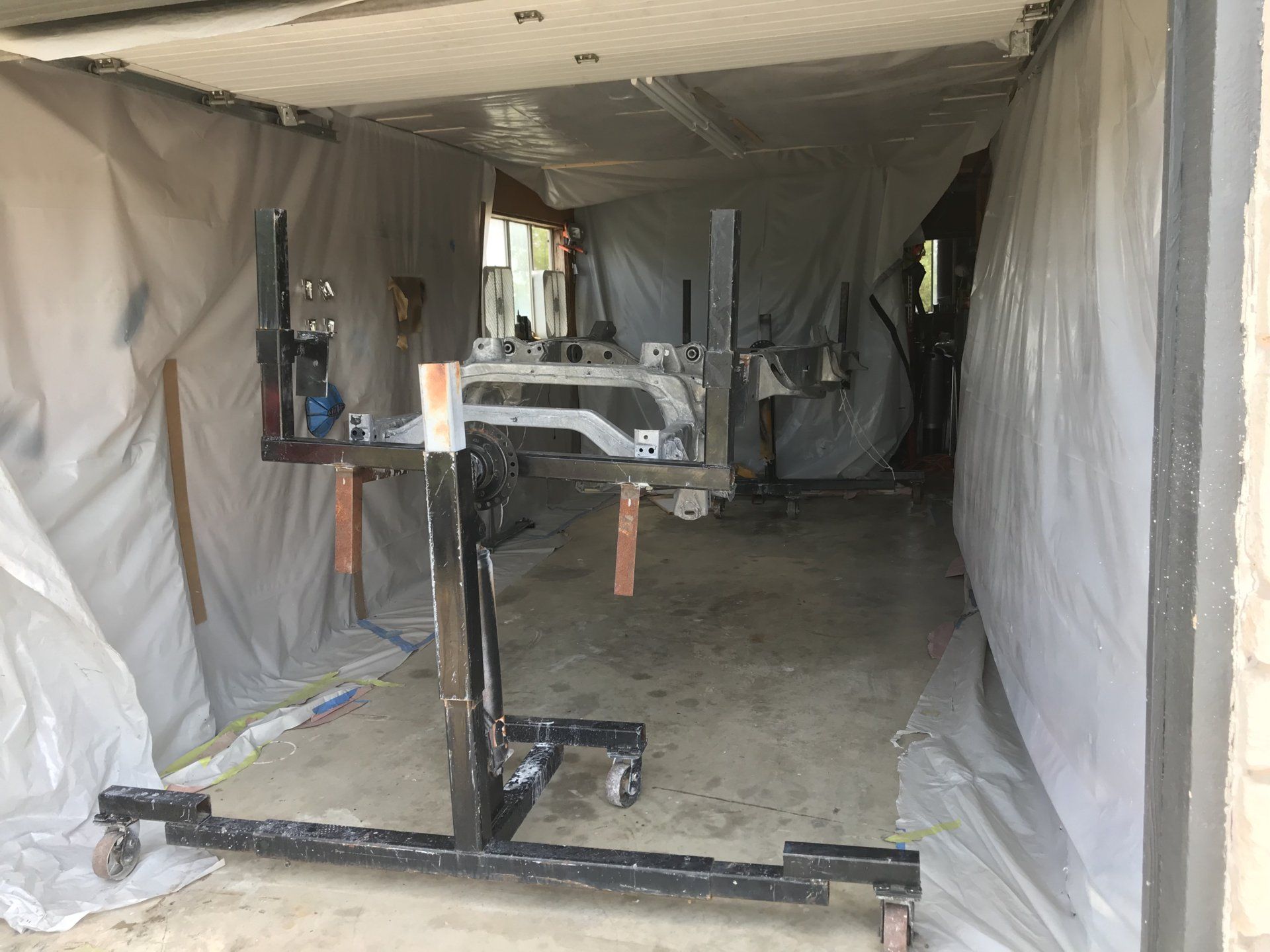

First coat of epoxy primer is done :)
There is always something I forget. Notice pic with missing exhaust hanger. Will metal prep that before laying down second coat of primer.
Second coat of primer will be grey so I can tell where I sprayed. (tomorrow)
Then two top coats of DTM chassis black. (Hopefully tomorrow)

Sprayed the second coat of epoxy primer this morning. BTW the brand is Lusid Northstar EP210B resin with EX355 catalyst and S065 fast reducer (SDS says its Acetone). Brock over at Lusid was really helpful giving me tech support. This is the first time I’ve used their product but the guys at Fox Automotive in Georgetown, Texas says it works well.
According to the epoxy manufacturer (Lusid.biz) I have 48 hours to spray before having to re-scuf the finish.

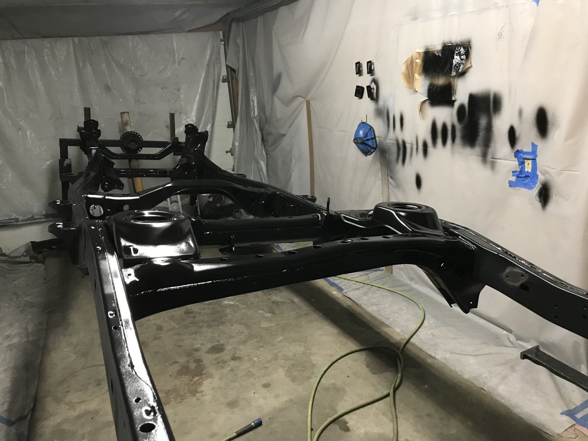

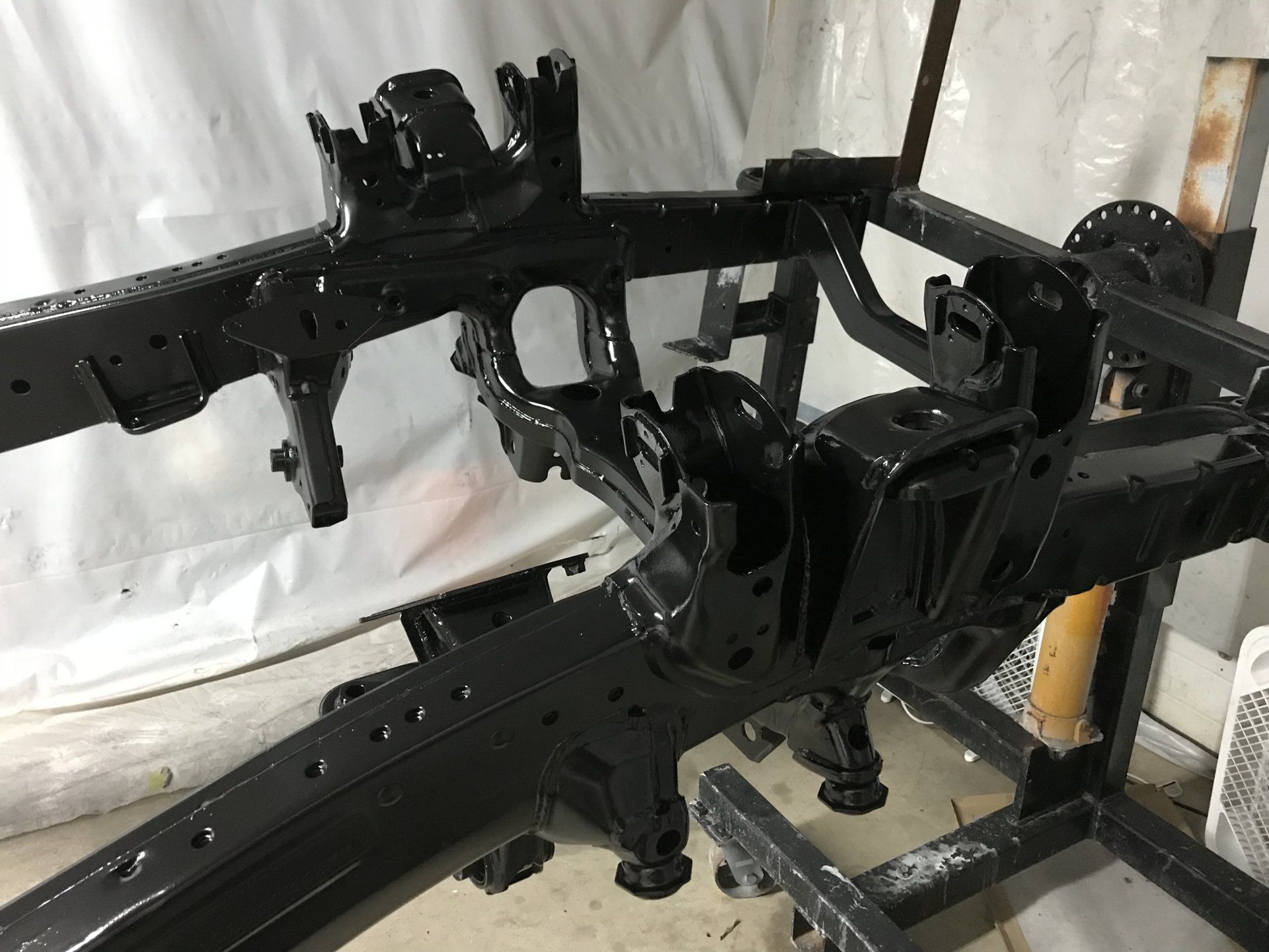

I’ve decided to put a coat of semi gloss POR Top coat chassis black which I already have a 1.5 gallons in the shop. It’s not Por-15, it’s their oil based enamel.
The second top coat will be their gloss black POR chassis black. If I’m going to get this thing muddy I want it to come off easily.
Any objections to a glossy chassis? Please tell me now if so. Thx

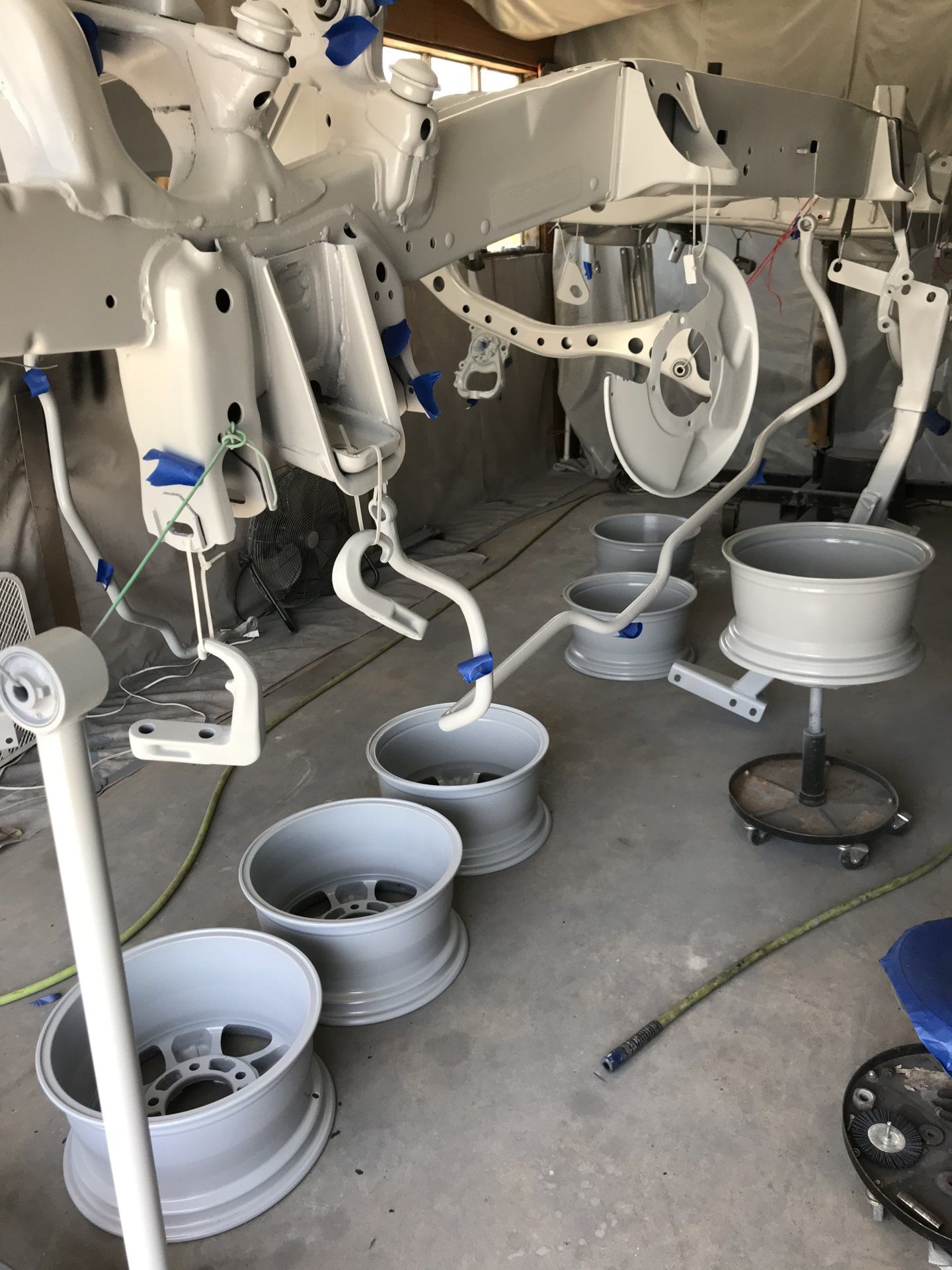

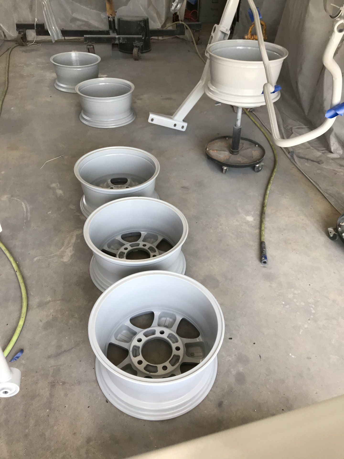

Did get up at 5:30 this morning, metal prepped a bunch of braces, steering knuckles, brake shields, sway bars, pull points, control arms
, and 6x factory wheels (2 spares). Thanks to Patrick, who sanded all six wheels while i metal and paint prepped all steel parts.
Put a coat of epoxy primer on everything except the wheels.
Tomorrow, We are planning on finishing some more epoxy on odd spots and the wheels.
