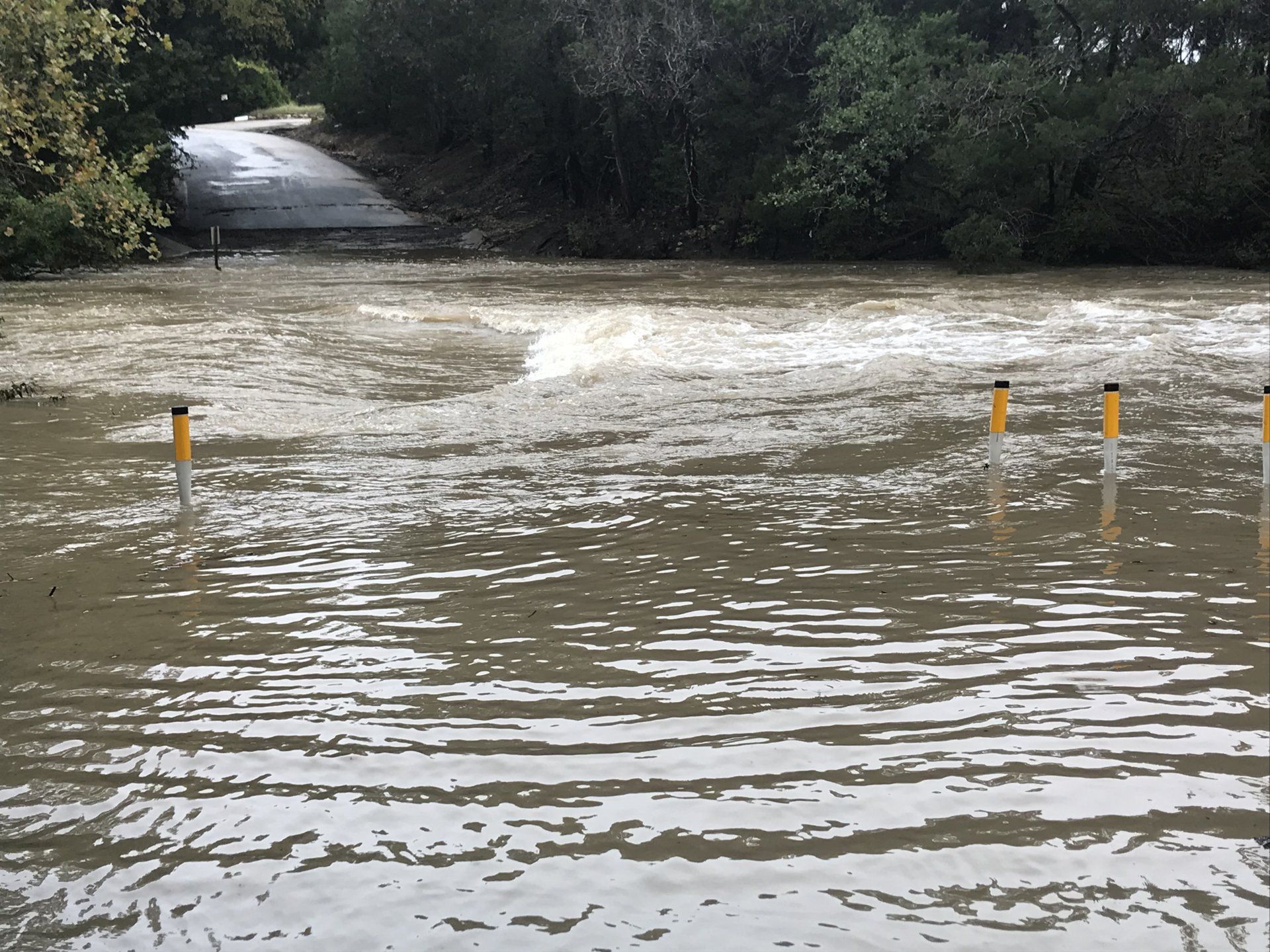

Here is a photo I took an hour after the bus floated away. Btw...the water is 2 feet to the concrete bridge and there is another 2 fellow that point to the creek bottom there are no guide rails and the bridge is single lane.

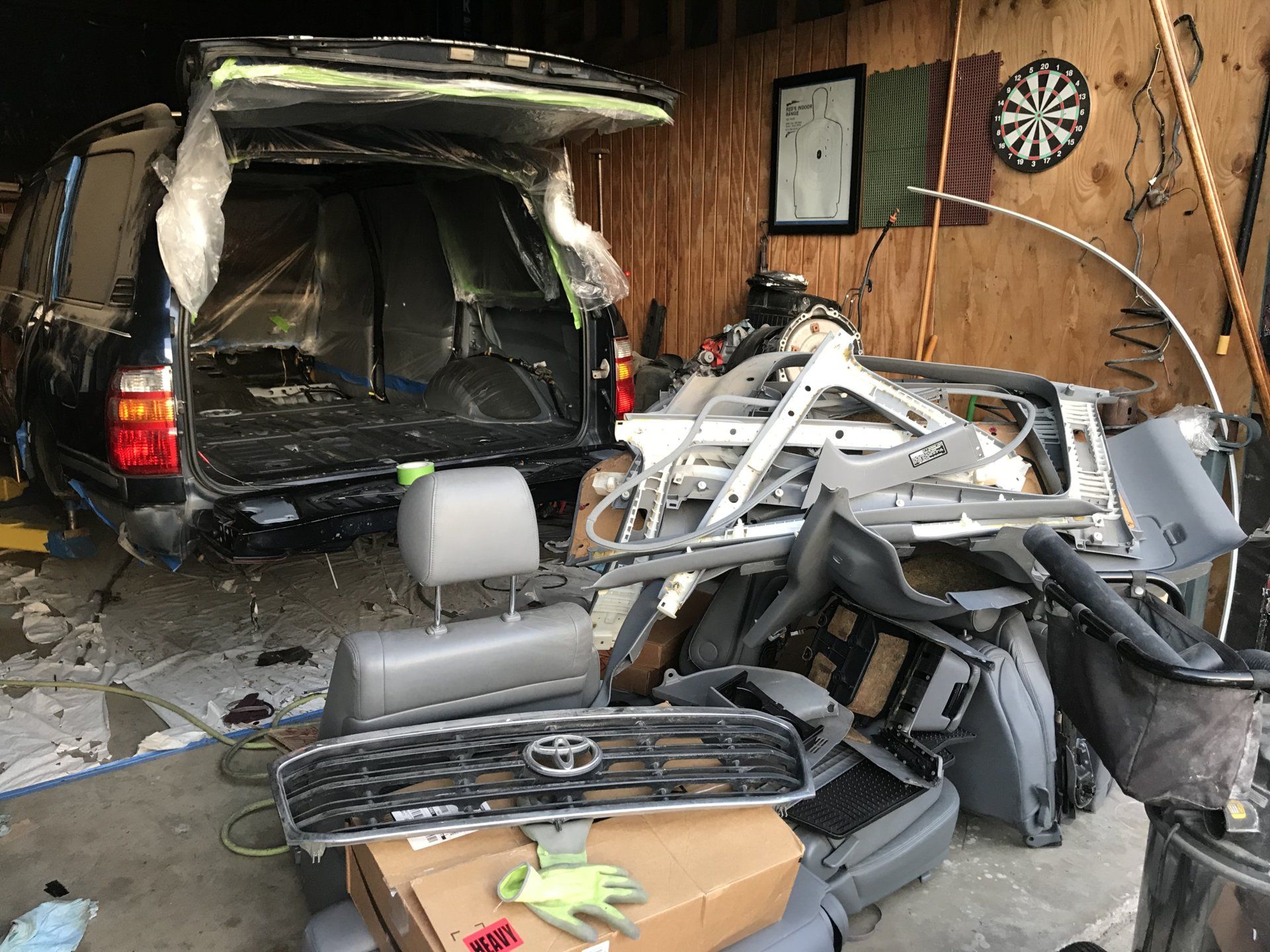

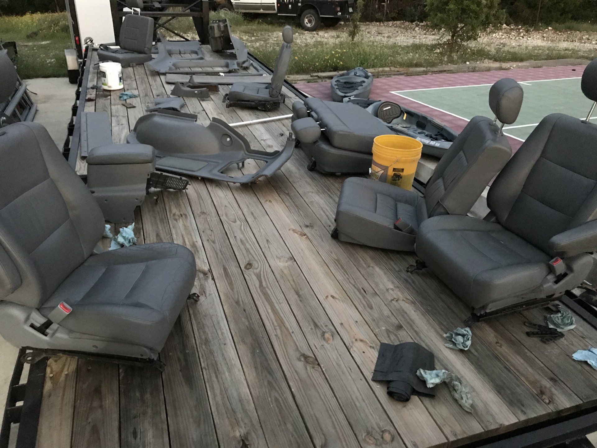

Looking at swapping the frame in my 100. How complicated was getting the body off the frame? Do you have pictures?
Not hard at all. Taking the thing apart is the easy part. Putting it back together is a whole other story yet to be written. Stay tuned :)

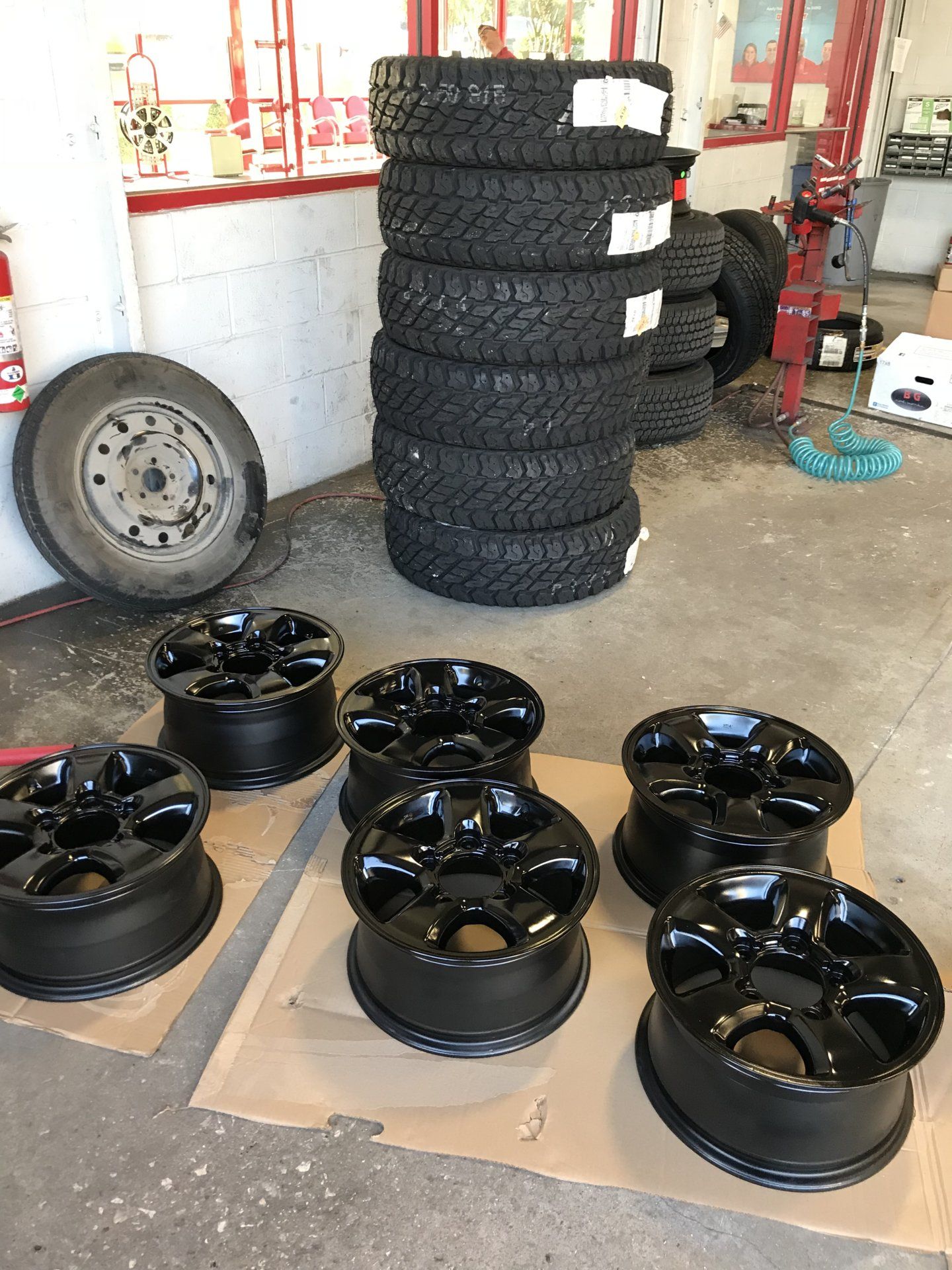

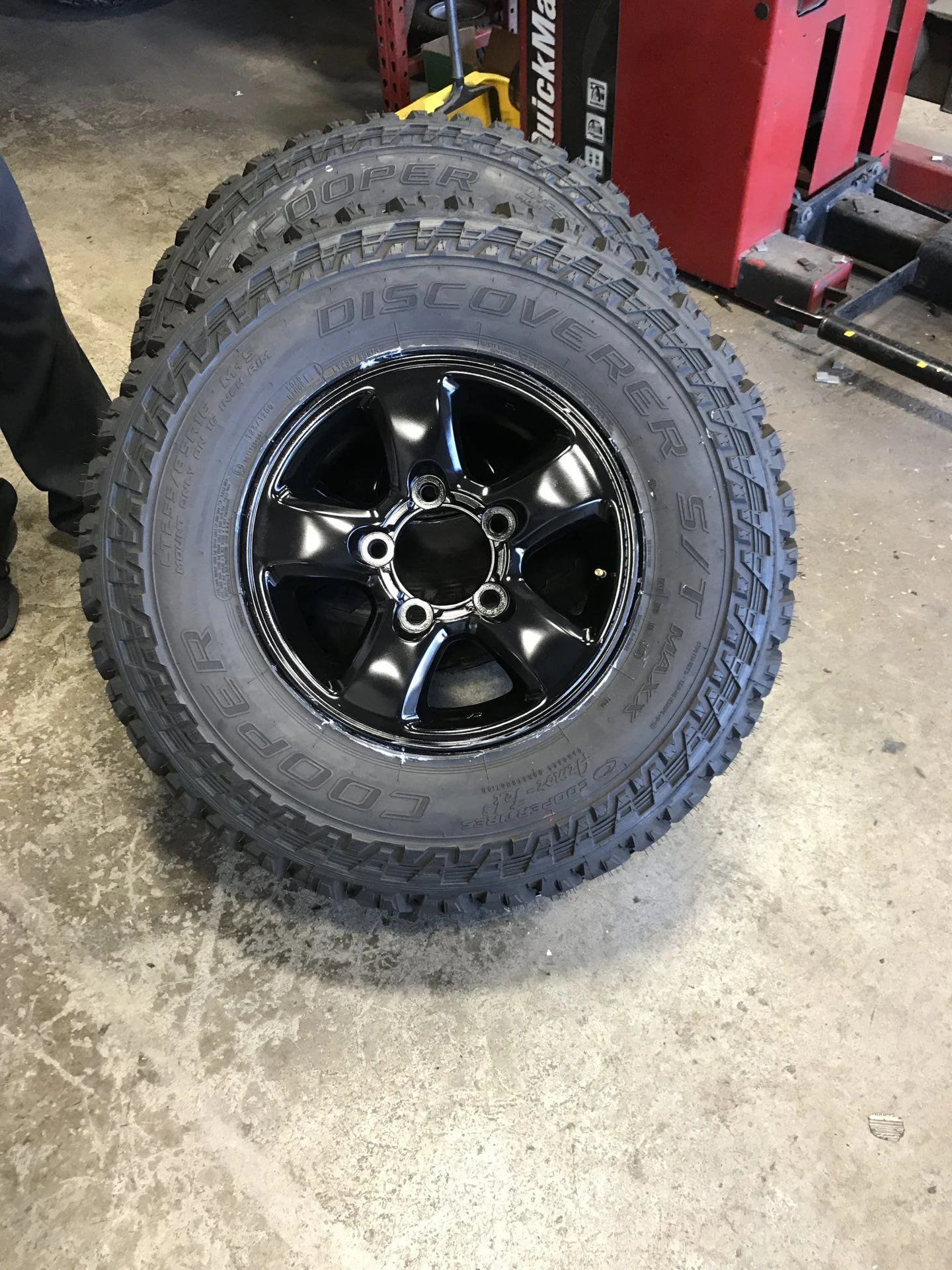

The rims came out very nice. Do you mind me asking what it costs for powder coat?
I didn’t have them powder coated. They are painted with epoxy primer and a top coat of 2K semi-gloss ceramic chassis black. I wanted a way to touch up trail scratches. Powder coat won’t let me do that.

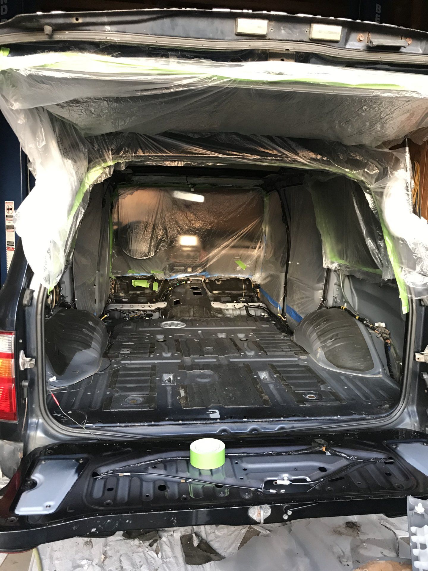

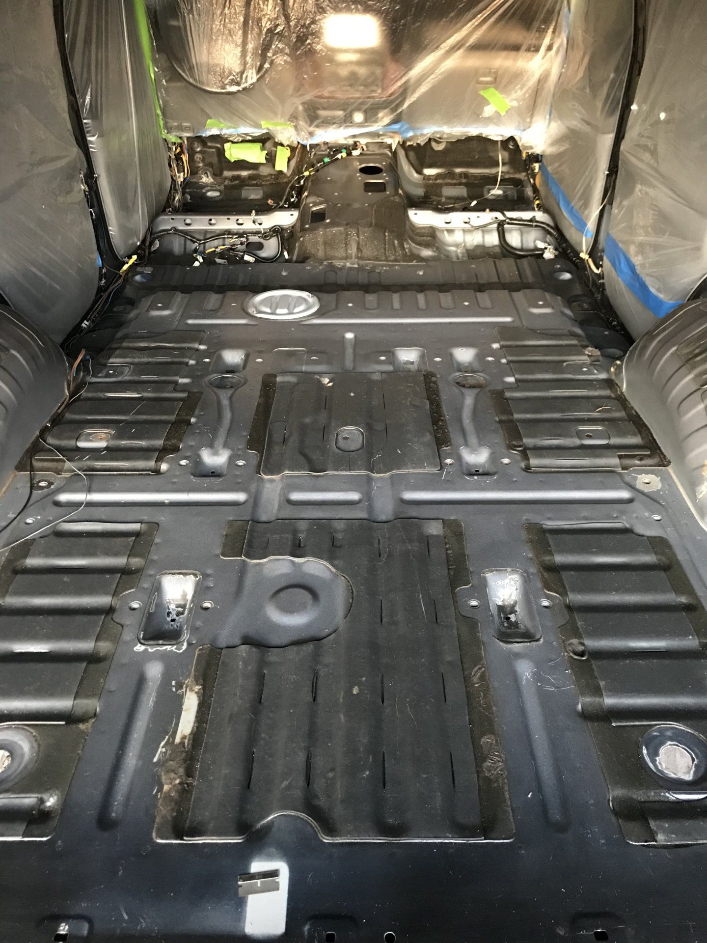

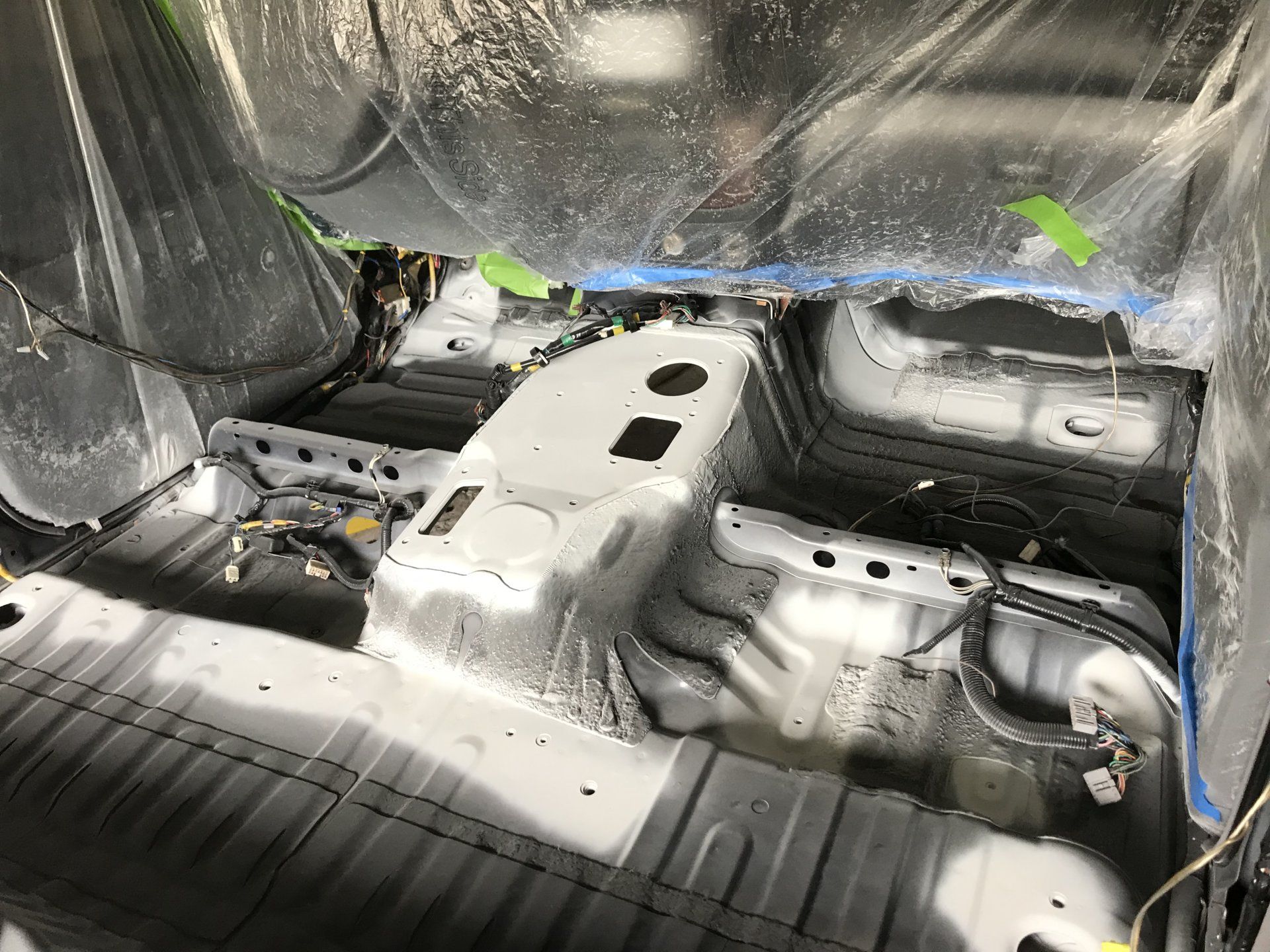

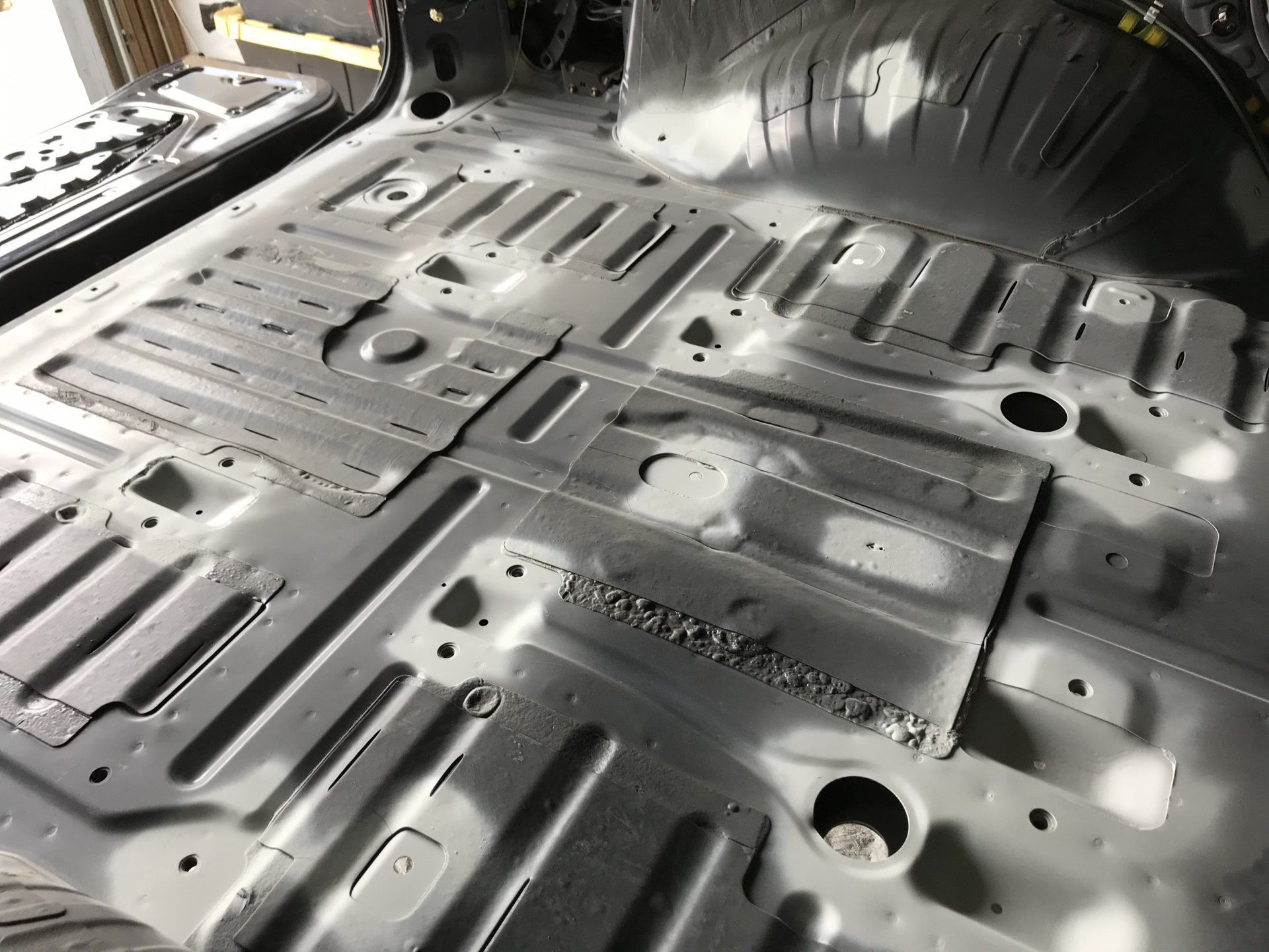

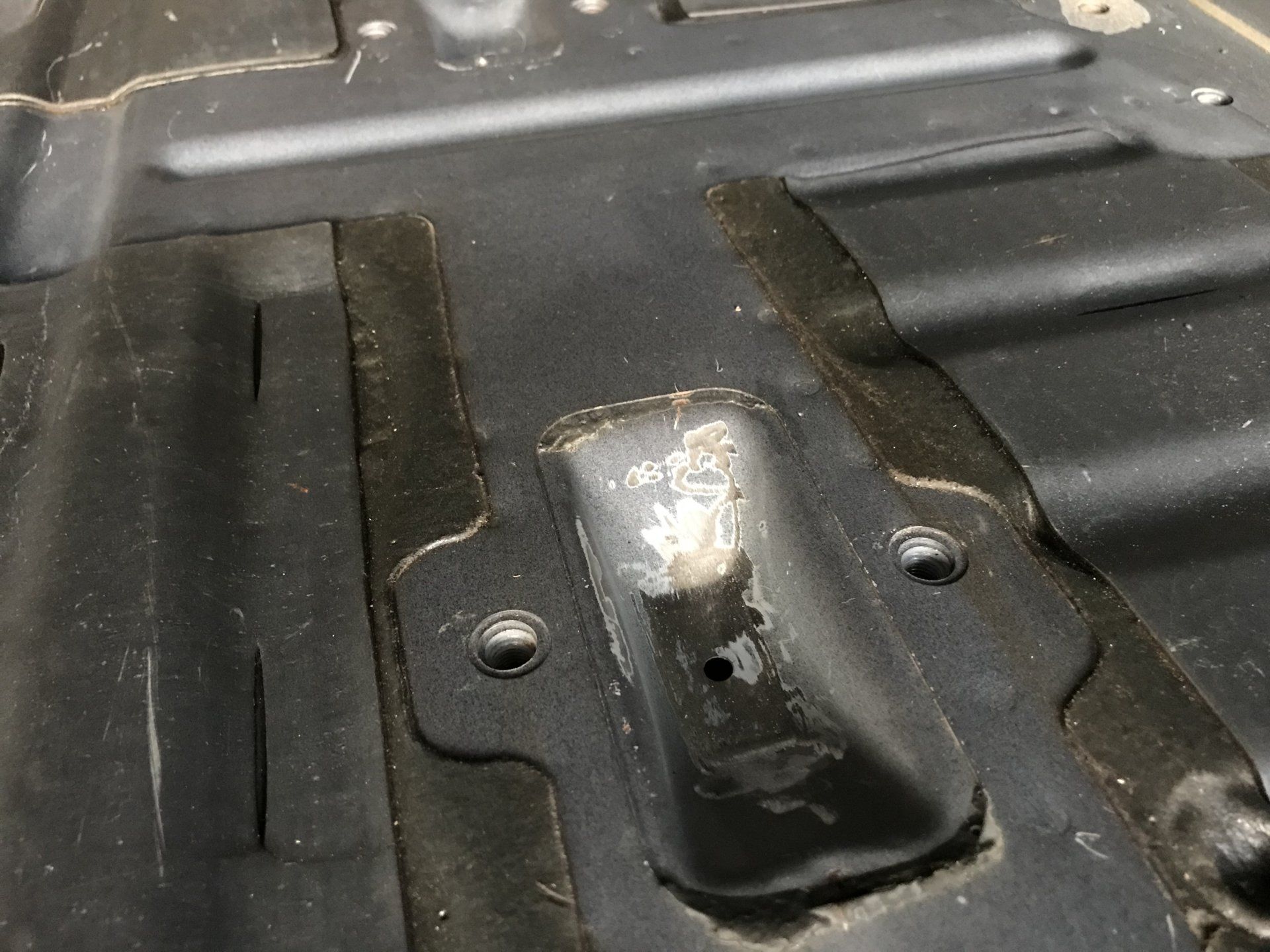

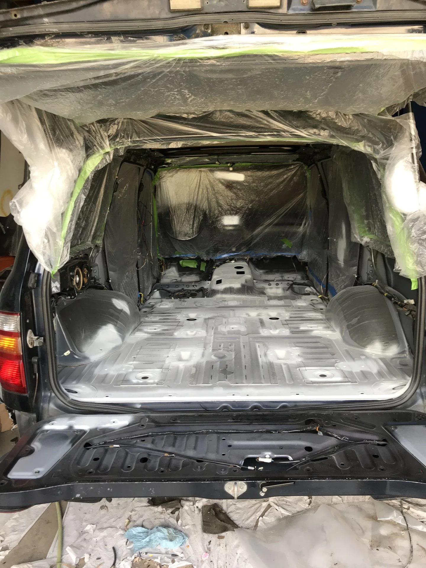

Took some time away from the office today. Prepped the metal subfloor in the cabin and sprayed it with epoxy primer.
Then sprayed all the hard-to-get-to internal unibody subfloor channels with Eastwood internal frame paint with rust inhibitor.
Sorry forgot to take pictures of that. Maybe I can add them tomorrow.

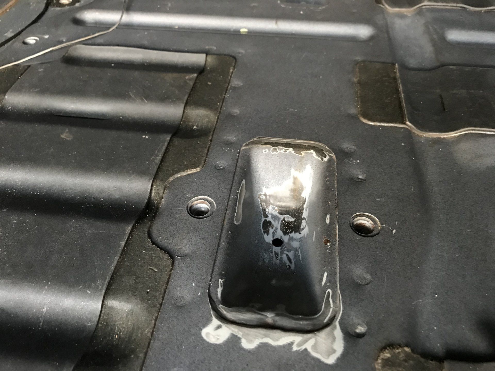

Metal prepped the center console metal frames and all the seat floor anchors to ready them for epoxy primer.
Will add pictures tomorrow maybe.

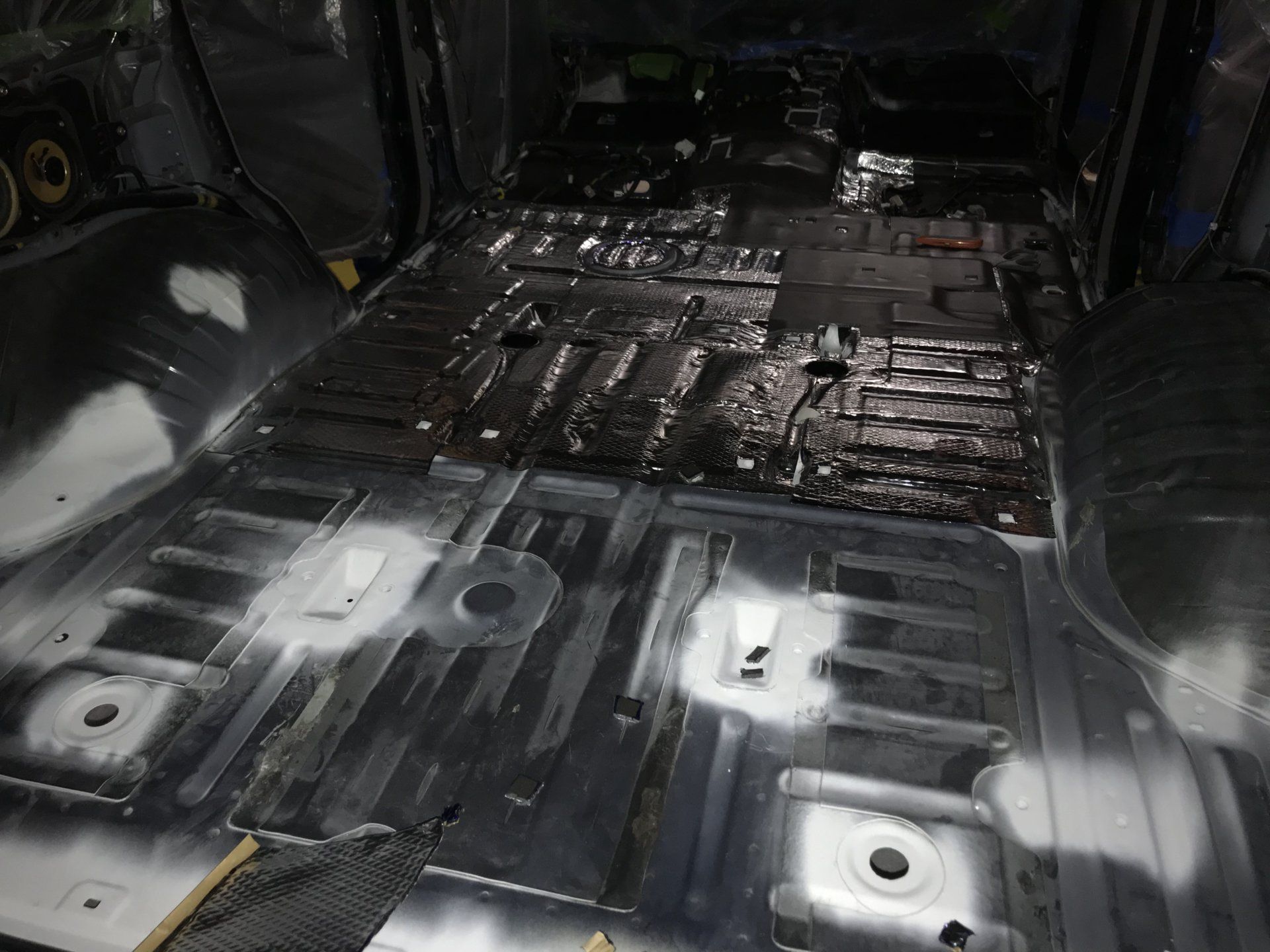

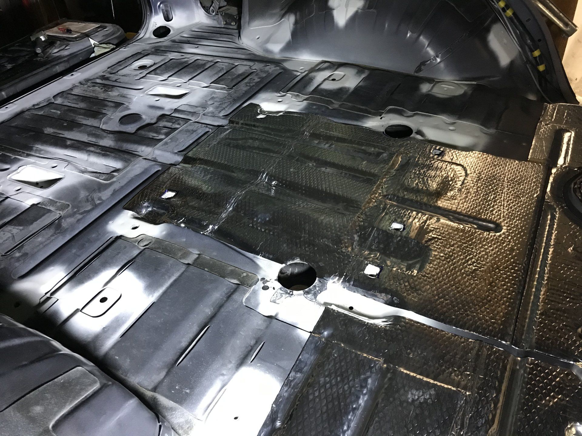

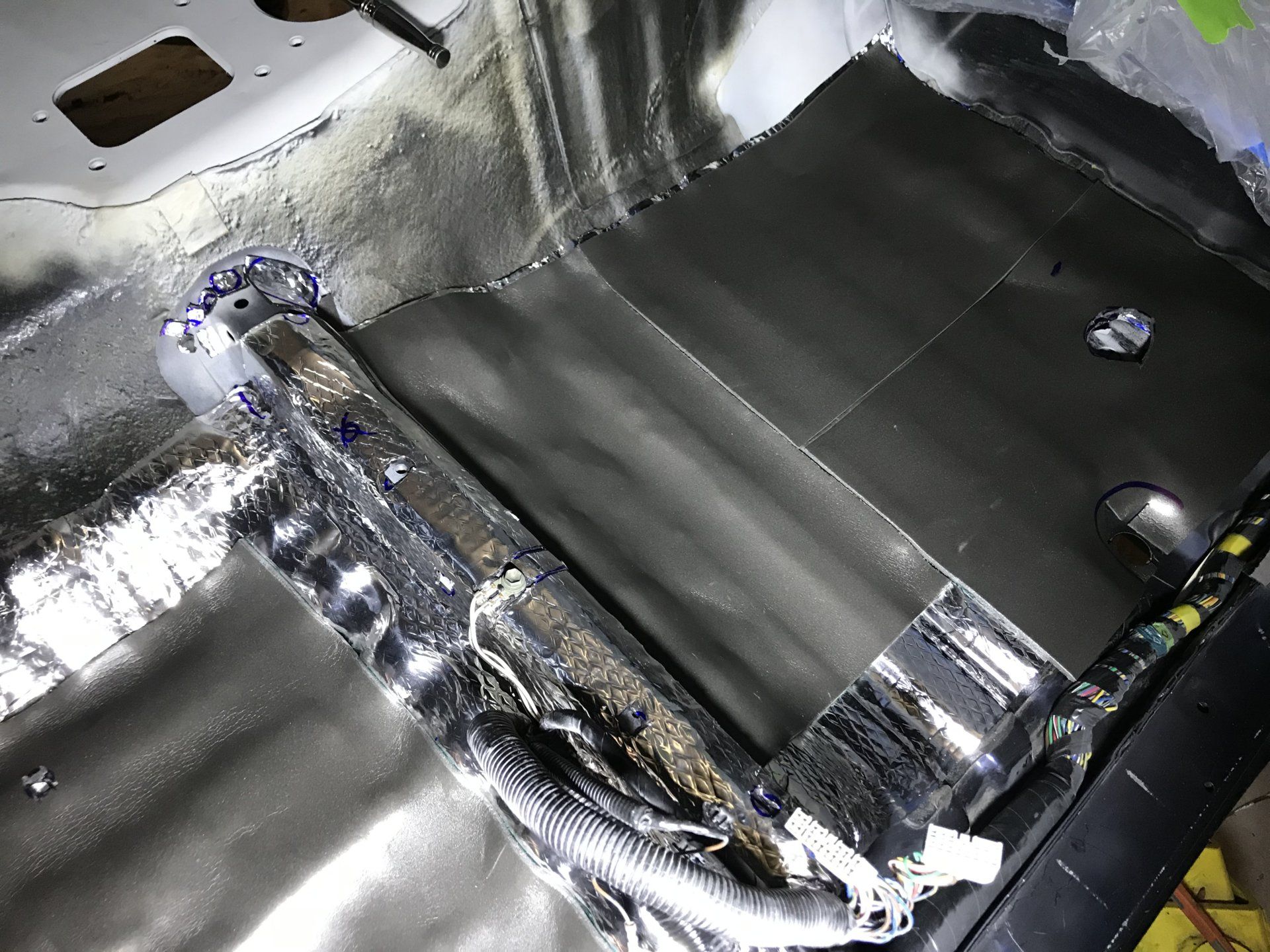

Started laying down the aluminum heat shield backed sound dampener (80 mil thick butyl) in the passenger side along with a layer of sound absorbing (170 mil) closed cell foam. Then the dinner bell rang and had to close up for the day.
