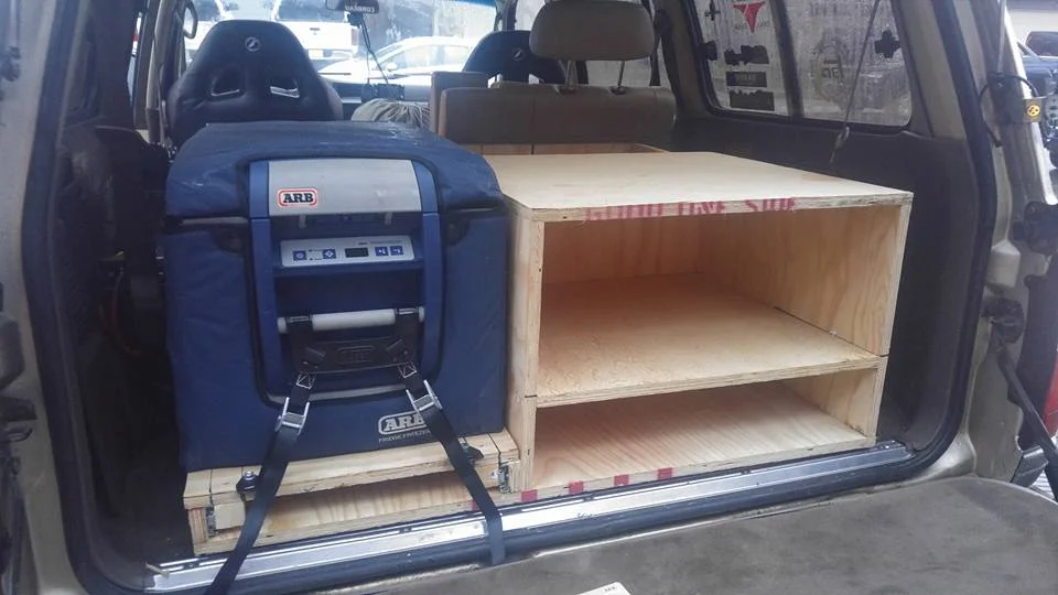

I finally got around to making a storage system for the cruiser.... while I won't call it an expo rig all that much it is nice to have when I do want to expo it up
some 3/4" plywood, a single 2x2, some wood screws, wood glue a bunch of beer and creative thinking as I'm building I have a shell and a fridge slide
the idea is the back storage is going to be my dry storage with a piano hinge, the smaller front drawer is going to be my tool drawer, I'm going to see about sourcing some foam to cut out and drop tools in. The larger drawer will depend on the wheeling trip, camping drawer of spare parts and fluids hahahah, I have to right side still available to store parts, slings and so on
Not sure how much digging into tool storage you have done yet. I found that rolls work really well too. They hold everything nice and tight, and when you need it its easy to remove the entire set and take it with you as opposed to everything singles once taken out of the foam.
Just a thought.

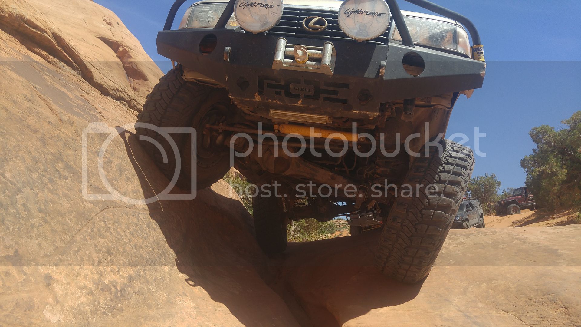

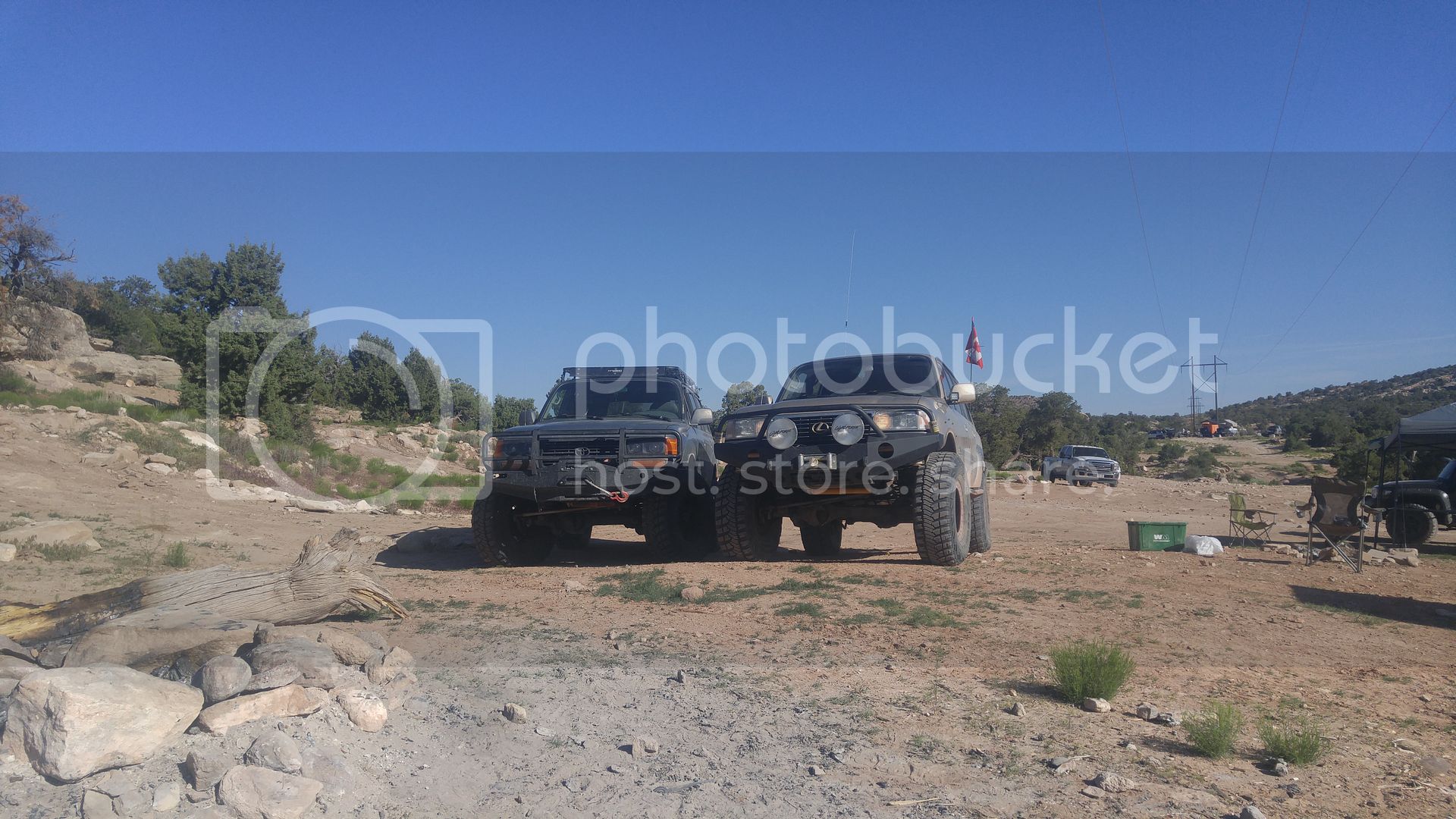

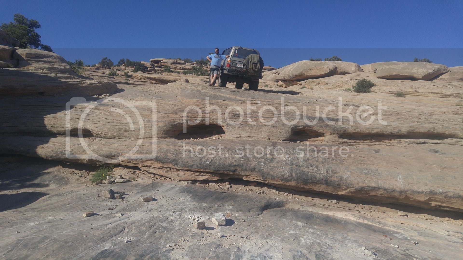

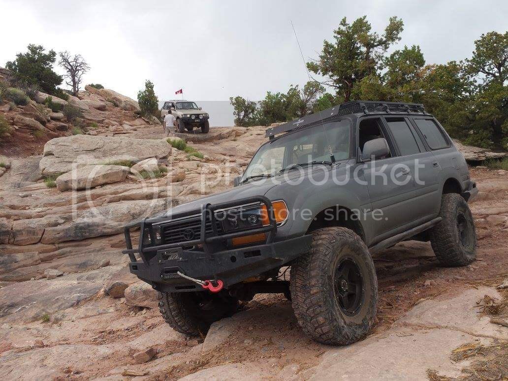

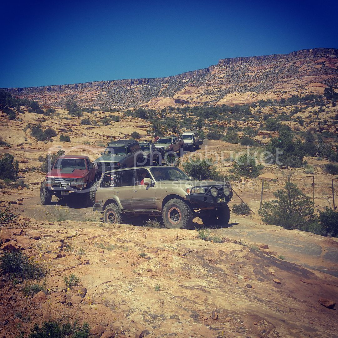

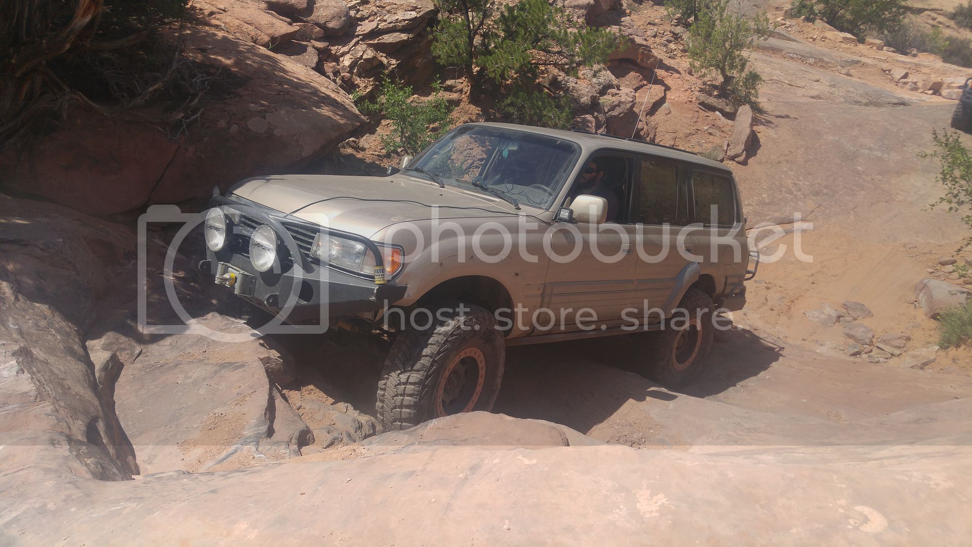

was in moab for a few days again BFE - 7 mile rim - cameo cliffs - trifecta - moab rim - flat iron mesa - steel bender
could have probably gotte more in but I got drunk a few too many nights, finally met @woody and his BJ74 is unreal

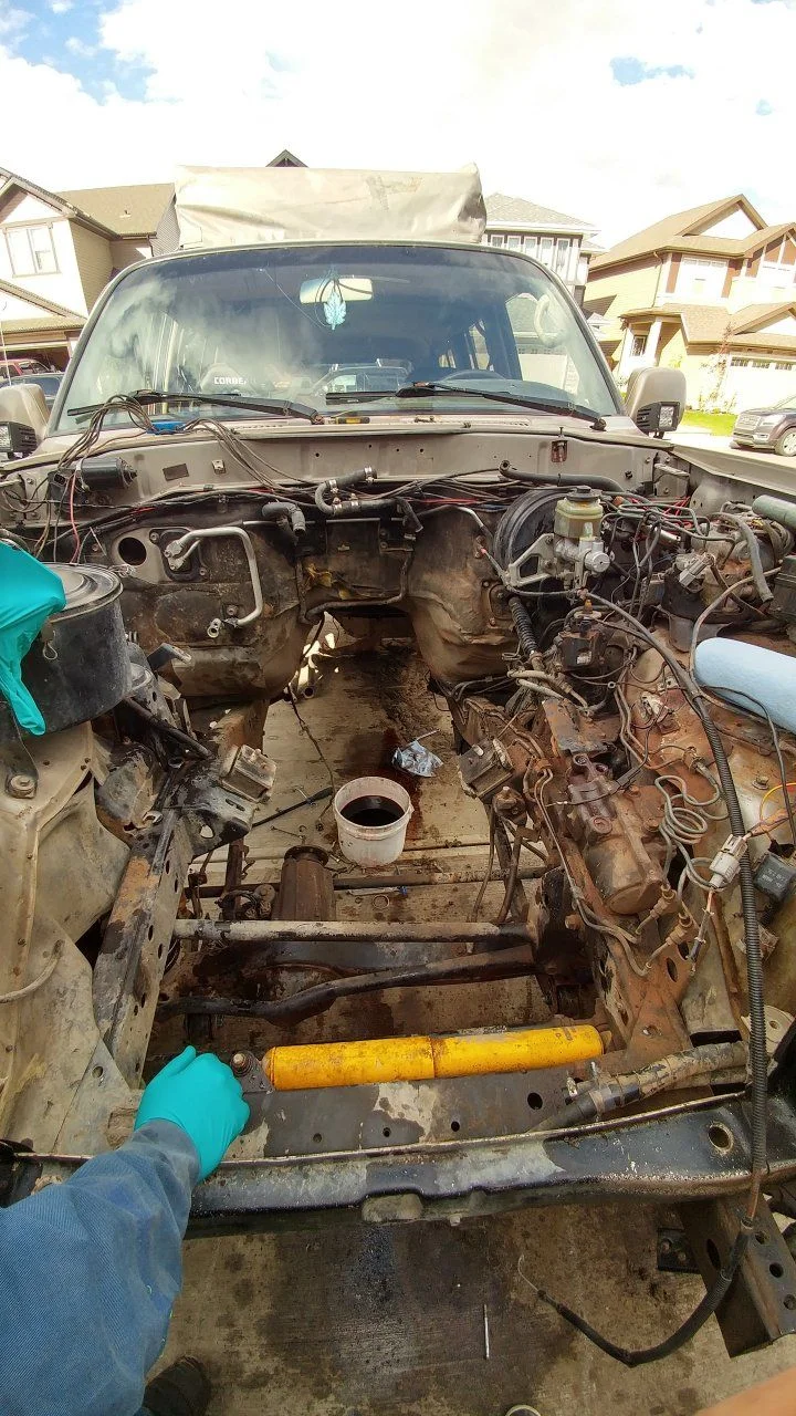

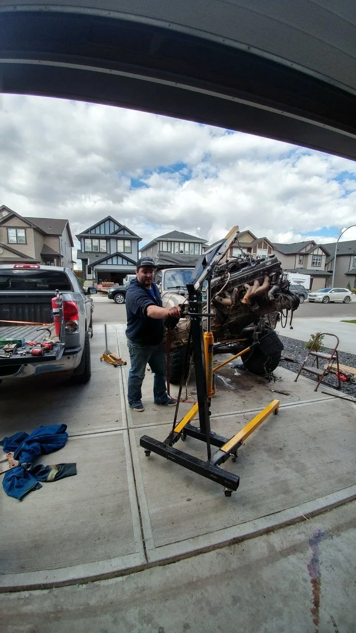

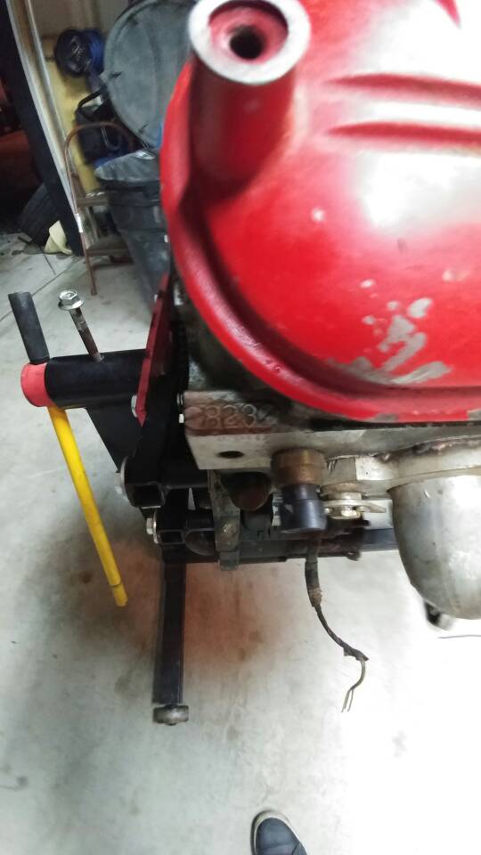

knock knock, knock goes the engine........ so yah....... out comes a 4.5 in goes Im not sure yet...... but rexus is out for the count
s***ty... I know the feeling. My engine comes back from the machine shop this next week, in its 4.6 bored over glory.
i scored a nicely built LS setup :p L76 6.0L with a good port and polish, camed, forged internals and and and..... why so much because the deal was right P and I know the history of the motor
on the hunt for a 4l80e and waiting on my harness and ecu tuned for my application :p
Josh over at Team 208 is getting me a harness setup for the LS side, leaving me lots of wire to work with the splice the 2 harnesses together, hes also cutting me a custom cam for the LS as the current cam is a little aggressive, last time this motor ran it put down around 425 at the wheels in the race truck
Ill be tearing it down a bit, replacing some gaskets and ensuring everything is happy
Its got a set of custom port and polished heads, full dry sump setup with oil filter relocation, full competition rollers and rockers, pushrods and so on... fully forged bottom end with an 11:1 compression ratio, having the cam cut to support up to 6500 rpm but chances are ill rarely see that!

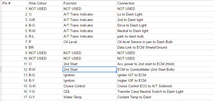

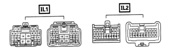

was looking through some EWD's for the 97 LX450 they are definetly different than other generations\
I should be able to start deciphering what I need and dont need over the next couple weeks

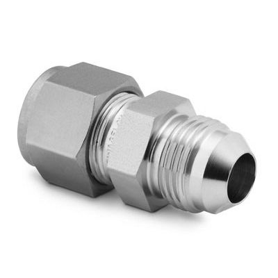

so im more than likely going to change my fuel lines from factory sizes to a 1/2" SS tubing and adapt the flex portions with AN braided fuel hose
going to place an order for these this week at 88 bucks for 4 fittings

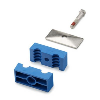

than ill either use a regular p-clamp or thse cushion clamps @ 5.50 a piece

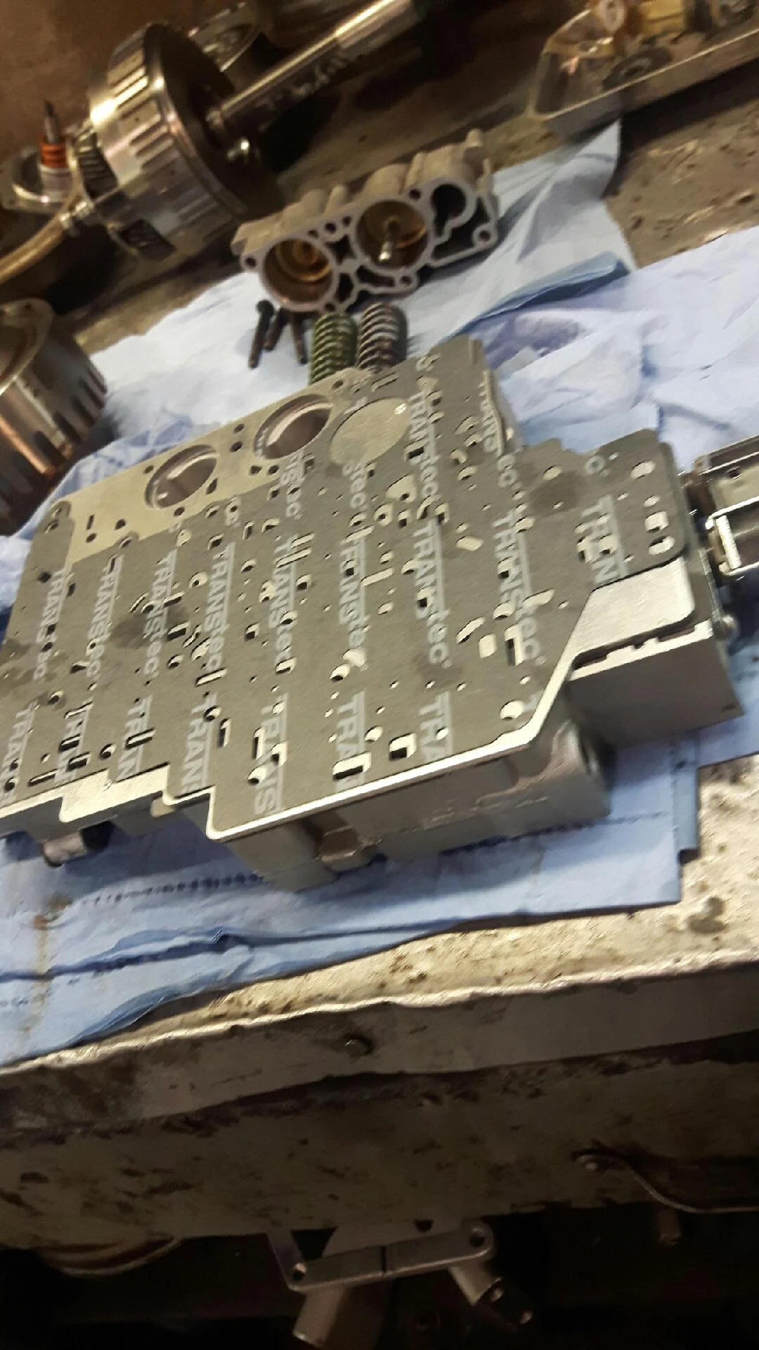

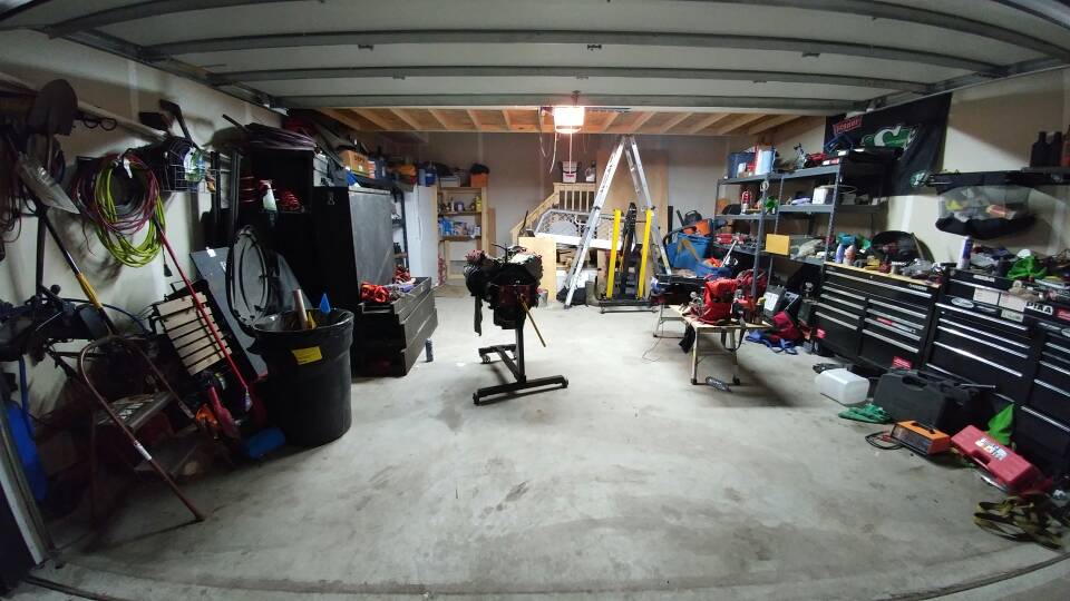

tackled the trans only to realize im going to more than likely have to take it apart........
I need to install my speed sensor.... retrofit kit is sitting at home......
however the HD2 transgo shift kit is installed, fresh seals and new clutches as they were showing stress cracks
