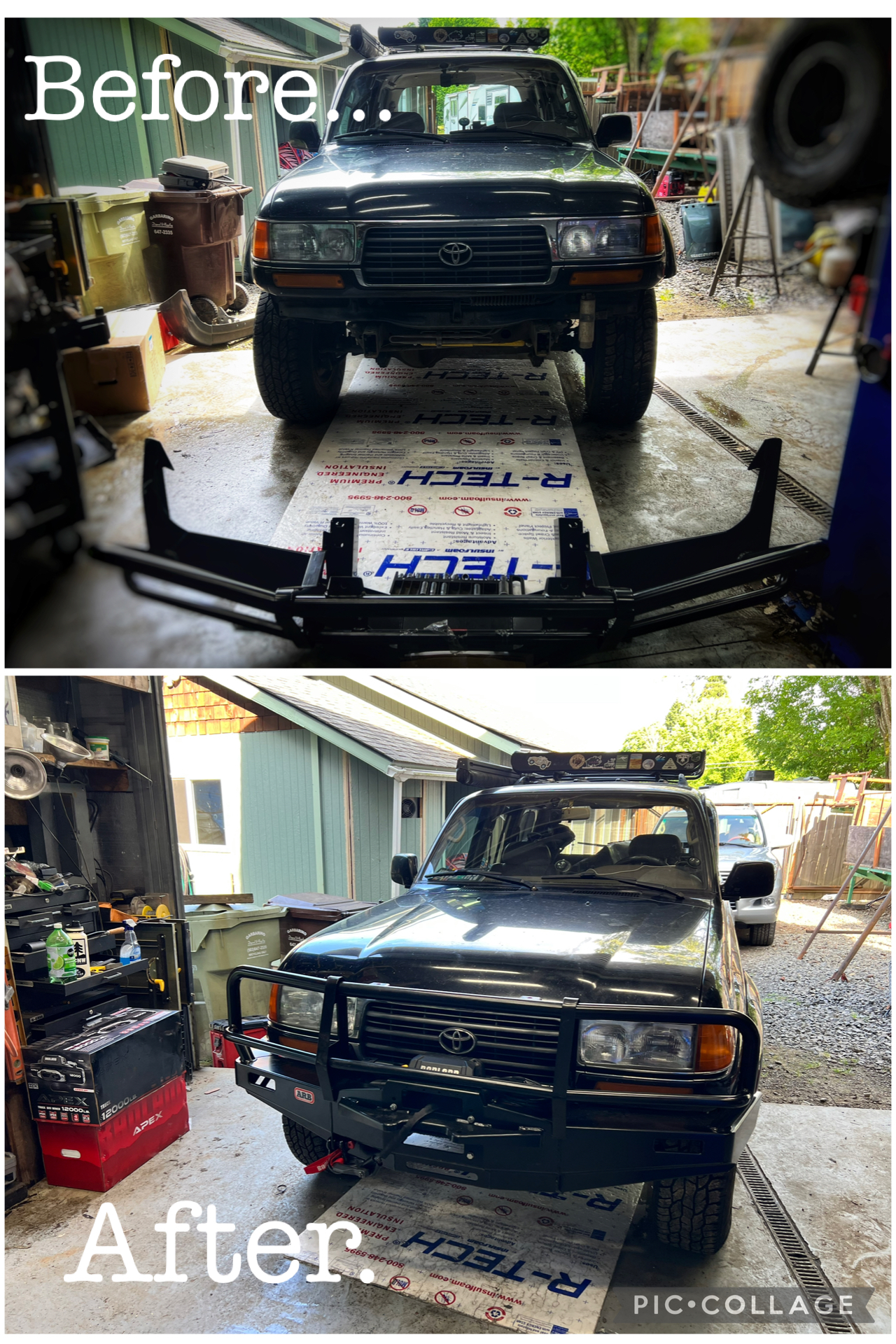

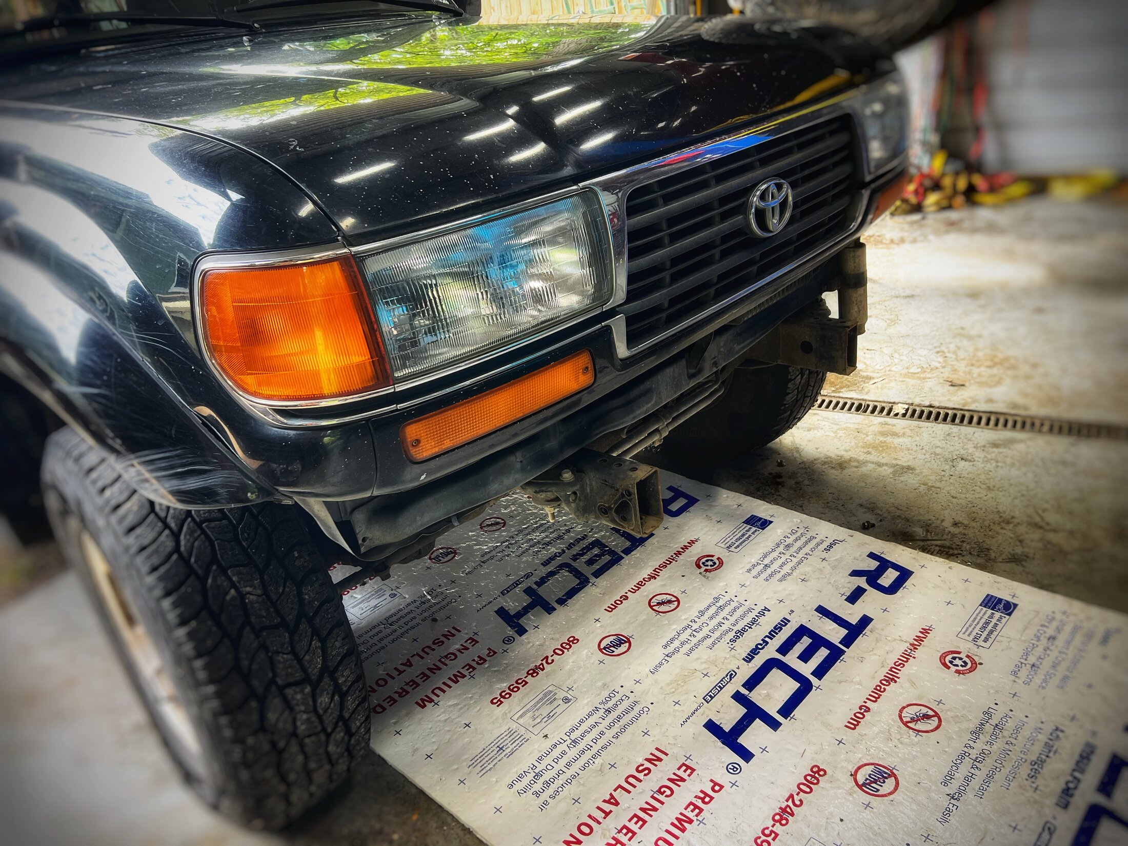

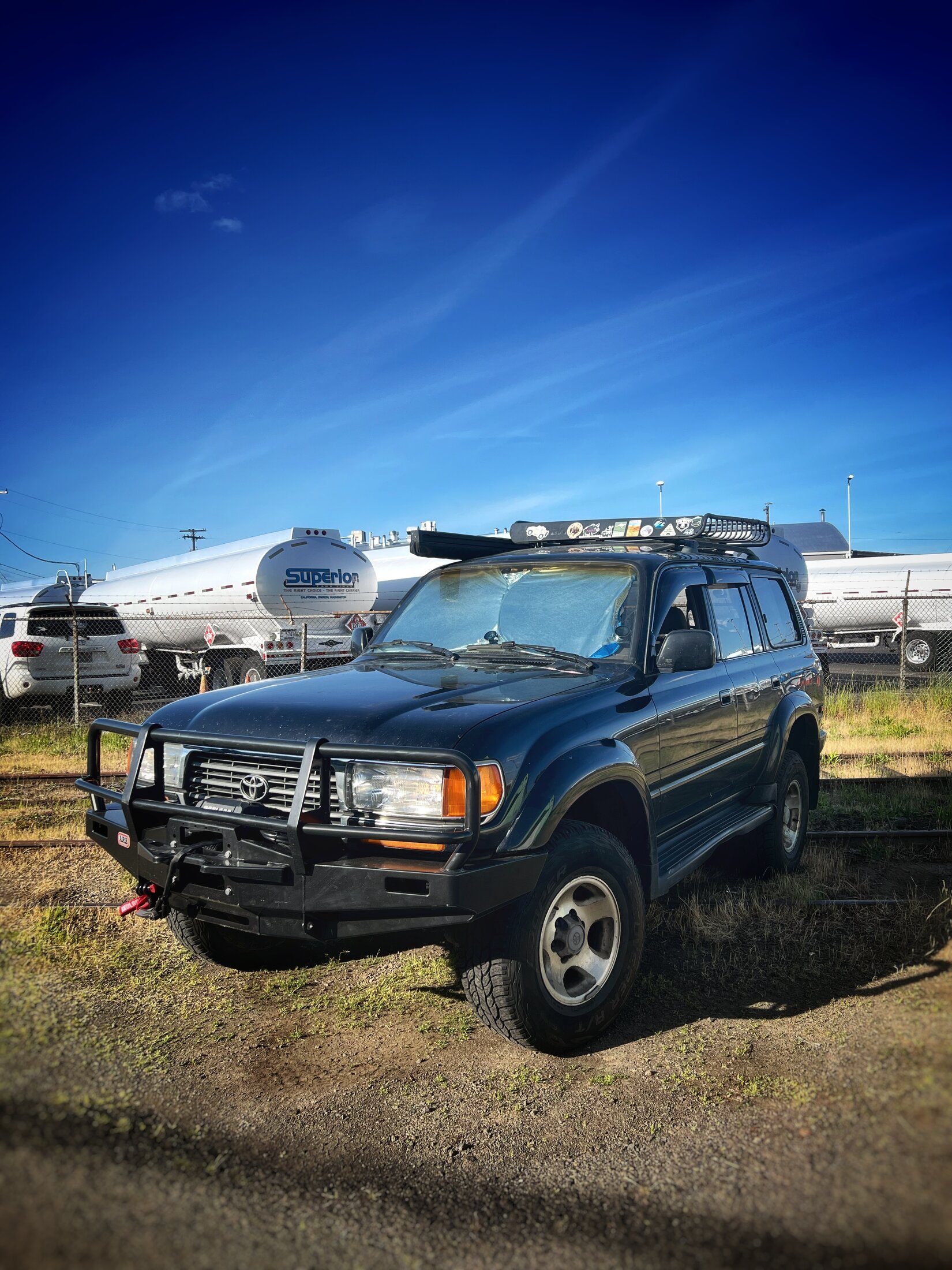

Recently added the ARB front bumper and Apex Badlands 12k pound winch!
She’s growing up now!
(These pics don't show it, but the side ARB marker lights ARE installed and working...they weren't when the pics were taken)
