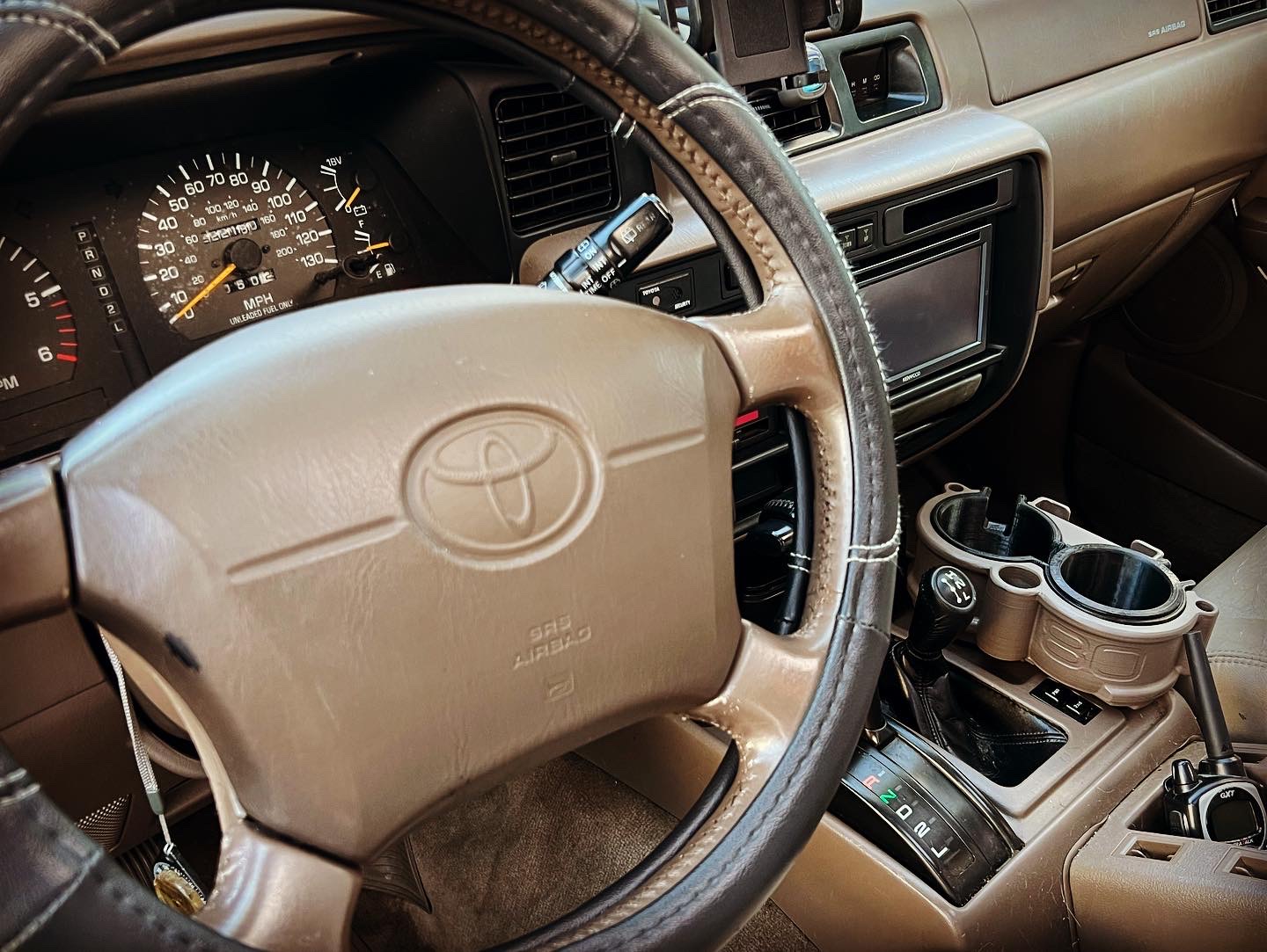

I also added the dual cup holder from @bhicks once the sunroof was sealed and I'm super happy with it.

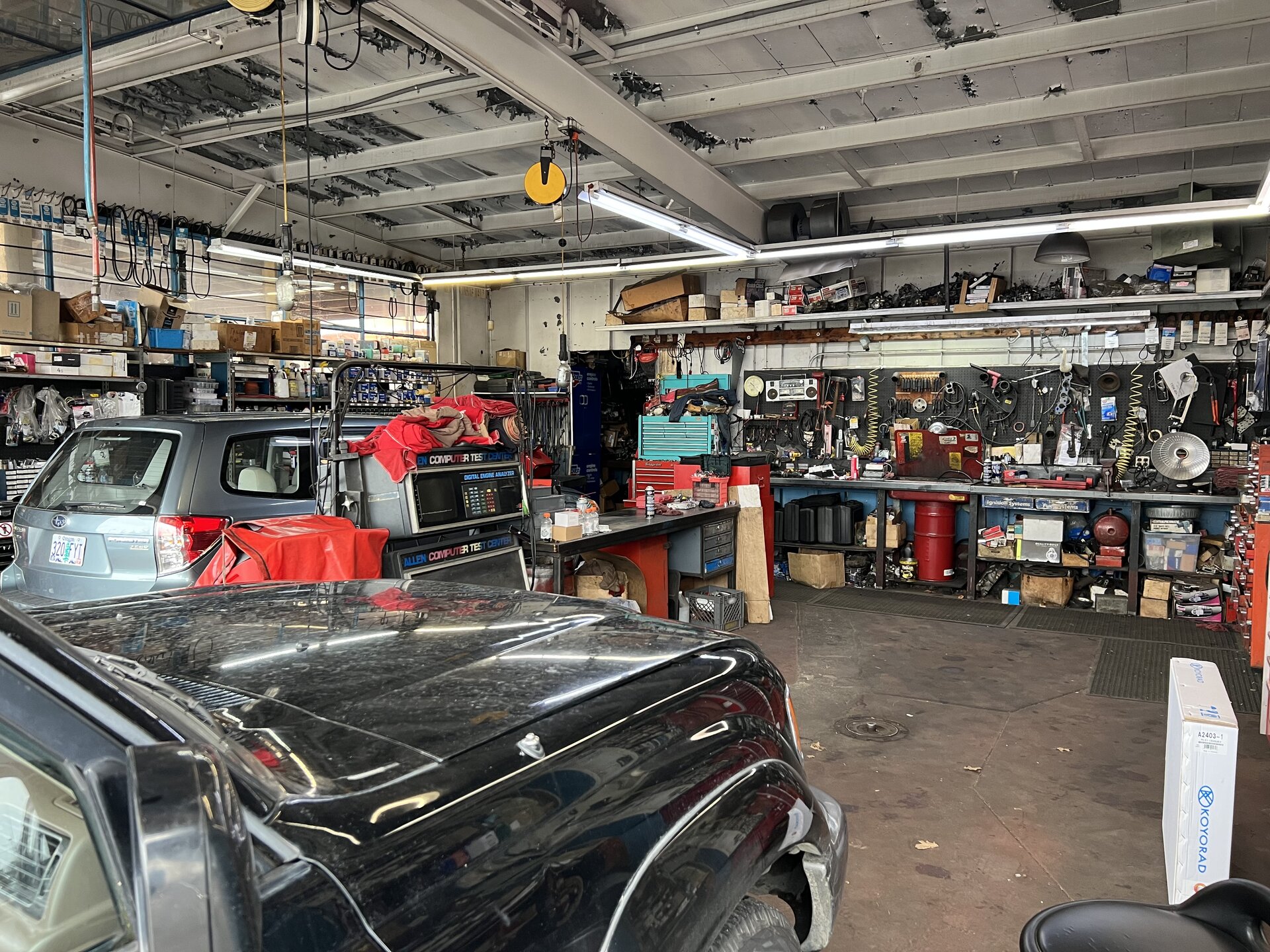

Shout out to the shop I went to who deals specifically with auto electrics. The three guys there have a combined 100+ years of working in the auto industry, predominantly on auto electronics.
Three hours and the issue was resolved. I’ve had the Land Cruiser almost 8 years and except for a brief moment after it coming home, the windows have never gone down. The sunroof hasn’t opened, either. The radio would occasionally work but a few years ago it just completely stopped. The clock would work from time to time, same with the cigarette lighter (for charging)…gauges would work but not the gauge lughts. AC controls all worked and so did those lights…door lights worked but two of the three dome lights wouldn’t…door locks would lock themselves…mirrors wouldn’t move…a whole bunch of electrical gremlins seemed to have found a home…until this past Friday.

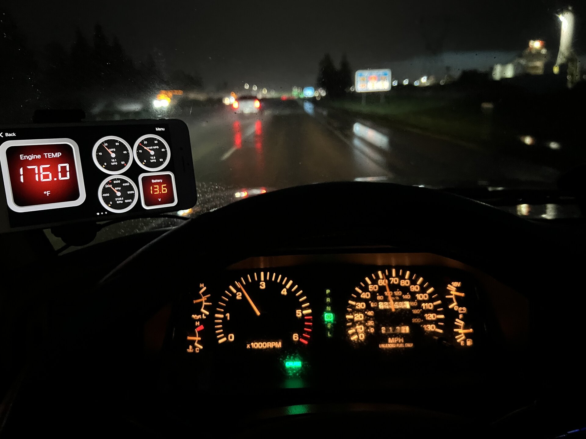

I never knew the dash cluster was that dirty until I saw it at night 😂😂🤷‍♂️
But since he had the entire cluster out, he went ahead and replaced all the bulbs with new ones as they all were original and “looking real tired”.

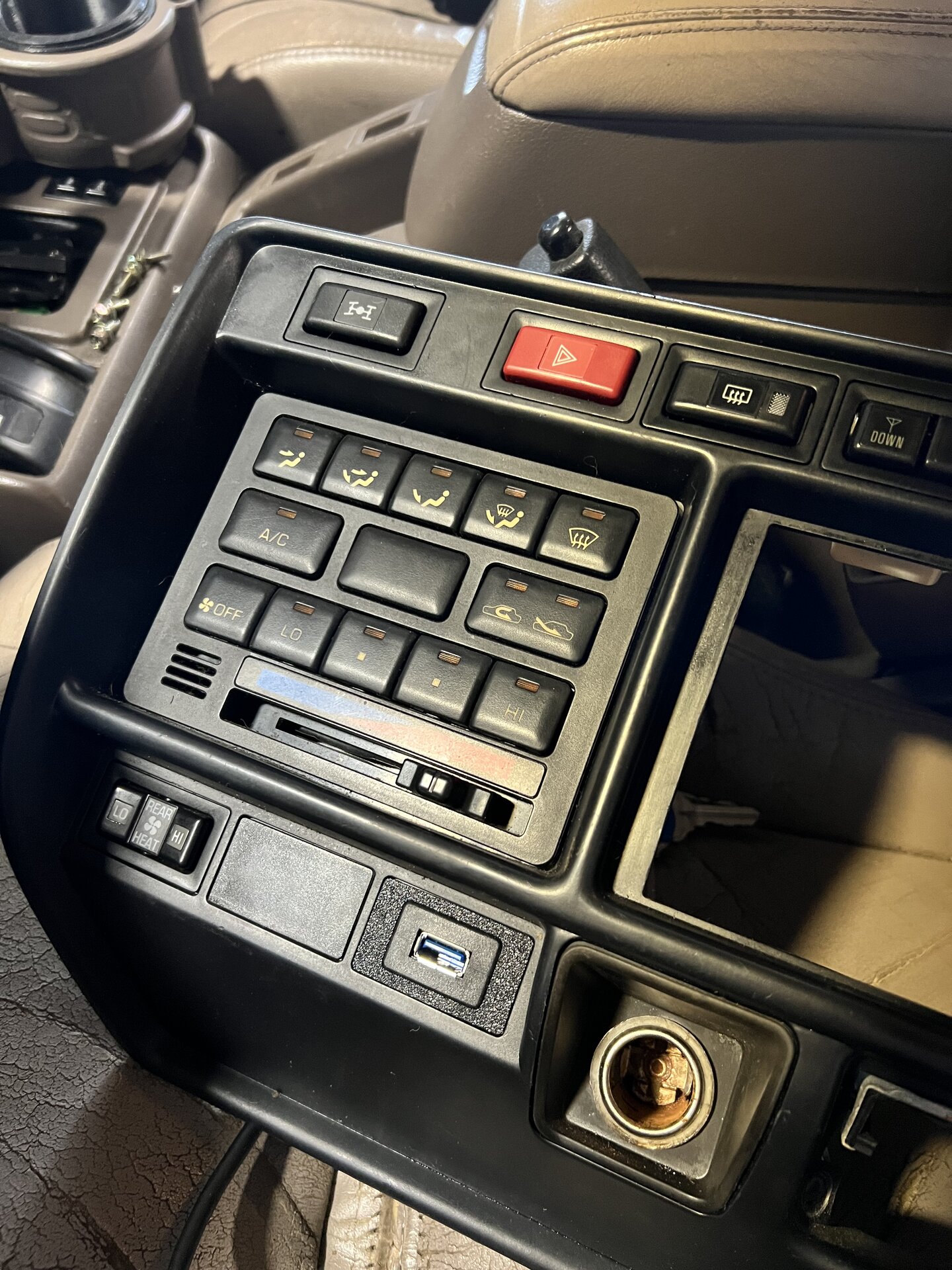

CDL / JDM hazard switch & USB port:
Installed the CDL switch, which was easy...just pulled out the SECURITY tab and inserted the CDL switch from a Rav4 (same part number). I was also able to source the JDM Hazard switch...it had to be dremmeled a little to sit flush, but it took about 10 seconds. The cool thing about both switches is that they light up and can be adjusted via the dash light nob on the left. And yes, the red JDM switch triangle is incorrect...this one came out of the Toyota 4x4 van and was vertical. it doesn't bother me. The USB port is courtesy of @Outsane (SolveFunction) and it's really well printed and secure. I'll definitely purchase another one soon!
