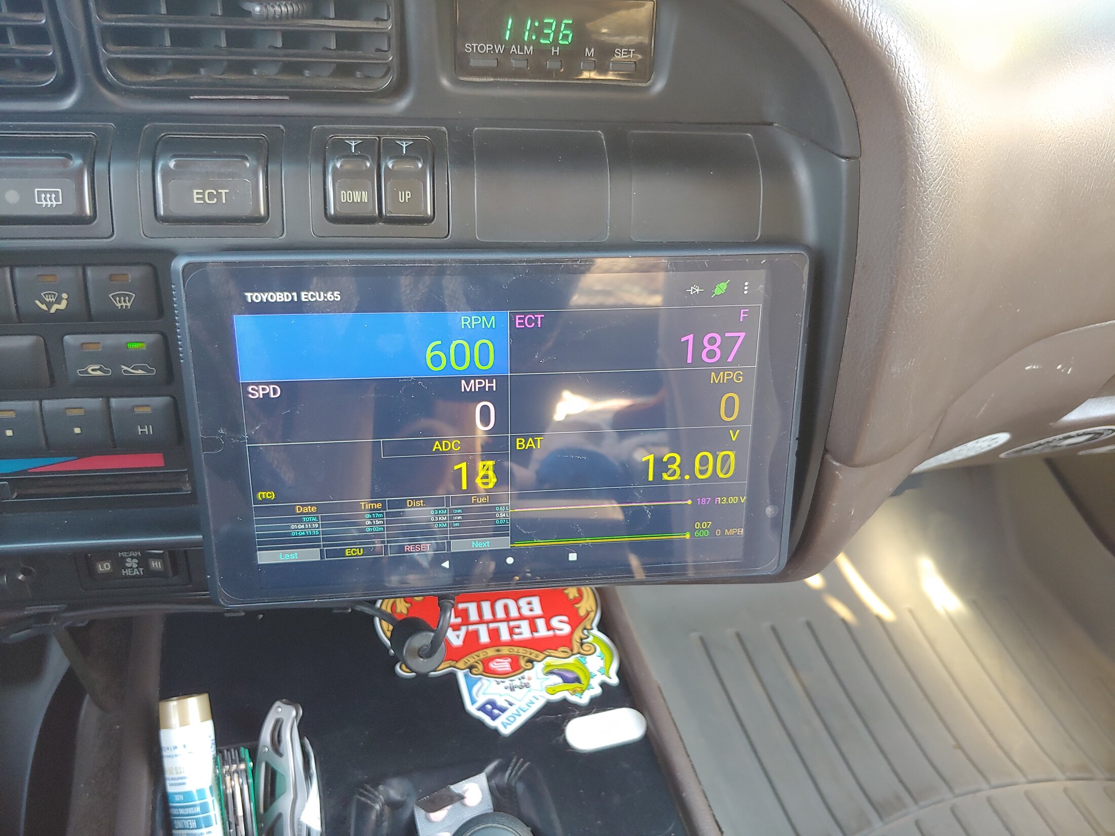

Prob not a bad idea to also install a scangauge to monitor your ECT.
