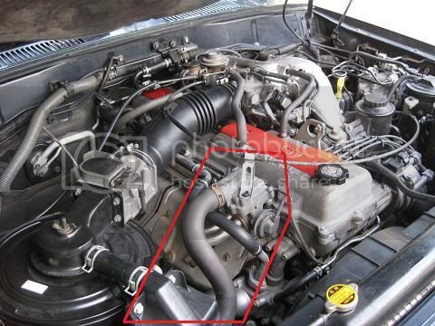

To remove the PAIR system is very straight forward once you get to turning wrenches. Use the gaskets on the tubing coming off the exhaust manifold to make some block off plates, I used some galvanized 20ga sheet metal i had laying around. Only thing i haven't got around to is finding a nice rubber nipple to block the large hole coming off the air box :hillbilly:
Can't tell from the pic but is there a short tube coming off the box? If so, track down some crutch tips, you may be able to find one that fits close enough to block the hole. The crutch tip may not be an exact fit but silicone can be used to fill the gap and keep the crutch tip on. This is the approach I used on a 2F air box and it's worked well.

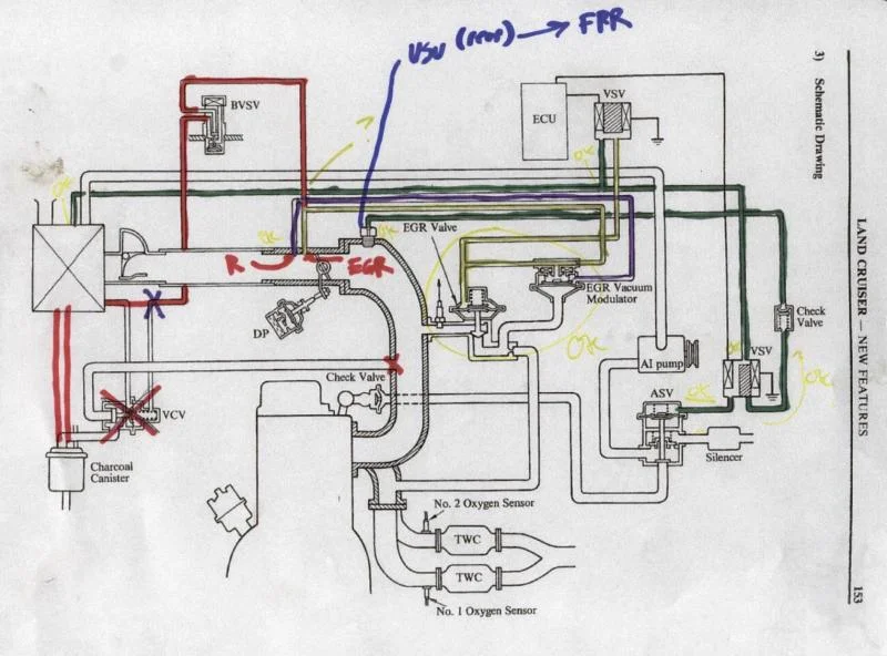

I wanted to include some 3FE vacuum schematics in order to help everyone understand what lines feed what systems.
NOTE, I found these schematics when researching the 3FE that came out of an early FJ-62. I am not sure what differences btwn the 62 3FE vs. the 3FE for 80 series!

I color coded my schematic by system - it helped me keep track of the different circuits (also shows mods for putting 3FE in my FJ-55):
attachment.php
From here: https://forum.ih8mud.com/60-series-wagons/272486-3fe-vacuum-schematic-needed-88-62-a.html
