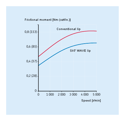

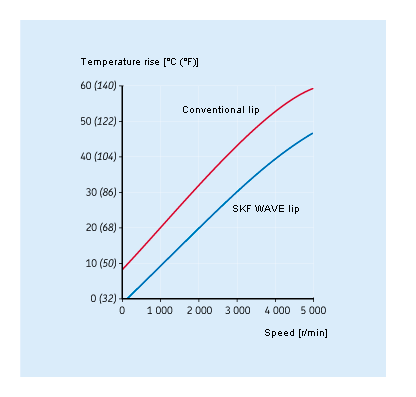

SKF WAVE seals represent one of the most important developments in radial shaft seals. The sealing lip is moulded to a special form, producing a relative movement on the counterface, imparting hydrodynamic properties. SKF WAVE seals are suitable for rotation in both directions. They pump the lubricant back into the bearing arrangement and expel contaminants. The sinusoidal form of the sealing lip considerably extends the path (fig 4) on the counterface surface and at the same time reduces the specific surface pressure at the sealing lip/counterface contact.
As a consequence, SKF WAVE seals produce up to 20% less friction (diagram 1) resulting in up to 30% lower temperatures (diagram 2) than conventional lip designs. Reduced friction and the sinusoidal path of the sealing lips help prevent the formation of deep tracks in the counterface, resulting in significantly extended service life. SKF WAVE seals are recommended where demands for operational reliability and long service life for machines and equipment are high.
Market speak? CHECK! does it work, I sure hope so. It appears a few companies use technology but SKF is the one I could find that had the right size.
