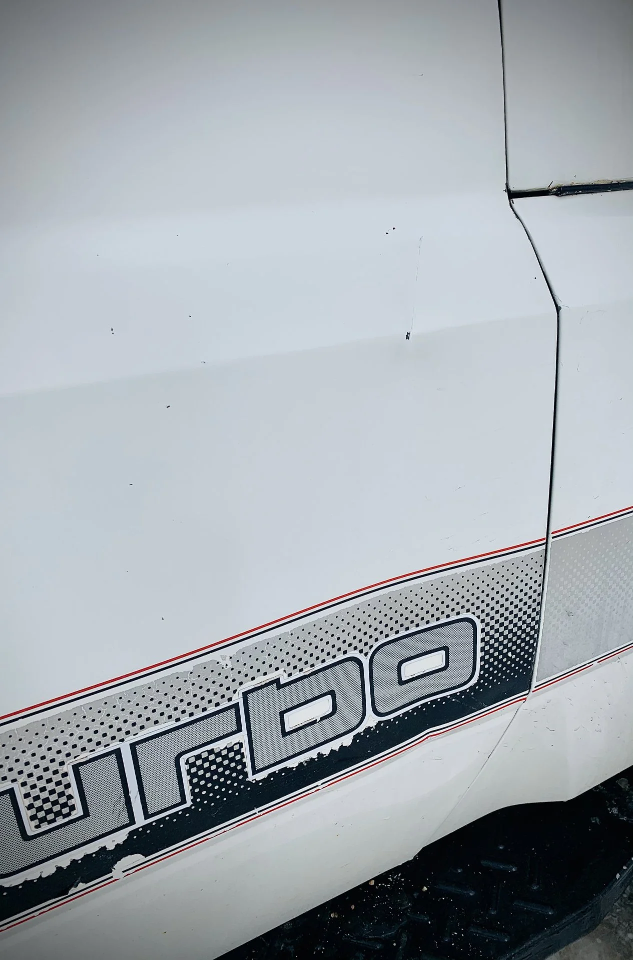

Tundra to the rescue. Got back from the disaster at work and decided to try and start the cruiser. Had to back it out but my shop has a small ledge and hill to get into it. You have back out and be able to get in so it won't roll into a tree behind. So as I was pushing it I slipped on the ice and didn't get the door closed enough or time to stop. :eek::bang:
Yeah, not real happy about that moment of stupidity. The bottom hinge is a little sprung, but overall no major damage. I should be able to push that little crease out to straight again....hopefully.
