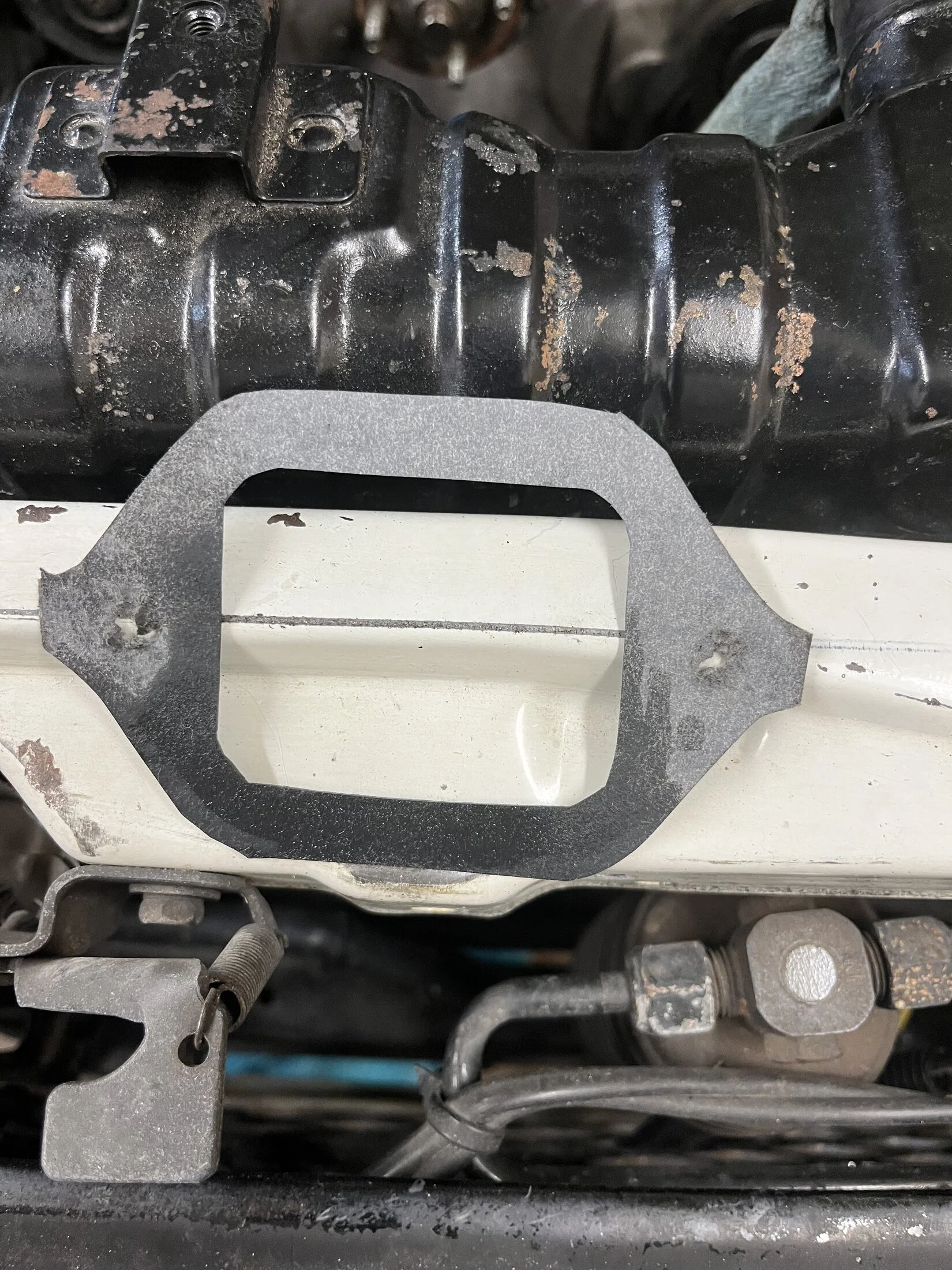

I was just providing the part number for what Dan recommended.
For coolant situations we use 08826-00100. You throw up at the price.
Oh, I forgot about that one. That would be the one to use. It's relatively new. Maybe 10 years or so?
small tubes of permatex are pretty reasonable

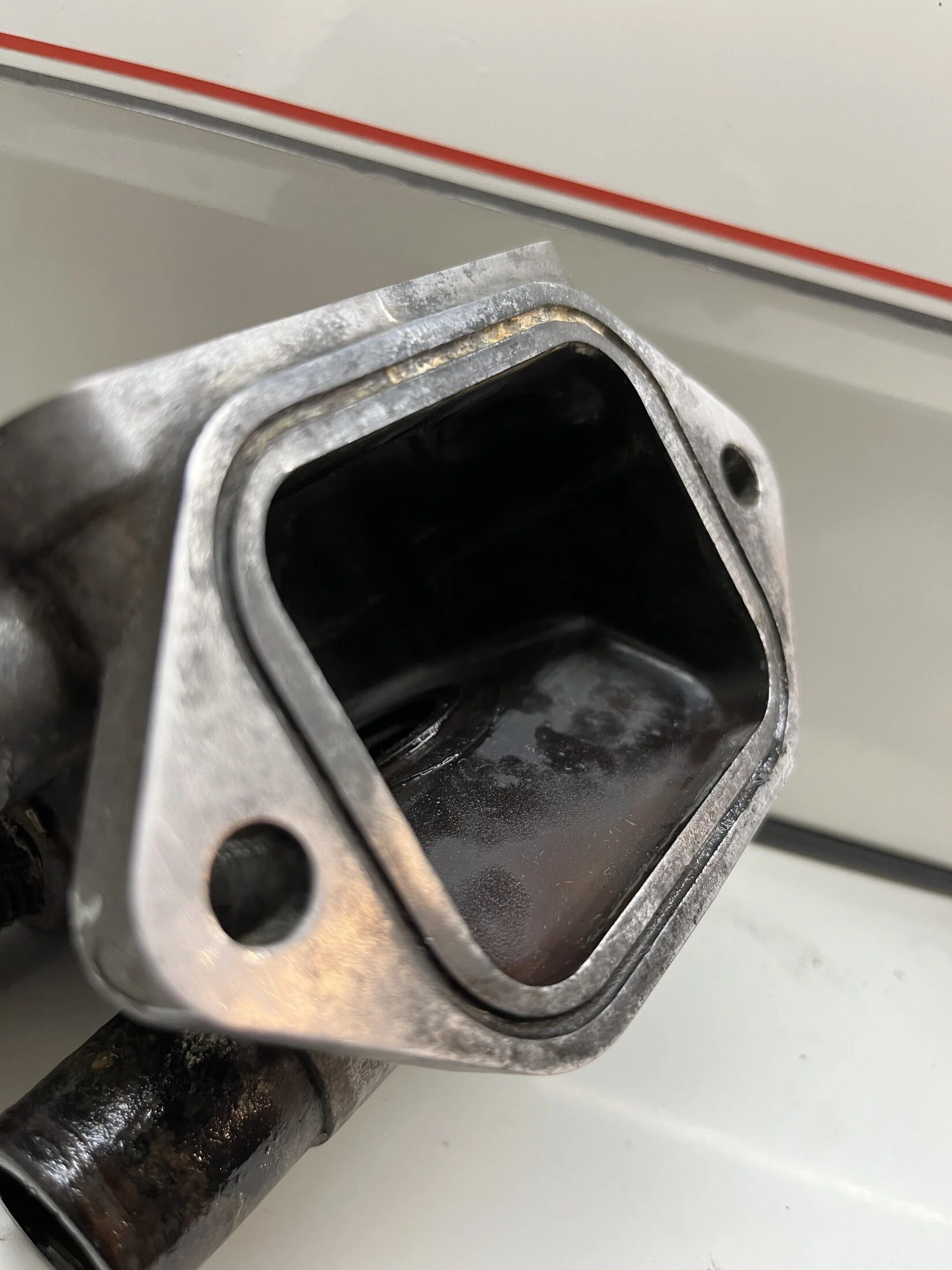

Aaaaaand that gasket didn’t work.
So I might get another type of gasket material and put RTV on both sides.
Which RTV to use? I don’t think FIPG is correct for coolant.
That housing looks very similar to the coolant outlet on the cylinder head of a VW TDI. They use an o-ring to seal against the head, looks like the groove in yours would fit an o-ring great with a little cleanup.
I agree. That groove seems like an oring should sit in there. I don’t find any reference to it though.
Im hoping with the right gasket and FIPG on each side it should be good to go.
The groove is for RTV.

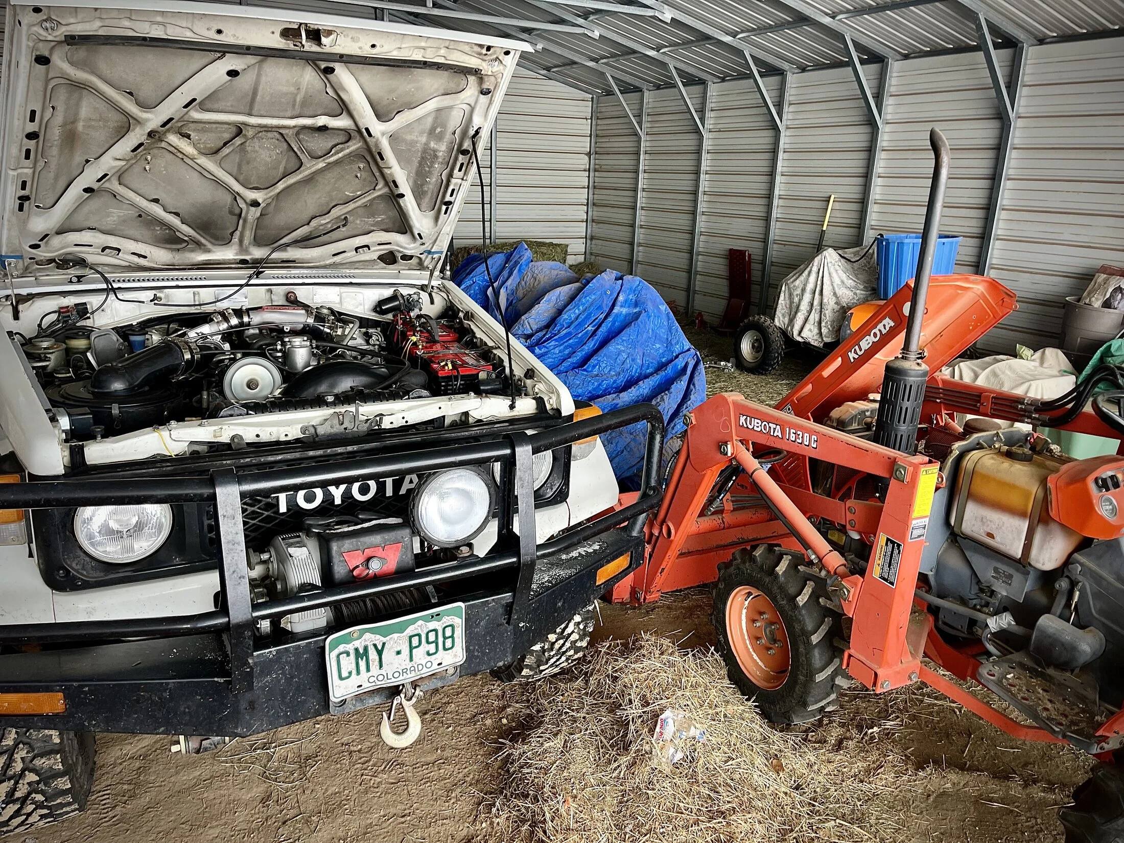

Topped fluids, last bolts and belt and went for a test drive. Nothing like topless in December…or something like that 🤔
No leaks to see yet, I’m sure still need to burp the coolant more.

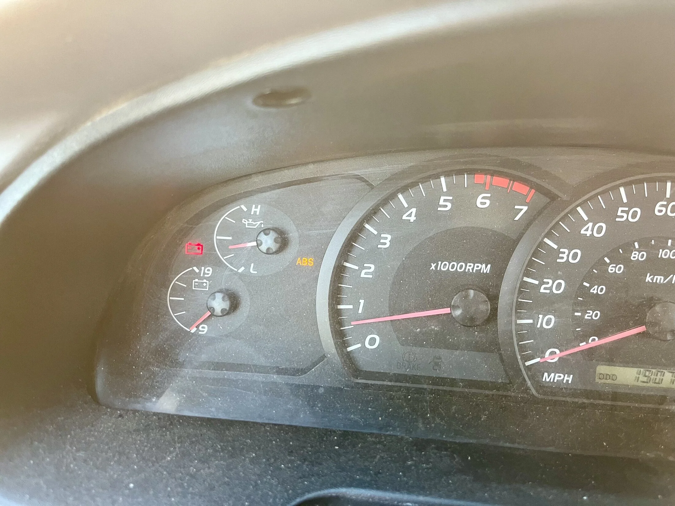

10.1v output. I had minimal tools with me and an oreilleys in town, not too mention it’s 15 degrees out. However I did have a garage so that’s at least a plus.
Limped 12 miles into town, no lights/blower anything. Hit the parts store confirmed bad alternator and they only had 1 in stock. Lifetime warranty…right because I’ll replace it 2 years.
Anyways the one on the tundra was a reman. I’ve had this tundra since 112k miles and it has 190k now so OEM must have failed early as I’ve never replaced it.
It’s always something….
