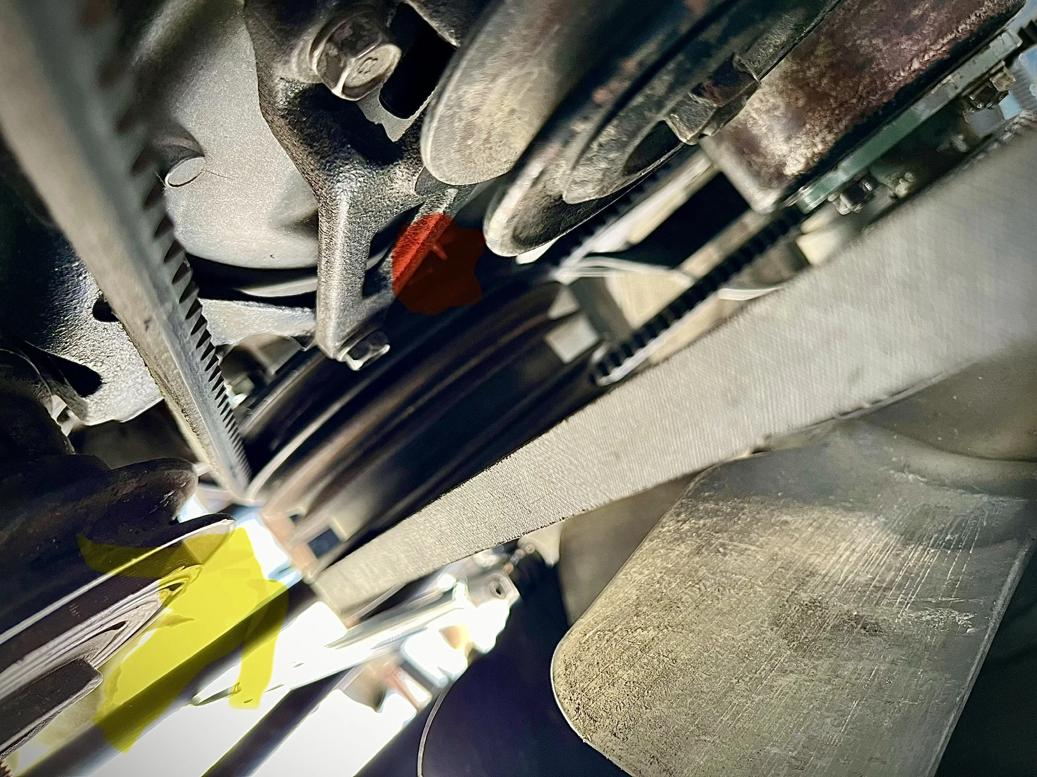

I spill timed it and…
The red mark is the timing pin, the yellow is where the marks are on crank pulley. This is the point the fuel spilled out.
bad news: I must have bumped timing somehow putting the gear back on. Ironing else moved so it must have been bumped while putting the automatic timer back on. 😕

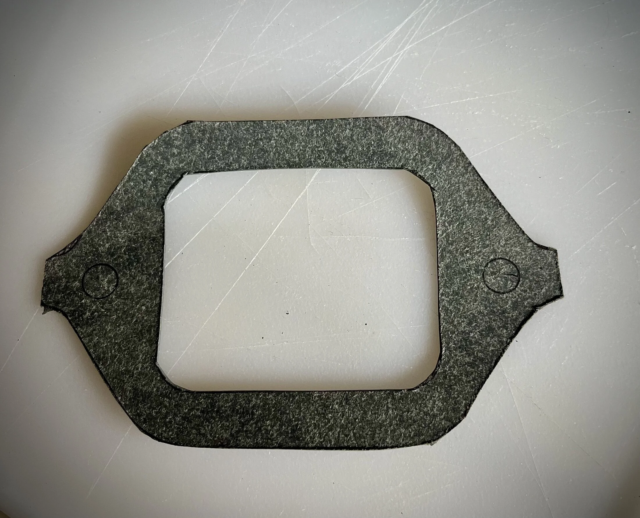

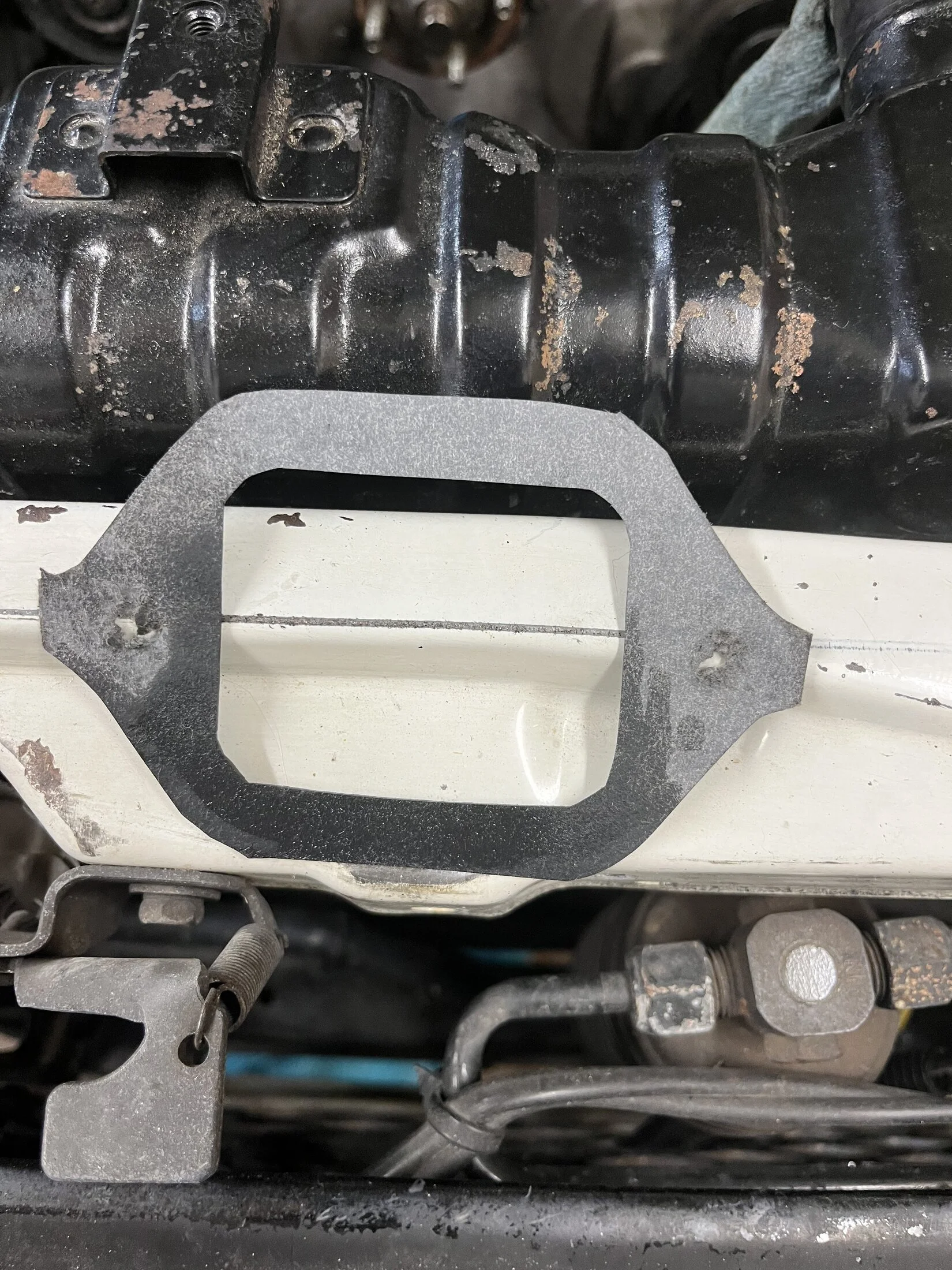

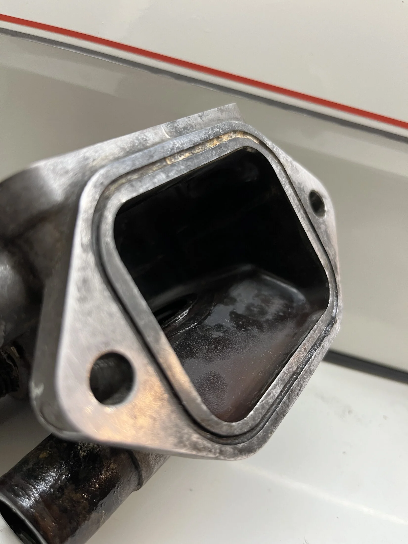

Making the gasket.
'the right stuff'
permatex
ya coolant safe, so it says
Toyota black FIPG?
