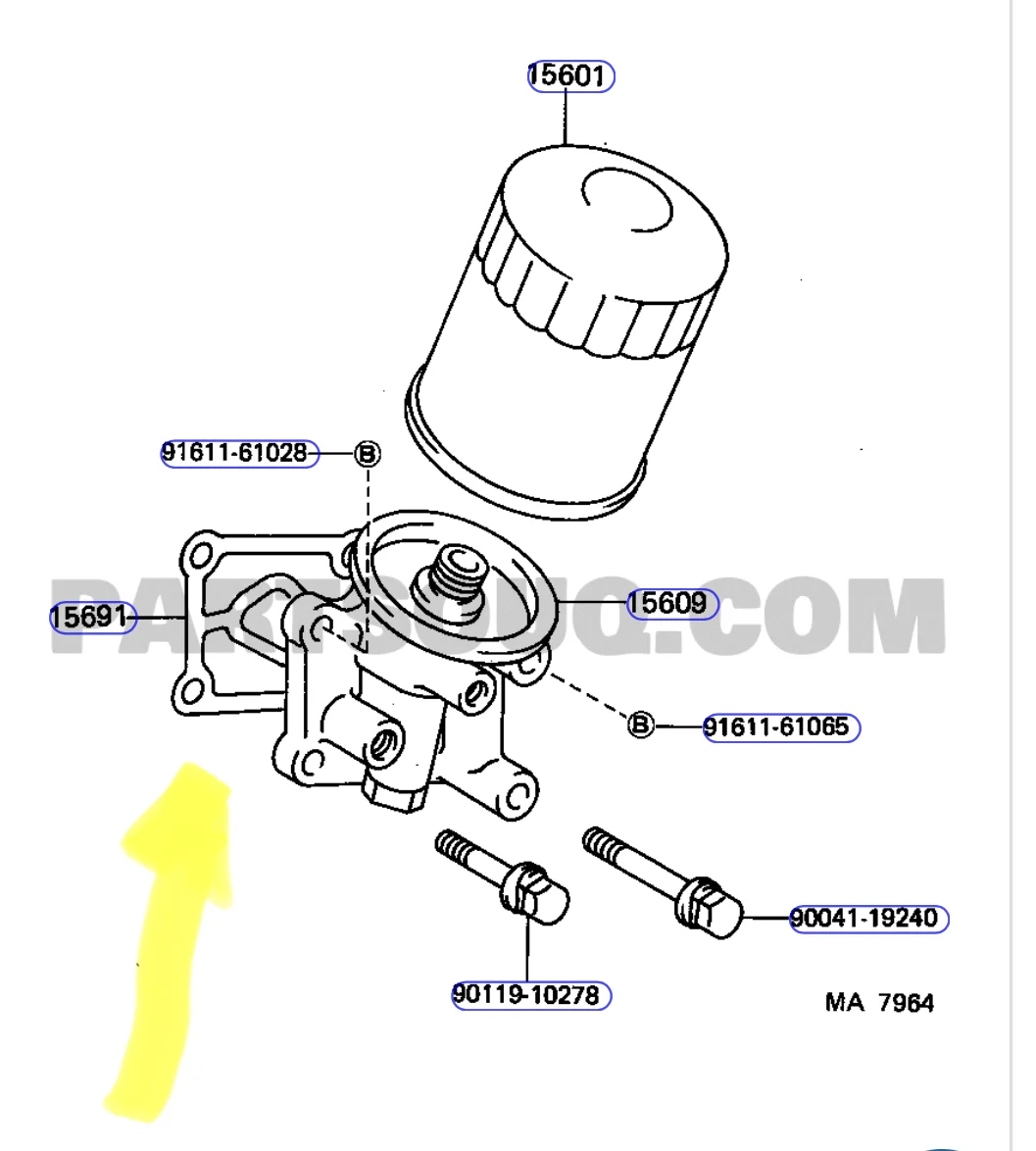

So, I went ahead and ordered most from partsouq except the oil filter gasket which appears NLA from partsouq. 15691.
Can I just use FIPG there until my order arrives or am I Stuck waiting. I couldn’t seem to find that gasket.
Black FIPG may work. How hard is that to get to when everything is assembled? If it's buried deep I'd wait for the gasket.
It’s not buried too much. Since it’s on the outside of the oil cooler, I don think you will loose any coolant, but I need to inspect it a little more before that decision.

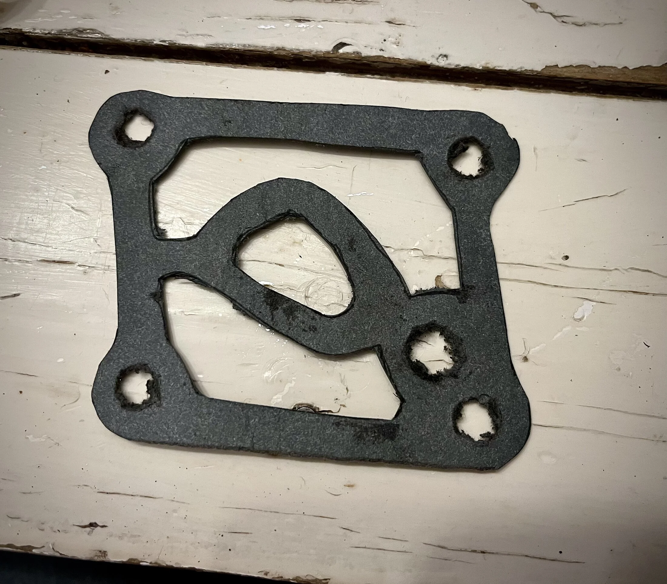

Edit: I suppose I could make one, but it’s not the most fun to trace out.

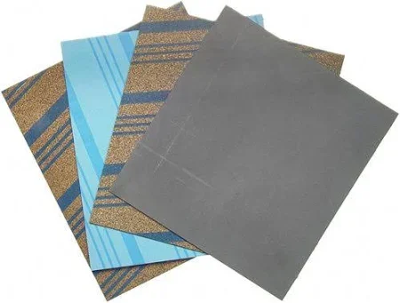

If you do make one be sure to select an oil-resistant gasket paper. A cool way to cut holes for bolts and passages is spent cartridge cases. Sharpen the case mouth a bit and use it like a leather punch.
DO NOT use a live-primed case...:doh:

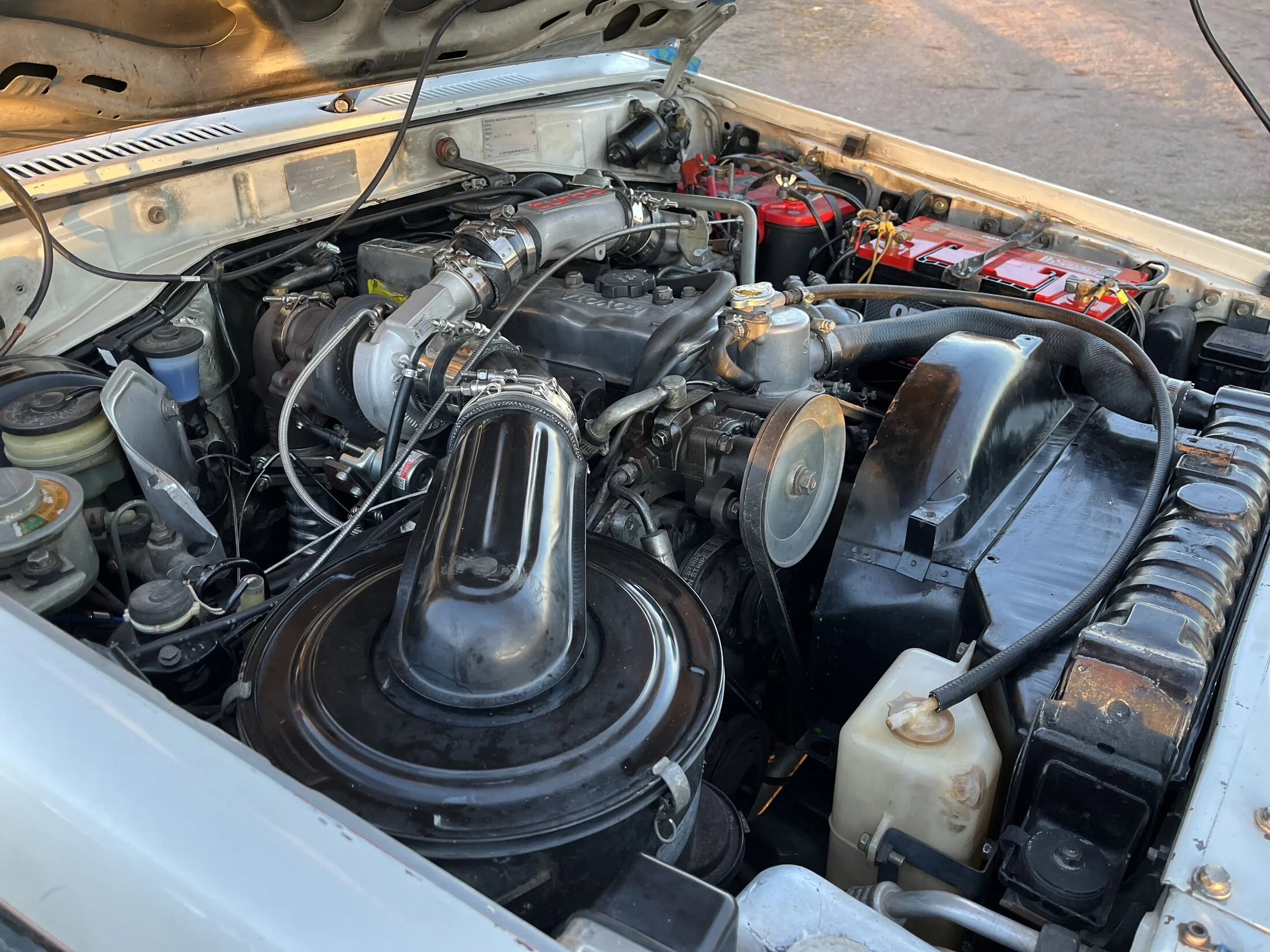

Got some more work in
That was stuck on with FIPG. Unfun.
Here’s where I stopped tonight. Mostly all together. Still have the oil cooler to do once my parts show up.

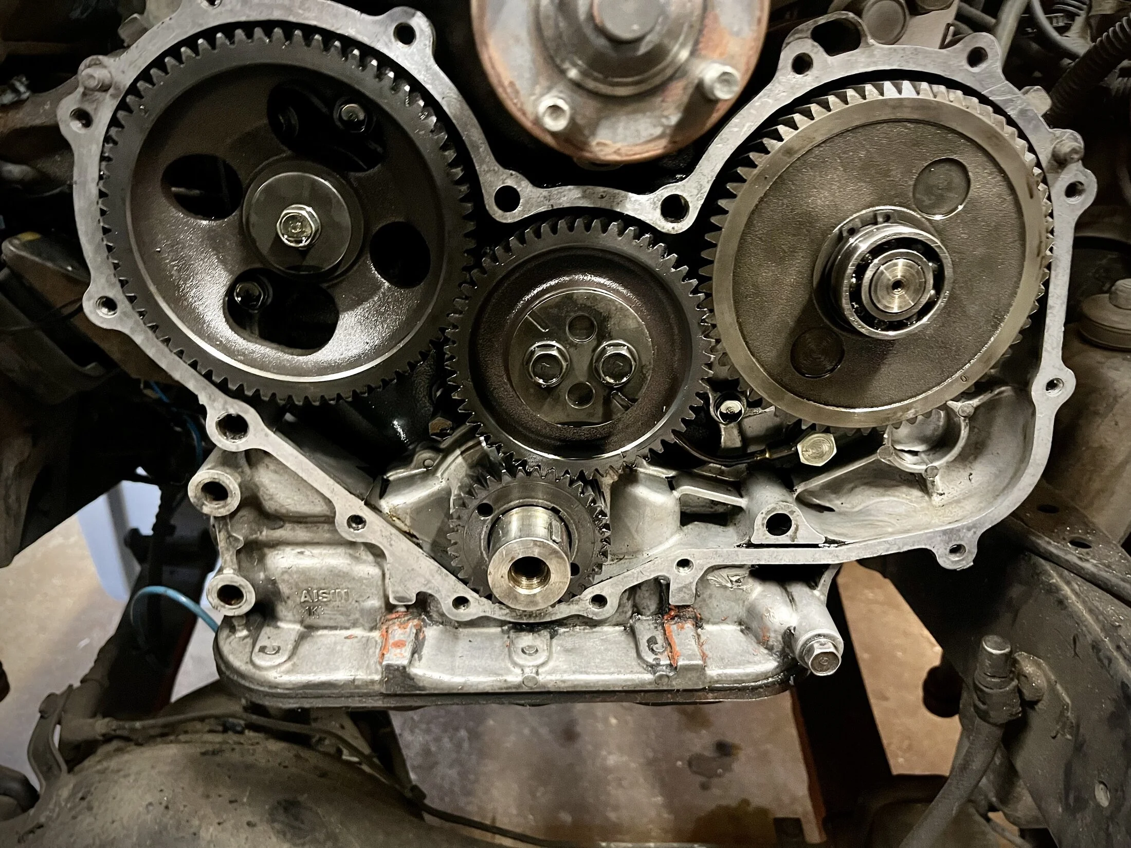

Tip: instead of heating up the front timing cover on a water bath, I just used a heat gun and slowly heated the area applying pressure with my hand until it popped right over the automatic timer.

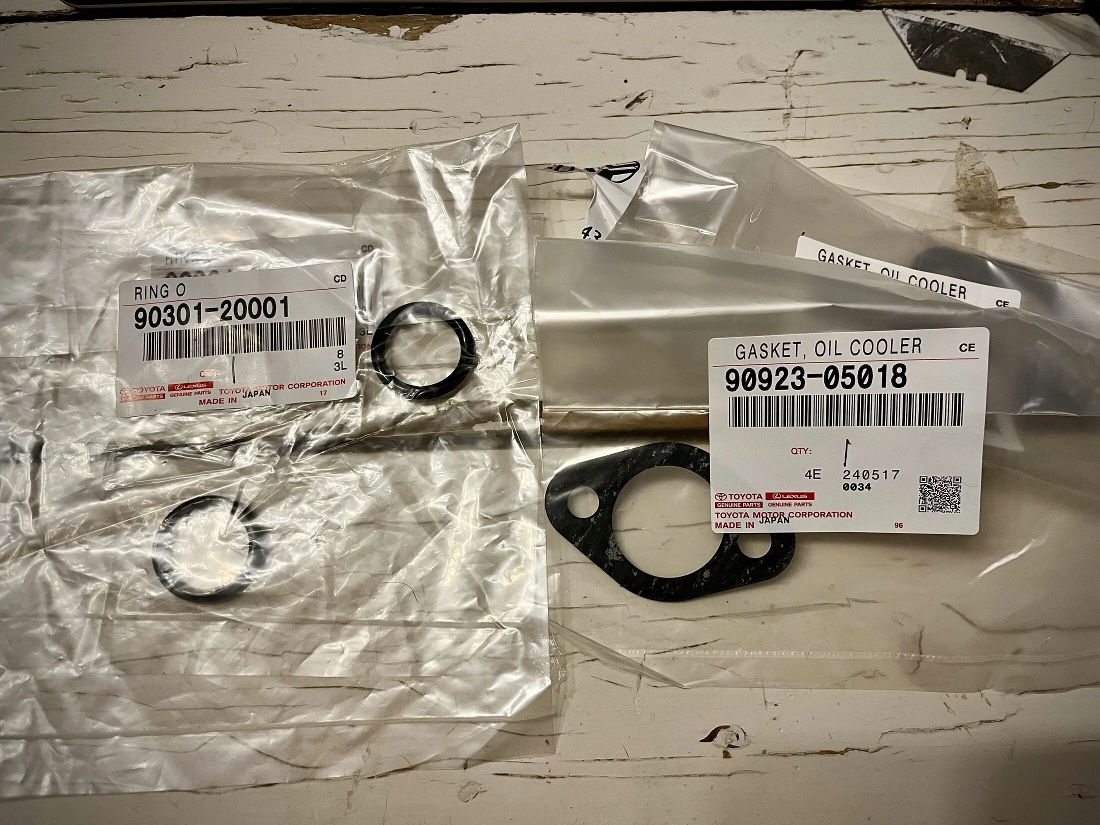

Got the oil cooler parts from partsouq. 1 week is what it took.

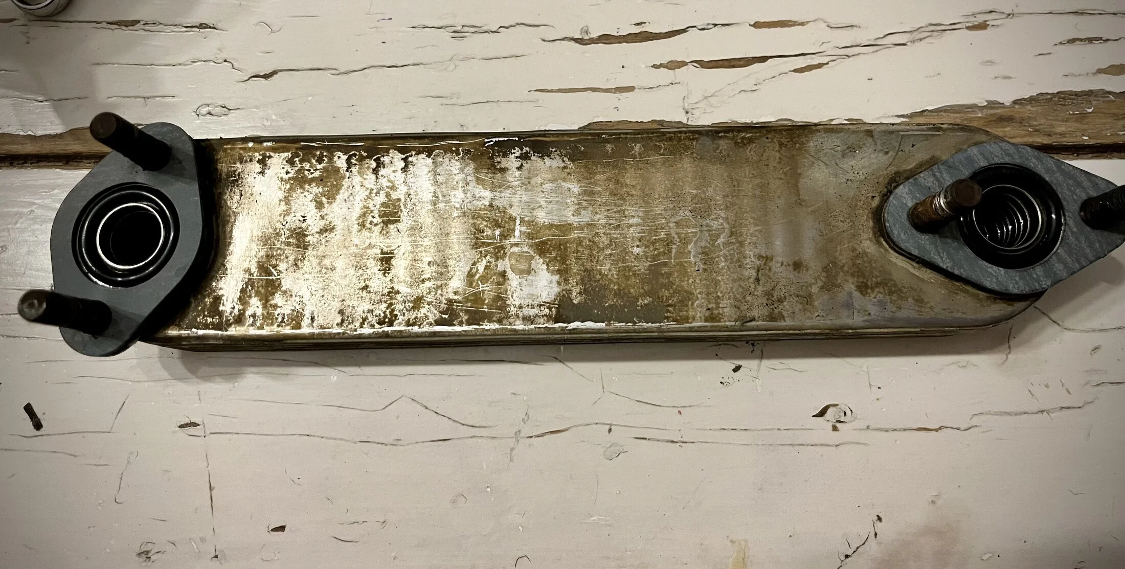

Here’s my made up gasket. This felpro rubberized gasket paper for oil. Not pretty but it fits. Hopefully no issues. I have this coming from Canada….whenever the strike is over.

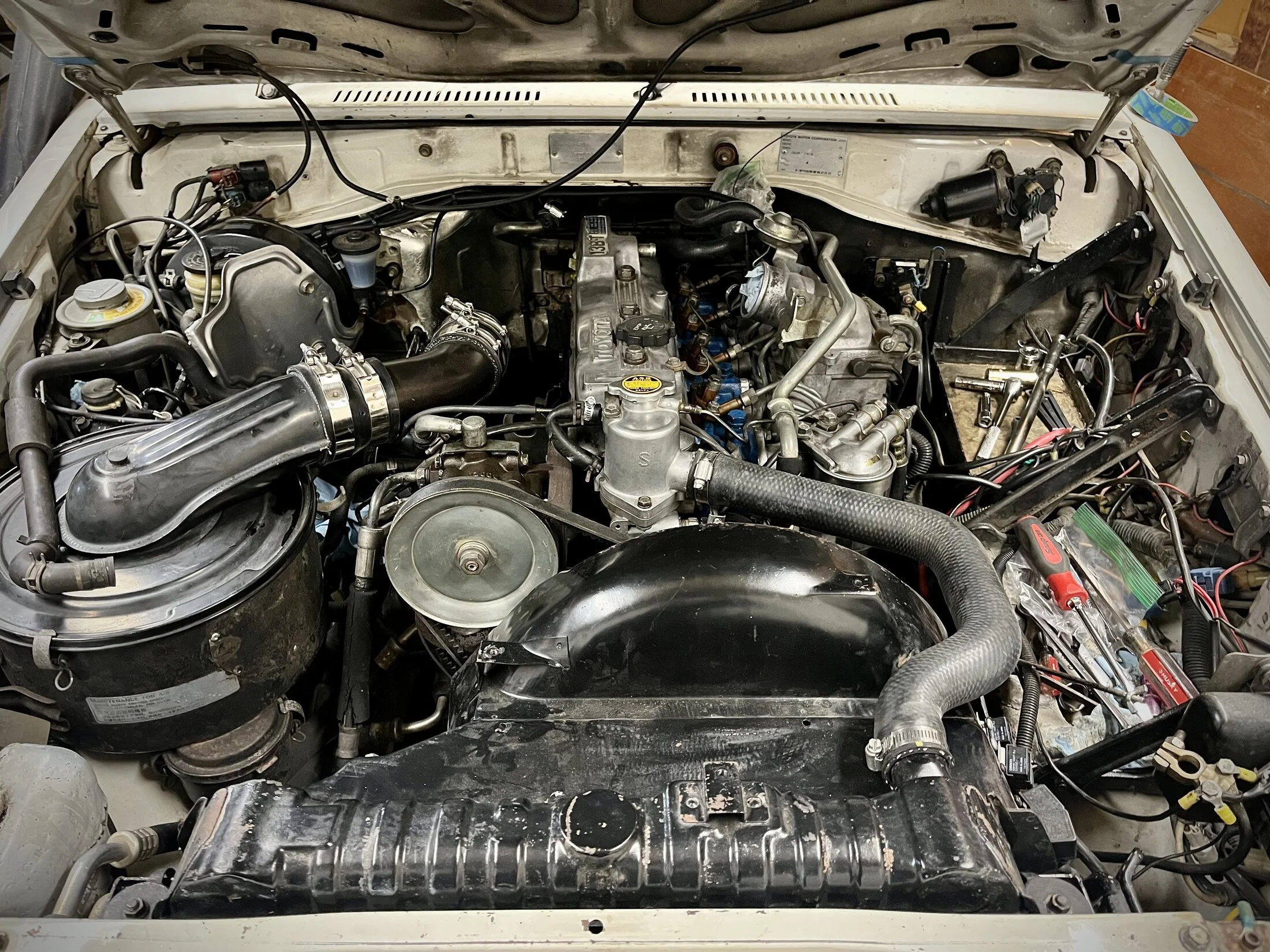

Now I should be able to put it all back together and get it back and running.
Steps forward….steps back.
All together
Houston we have a problem. When filling up the coolant, on the 3rd gallon, coolant starting pouring out the front. 😕. Looks like it is coming from the block/thermostat gasket. Cinched up tight, still leaking! Just draining out.
It’s a metal gasket, I assume crush, maybe I put it in backwards? Is that possible?
Anyway will Probabaly order another….
