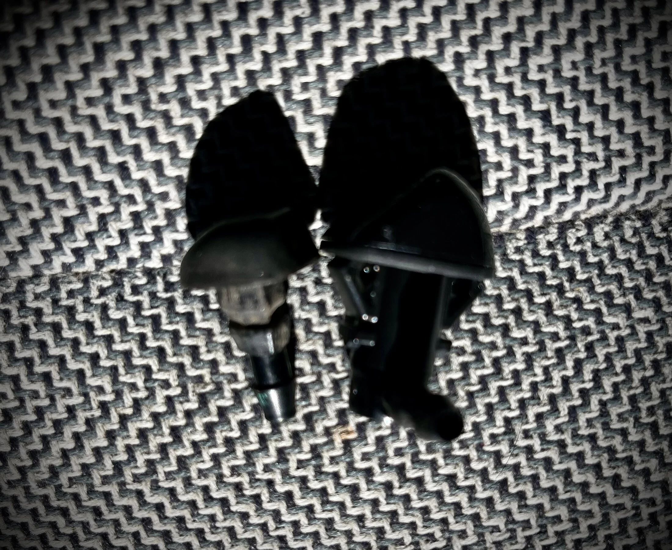

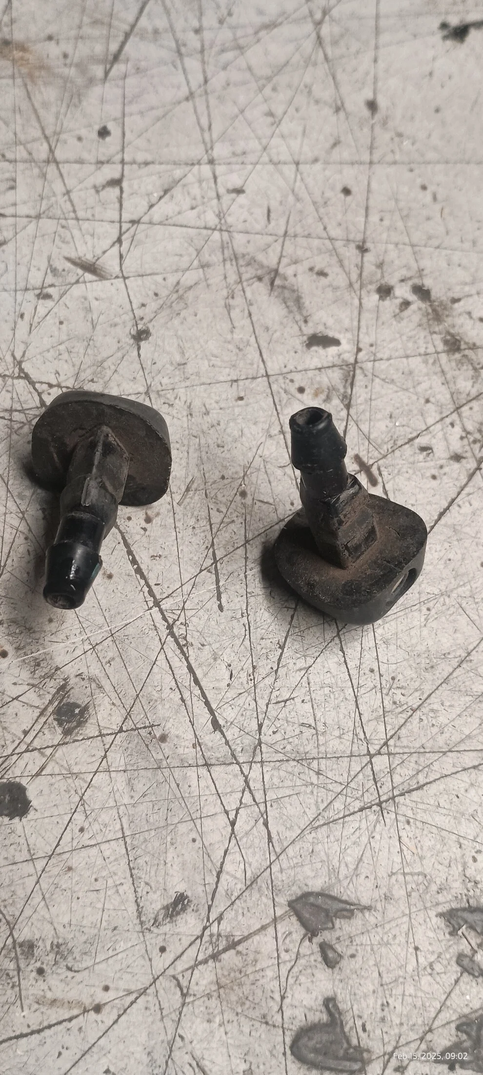

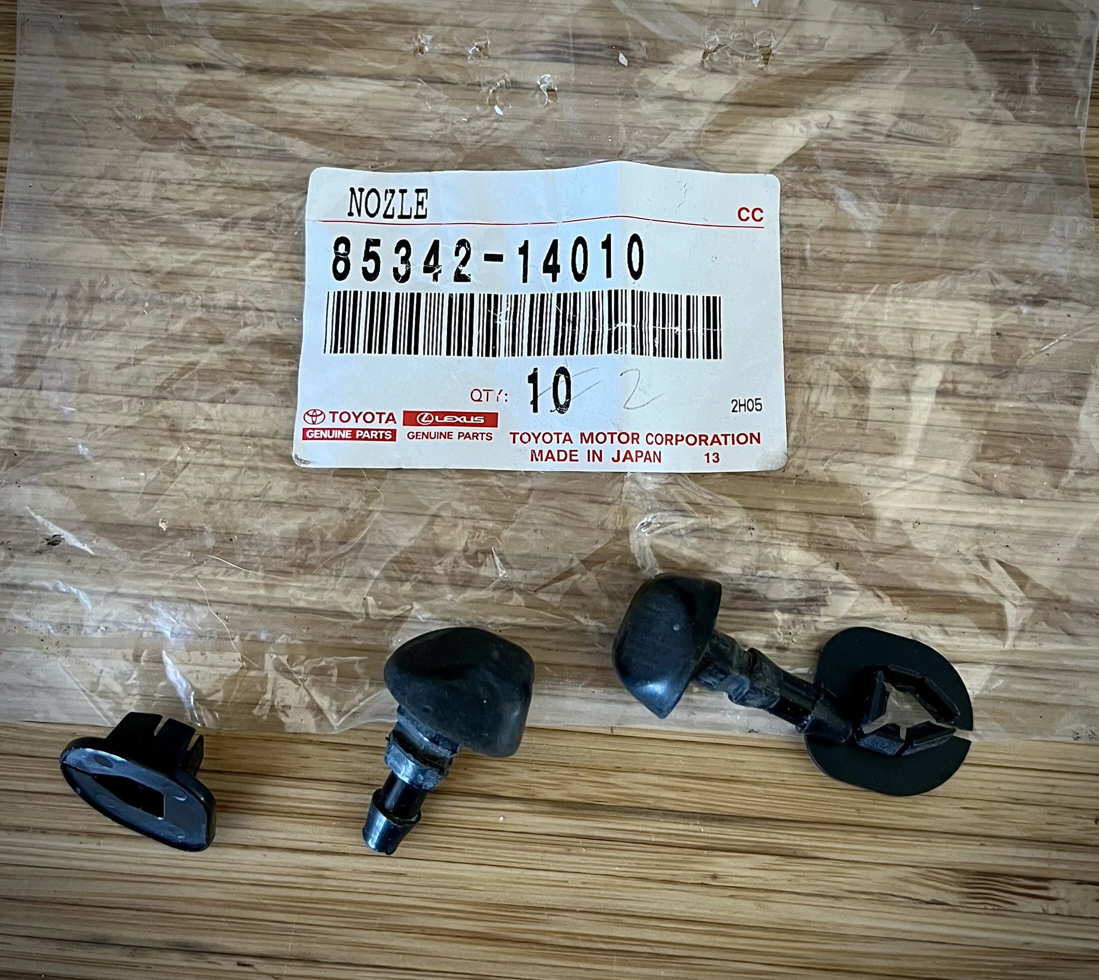

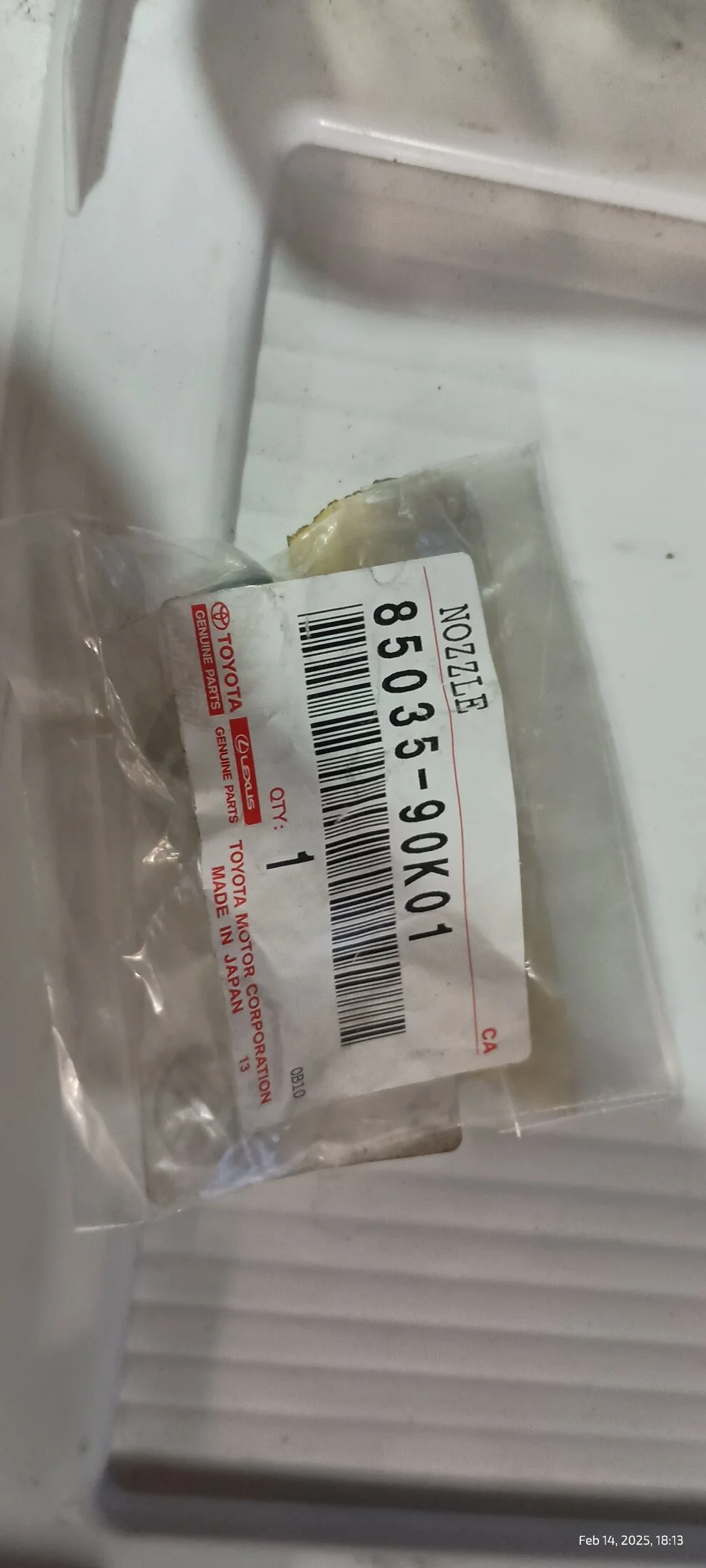

So broken windshield washer nozzle. Any fast/cheap part store replacemt?
Not cheap, but could be fast. I've got these that I've been holding onto because I don't want to destroy my hood insulator to install. They were $18.29 apiece.
$30 shipped and they're yours.

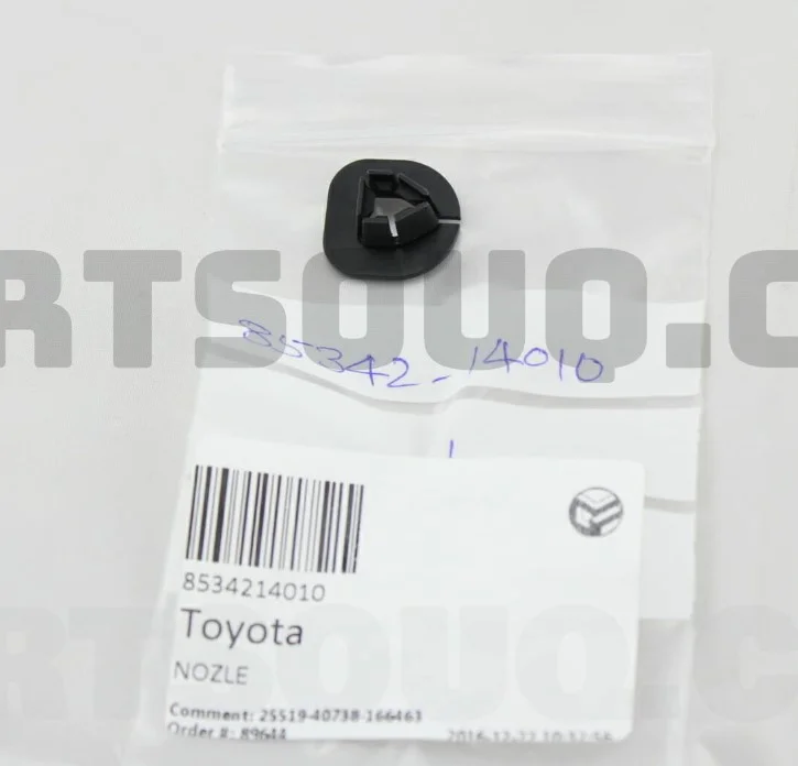

Early hoods have larger holes and use the bushings.

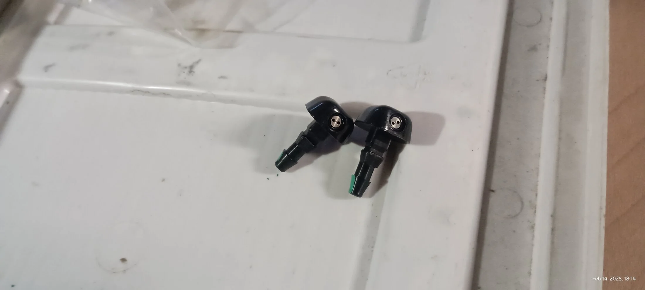

Easy fix, thanks to @Owyhee Jackass he hooked me up with some used nozzles and new nozzle holders.
Nozzle holder part number
I tried the Honda one, no chance of it fitting in the hood at all. Way too big.

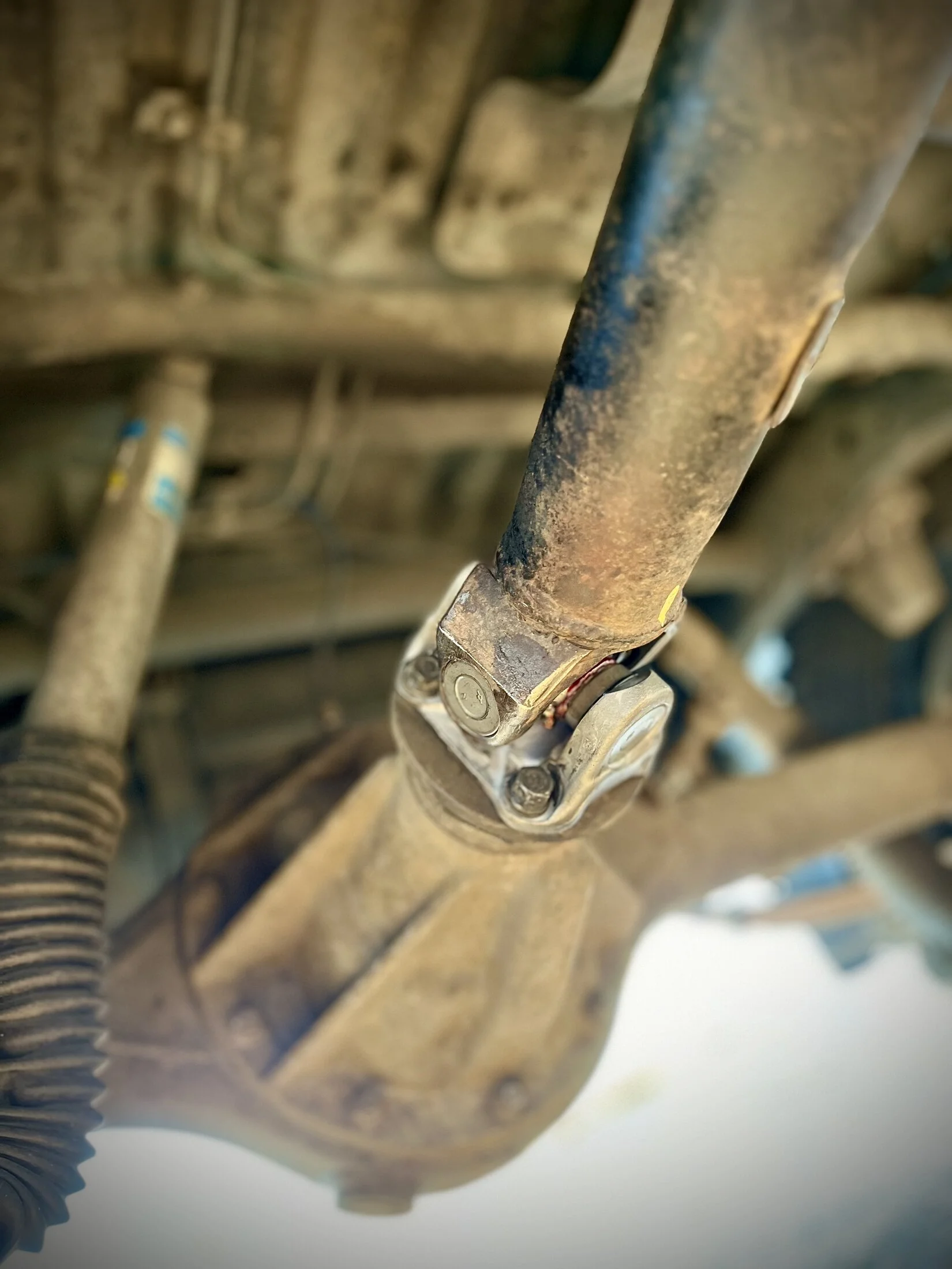

Also I was having a vibration above 55 that seemed to be getting worse. I could move the rear ujoint just slightly. Called up @cruiseroutfit and got another rear Matsuba.
I just replaced those joints 30,000 miles ago so I’m not sure why the one went bad. Replaced it and all smooth now.
