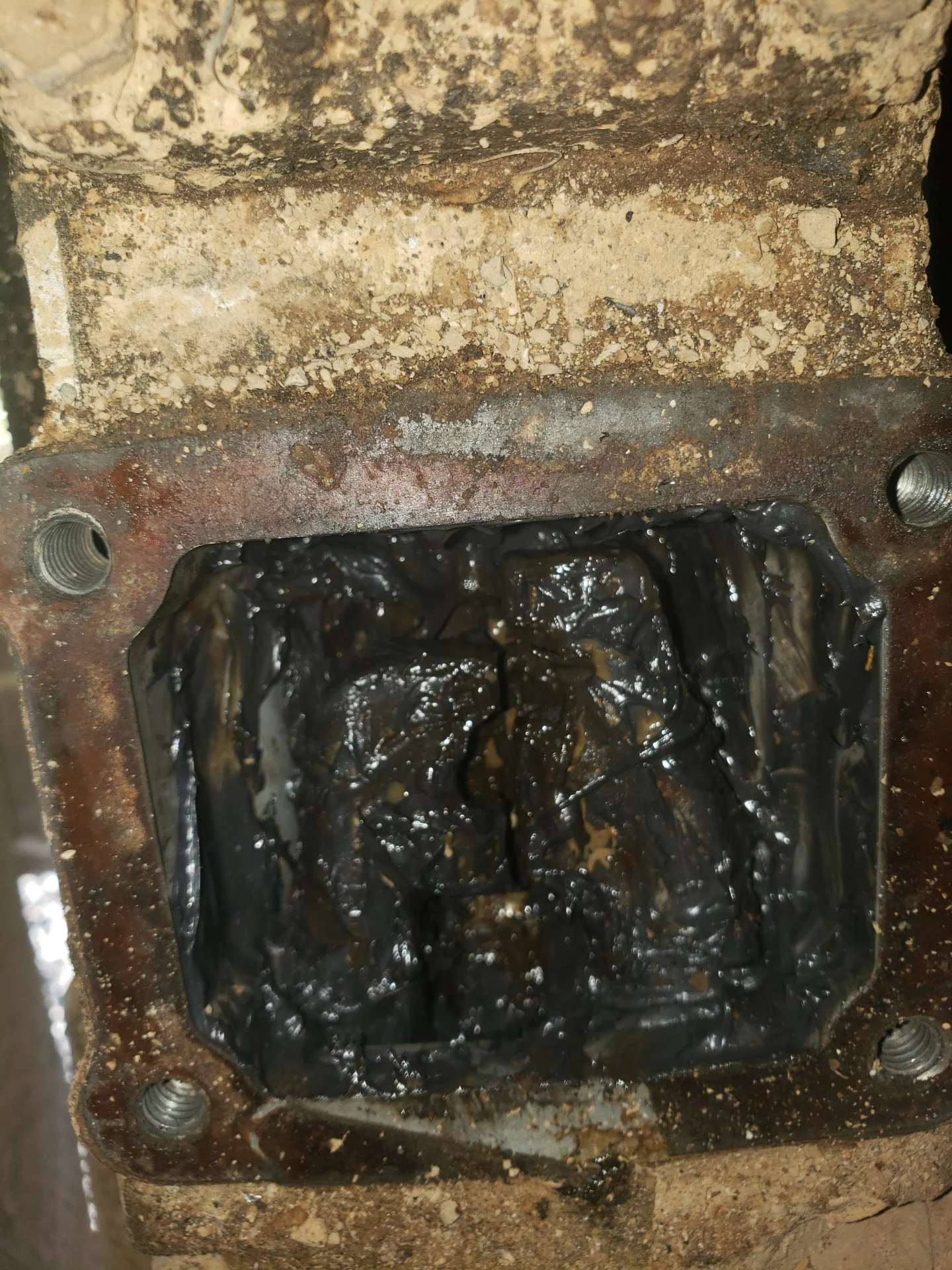

(Pic is from when I took the 4wd shifter off there is some mud inside the transfer case)
