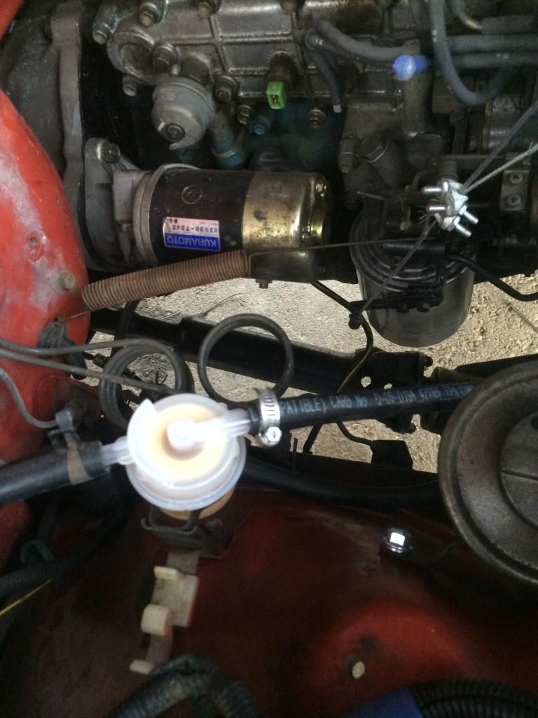

Got my new fuel filter installed, and changed the old rubber fuel hoses to diesel specific ones so they don't get dissolved in the diesel.

I also ordered my new priming pump which will be in within a week.

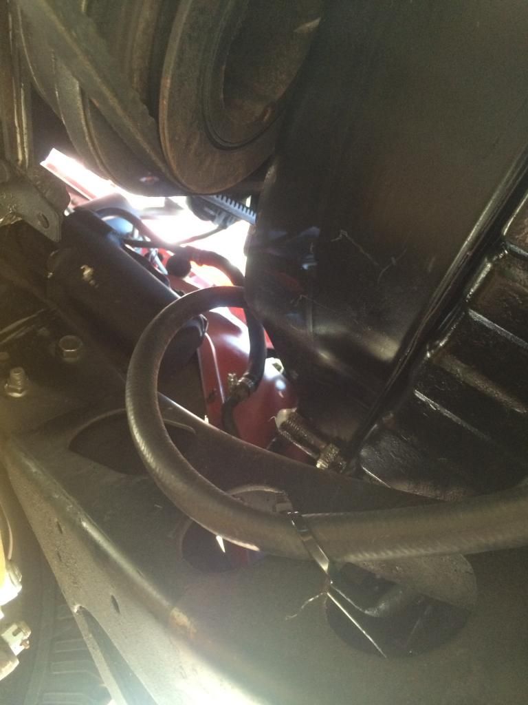

Next up is power steering. I'm picking up some low pressure return line when I get my priming pump. It's gonna take about 6ft of line to run from one side to the other.
My pressure line has been built, and should be in this weekend.

Is that just a generic plastic pre filter?
Im pretty sure it is. I got the part number from a guy at the shop who has it in his diesel. I just picked it up and didnt really check if it was diesel specific.
Any recommendations for a good pre filter?? Iv heard the metal mesh ones work really well.

Got the power steering completed!
