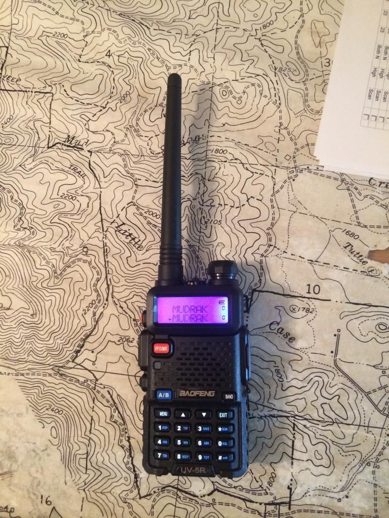

Got some COMS!!!!
Picked up a Baofeng UV-5R. Its an awesome little HAM setup. So far Im thrilled with it. I wanted something compact that didnt take up space in the cab or under the dash. This will probably live in my glove box, and only come out when Im on the trail.

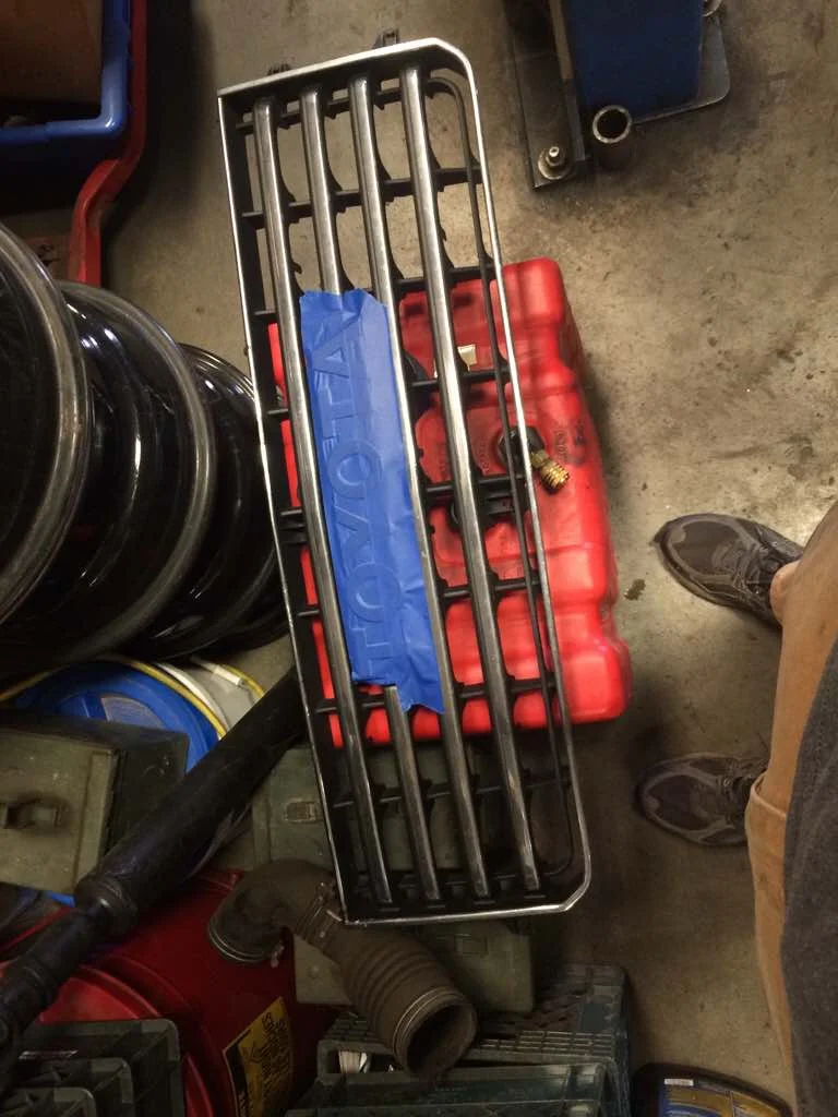

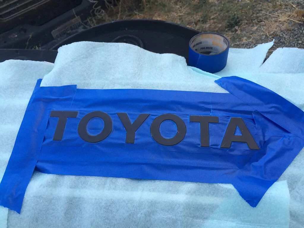

Got my Toyota Grill emblem painted white
Final product to come

Truck is turning out nicely and you will have to show some finalized pictures of the grill. Love that little Baofang and it is on my list of things to grab along with the data cable for the computer, extended antenna and the handheld mic that fits it. Utilization will be the same as you, just need to get my HAM license now.
