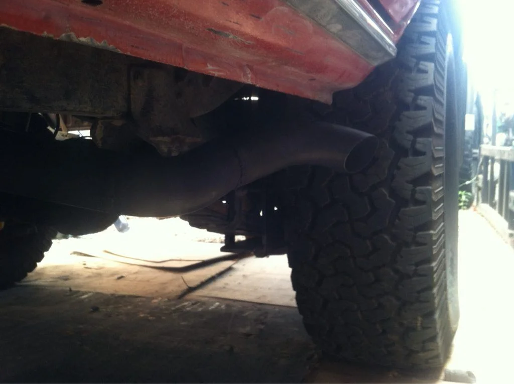

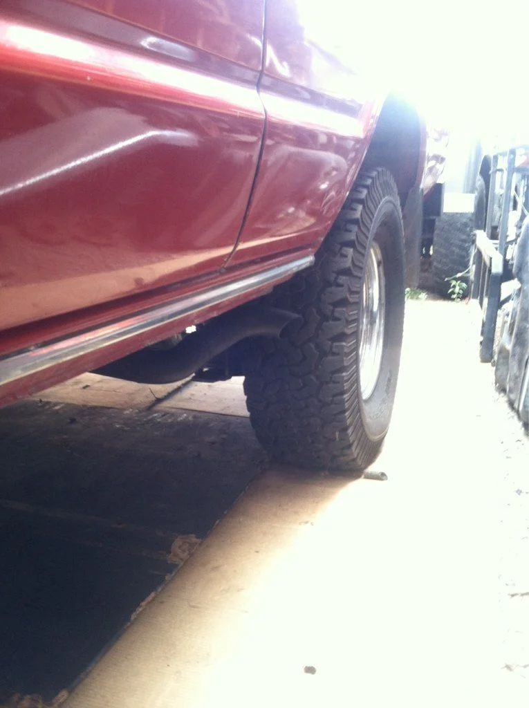

BUILT MY EXHAUST!!!!
Oh. And I taught myself how to MIG weld. Hahahaha
Please. No judgement of the welding. I can stick weld pretty good, but today was the first time I picked up a MIG. Don't worry, this exhaust is only temporary.

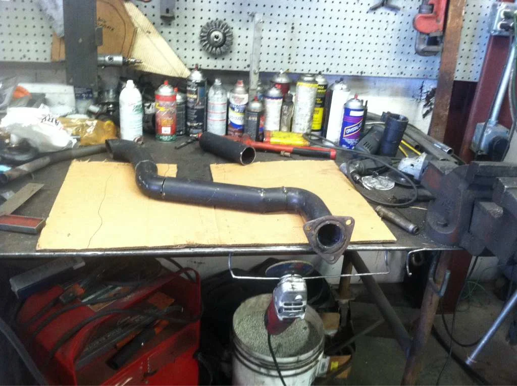

Got the exhaust laid out. Without a bender I had to pie cut, then bend, then weld. I know. It's gonna leak.

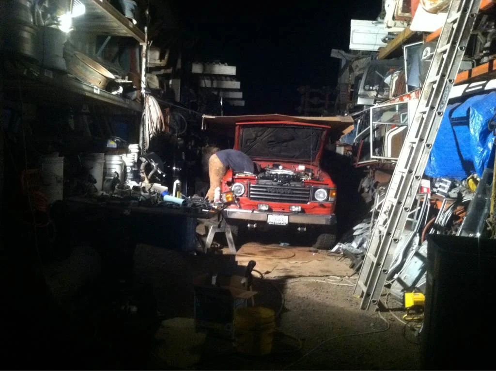

Here's what I got done today
Set up flood lights for night work
Cleaned up the ally and picked up all my old parts

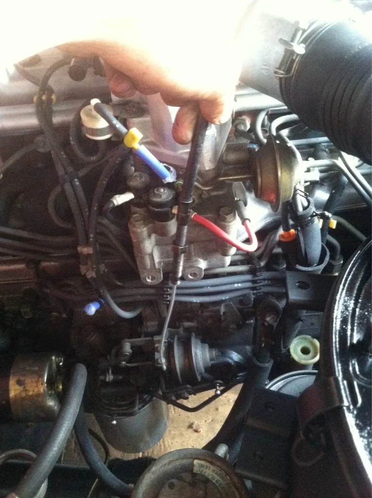

Drilled and seated the throttle cable
Mounted the throttle pedal assembly
Pulled the choke cable
Fabricated a bracket for the throttle cable
Fabricated an adjustable arm for throttle throw distance

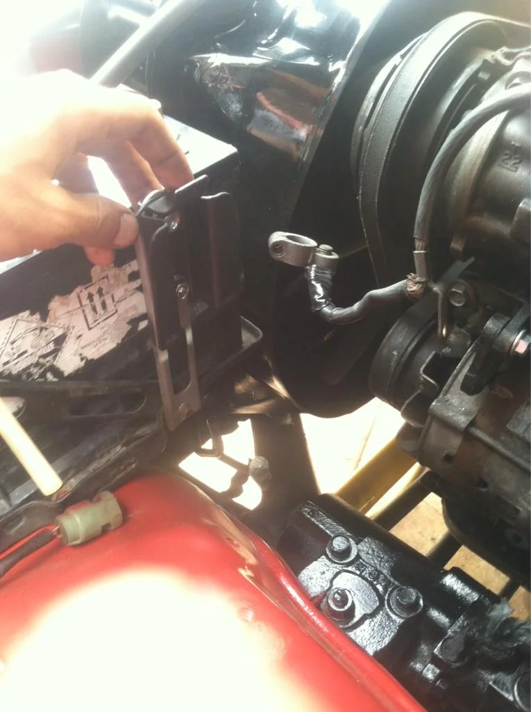

Made my own mount for my radiator overflow can thing
Got ready to wire everything up
Pulled power steering lines and took measurements for the new ones I'll have made tomorrow.
Bracket for radiator overflow

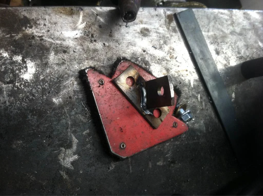

Throttle problem
Throttle bracket solution
New floodlights kick butt!

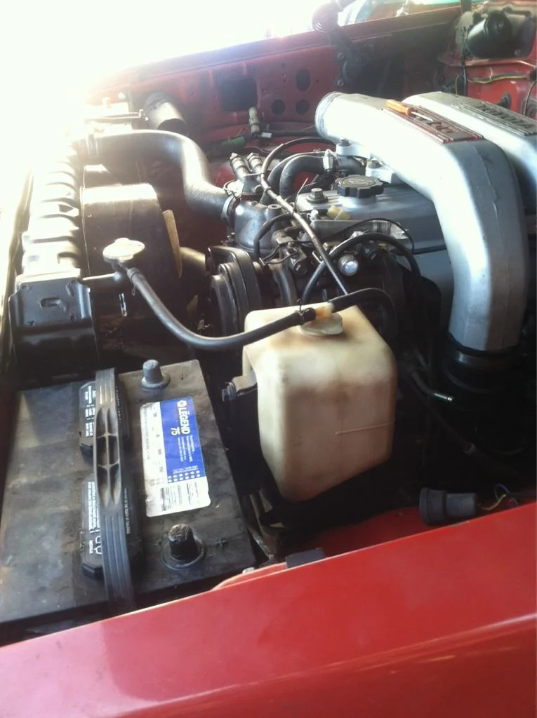

It sounds strange but I was more stoked on how the bracket for the radiator overflow turned out than almost anything else this week. It's the little things that are the most enjoyable sometimes.
I'll get a better picture of it with the reservoir mounted. It's perfect, and really adjustable. Made out of an old battery tray arm.

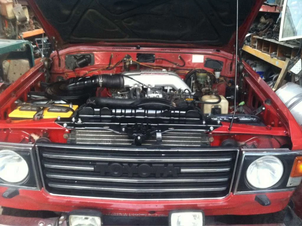

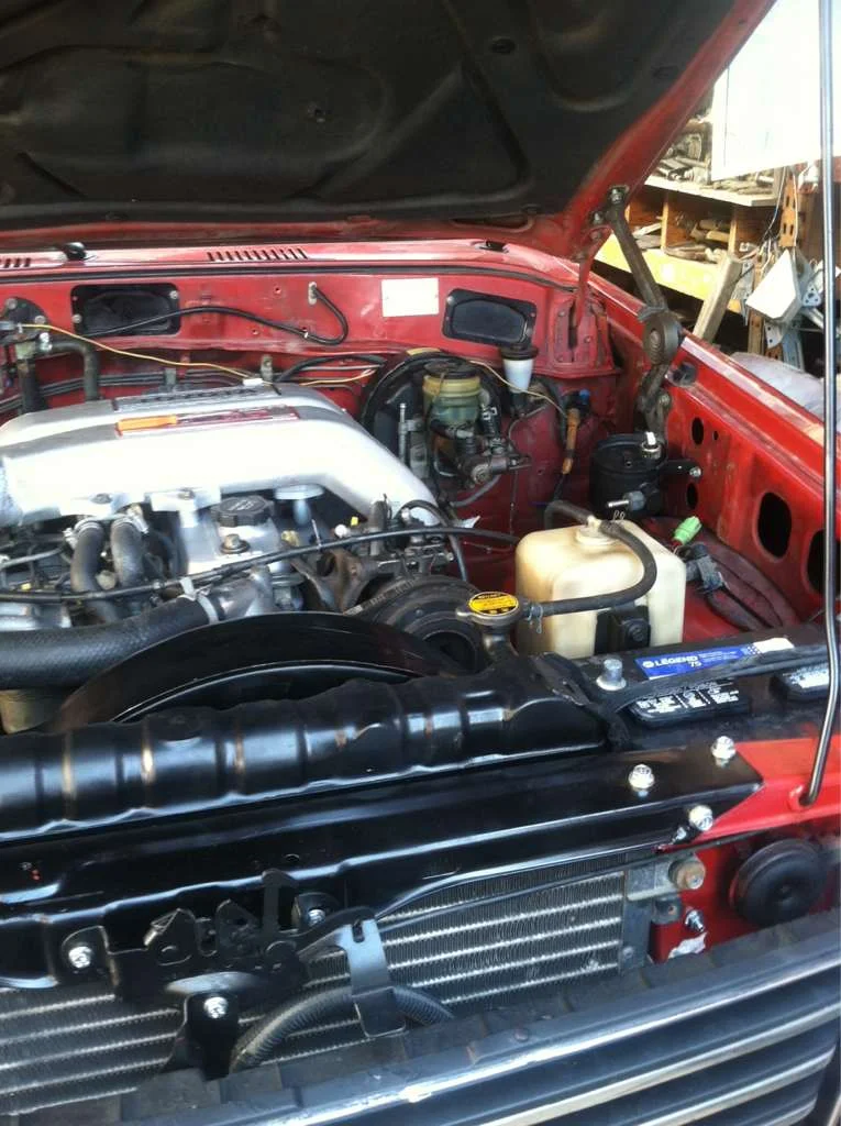

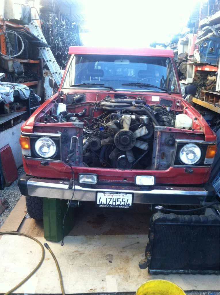

Then I put away all my tools, stored my leftover and spare parts, cleaned up the ally, pulled off the cardboard garage, stepped back, and took a good look at my new truck.

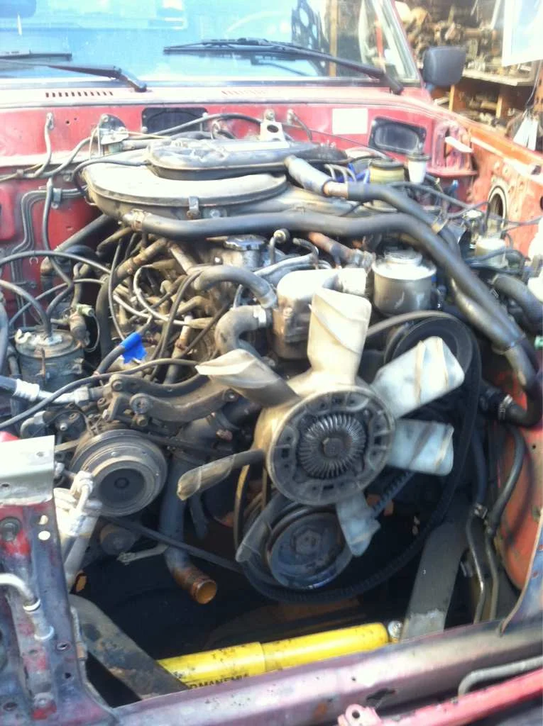

Here's that mounting system I was so excited about
Before
After

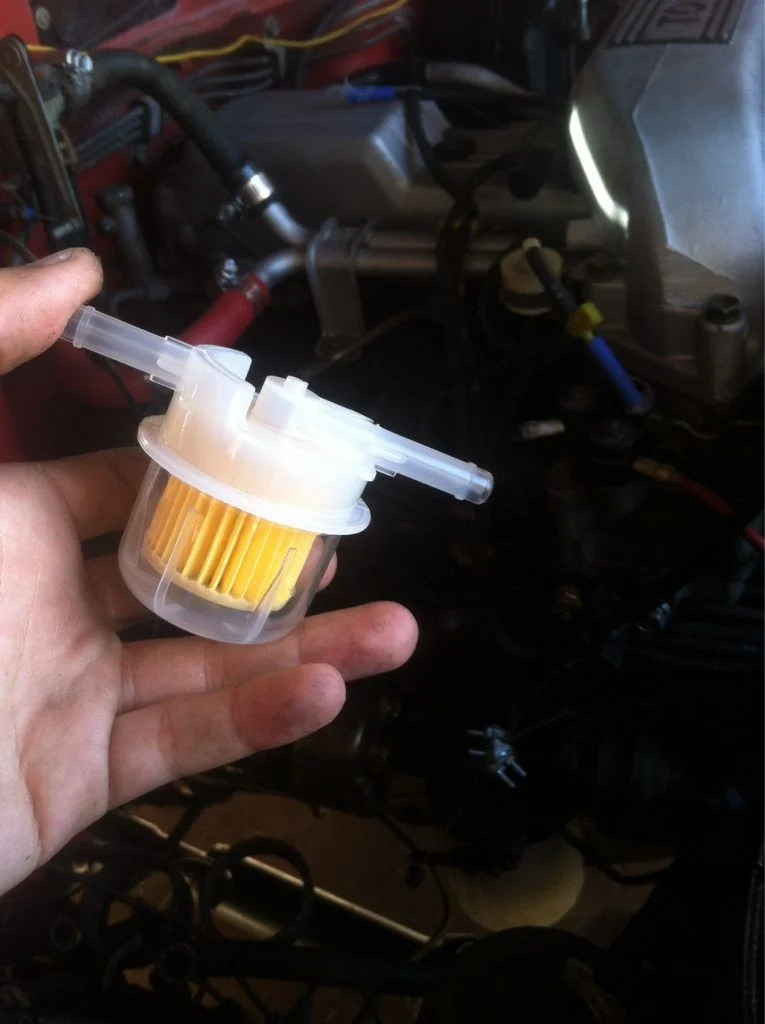

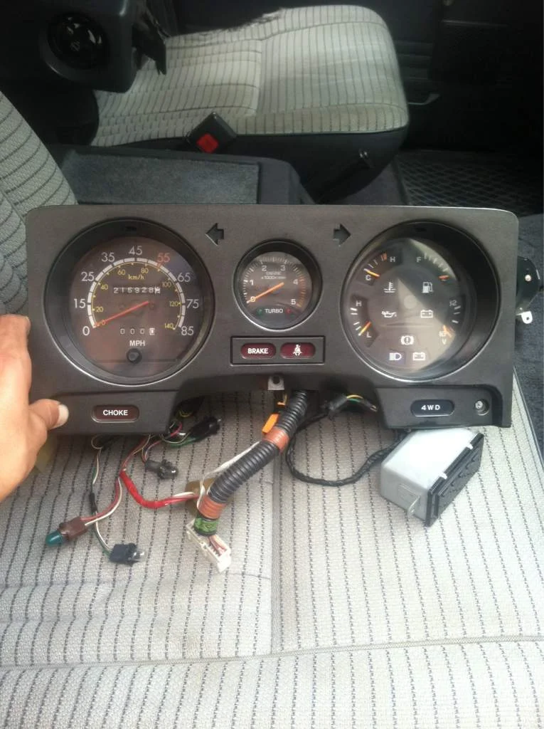

New fuel filter and modified gauge cluster
