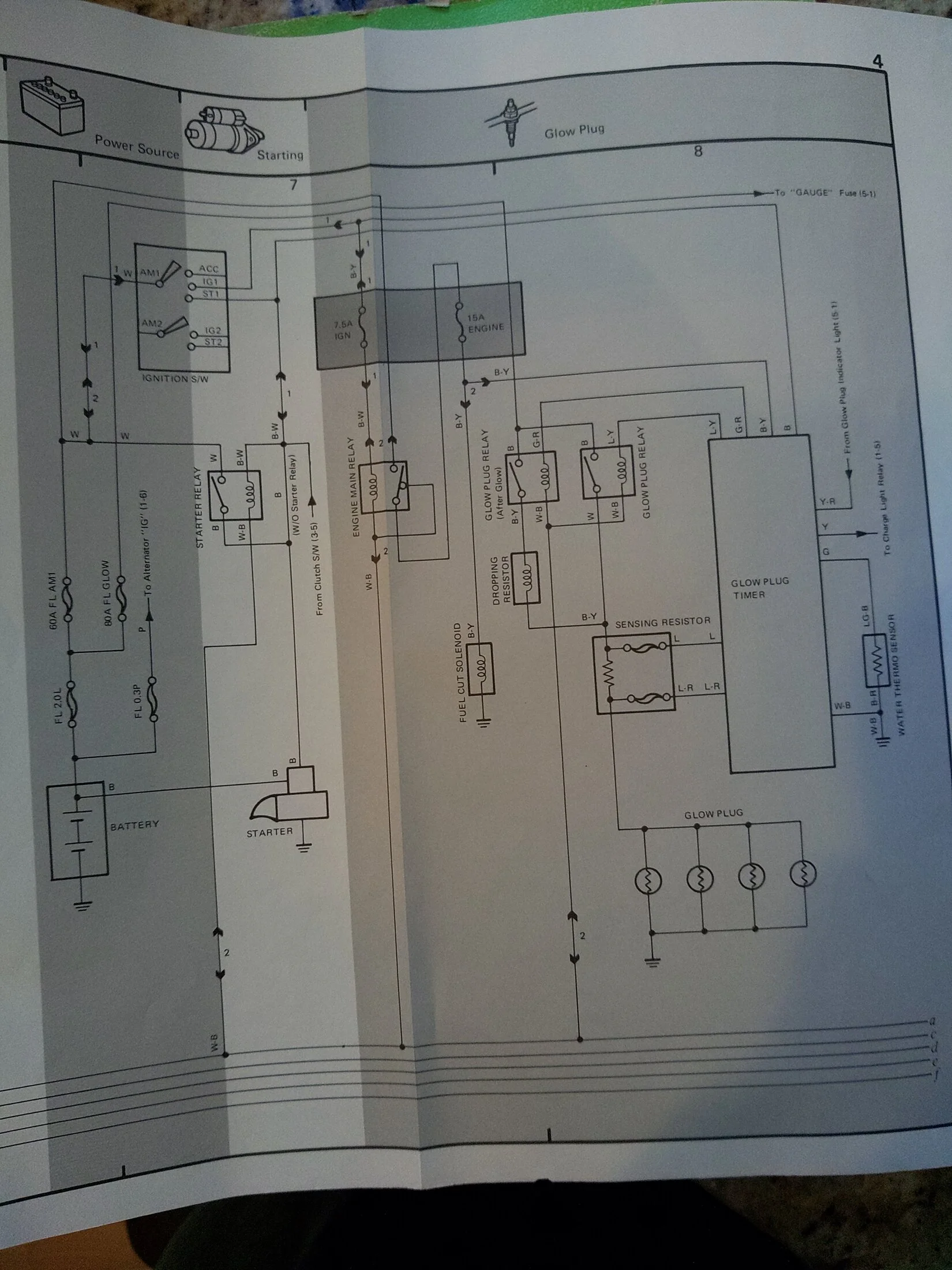

I spent some more time reading the wiring diagram for the system last night along with some forums on Wilson Switches and got over my head quickly. I'm not a total rookie with electrical and could probably figure it out but I need to do some more homework first.

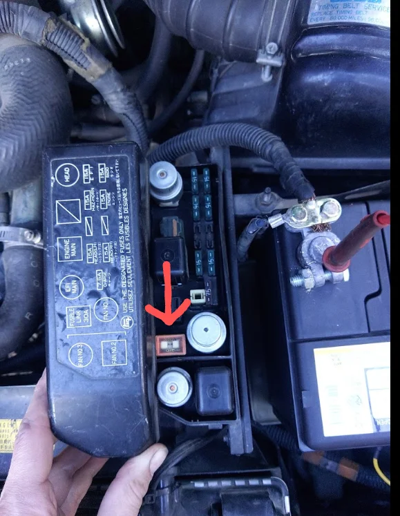

Check continuity across your fusible link FL0.3P, then with the engine running check voltage on each side of said fusible link. Sounds like your alternator is ok but you have an issue in the wiring between there and the battery. Also check all engine bay grounds for corrosion.
Thanks for the tip. I did my best to visually check the grounds but haven't removed and wire brushed clean. There is no visible corrosion but I should probably remove and clean the grounds.
** Edit.
OK so I checked for continuity across the terminals of that 30amp fuse thing like you suggested.....It does have continuity but sort of rattles when I shake it
- I checked from the fuse terminal to the B+ of the battery and I had continuity briefly but then it cut out
- I checked continuity between the alternator and the fusible link terminal and no continuity at all...hmmm

Are you talking about that 30amp fusible link thing? I wonder if I should just replace it , IDK how common of a part this is, something a local auto store has a replacement for?
