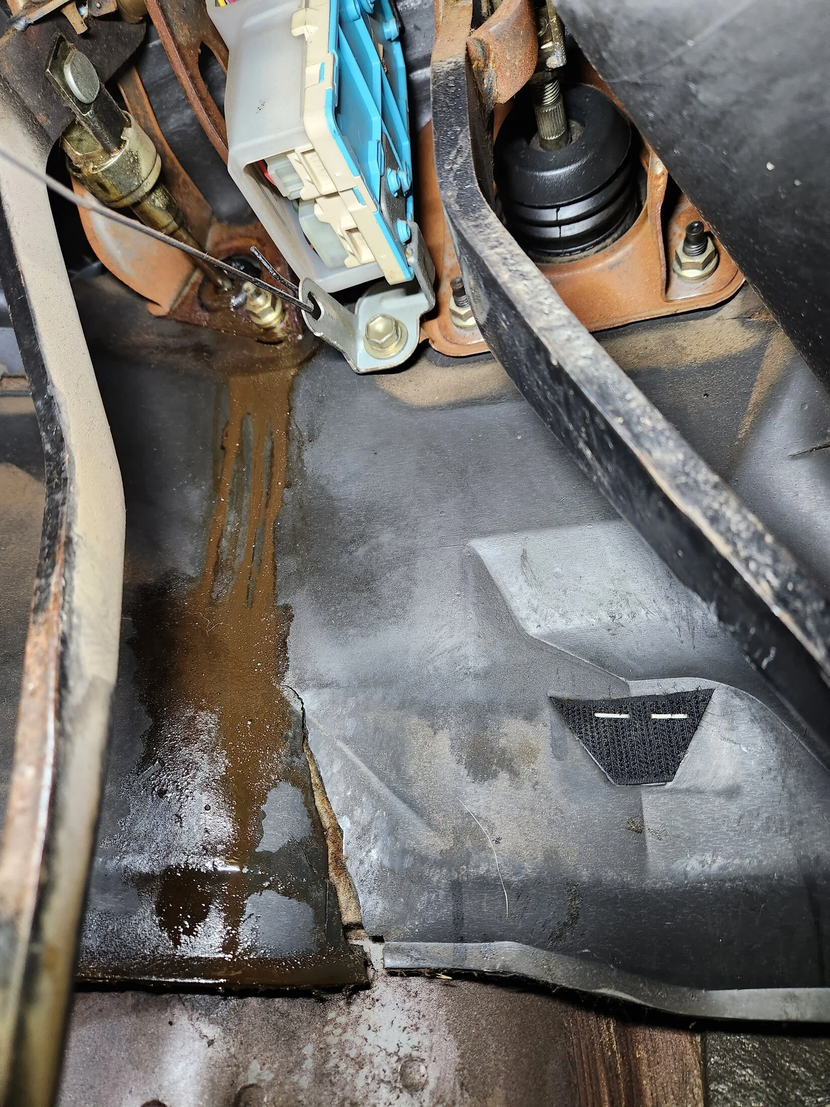

To make life a bit more depressing I lifted up my carpet yesterday to run some wires and was able to see clear through to the ground outside lol. There was a decent bit of rot about 3 inches wide surrounded by not much rust at all. Maybe water pooled up and it sat for a while, who knows. Will post more pics later and most likely going to slap some duct tape on it for now and move on lol
Oh I also noticed like some rusty oily goo seeping down from where the clutch lever dives into the firewall. Will try to look a bit closer this weekend

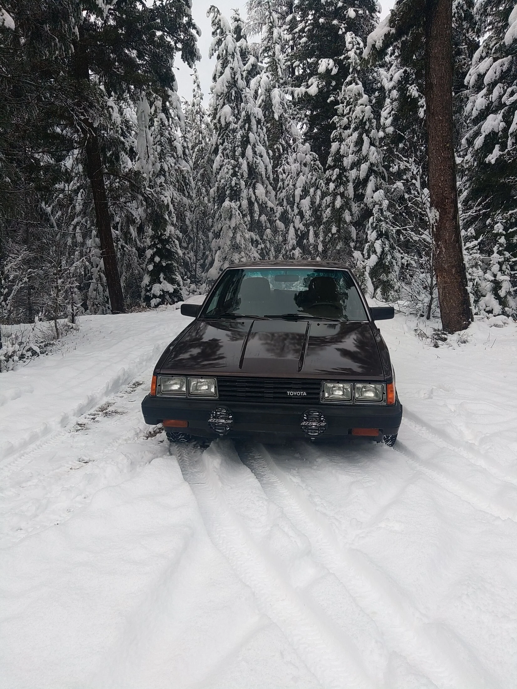

Its a rally car now ....I wasnt thrilled about changing the look of the front end but dodging deer with the original headlights is not ideal
Will add more install details when I get on my computer
Oh and I found this rotted out floor . My guess is there used to be a rubber plug in that circular area. The plug fell out and water/ debris got in. It probably sat all wet and nasty for many years and eventually started to rust. Luckily everything else around it still feels solid
.I Flex Tape and Flex sealed the s*** out of it and moved on. Not proud of it lol but it works
My wife kept saying it smelled like wet carpet but I was in denial
Not sure what this is , clutch poop

Clutch poop = leaking seals in the clutch master cylinder.

Roger that, thanks. I checked the little reservoir under the hood and it seems to be up to level....Yeah I'm going to just ignore these issues for now. Winter is here and the car drives from A to B just fine. Come spring time I will have to start thinking about it again.
