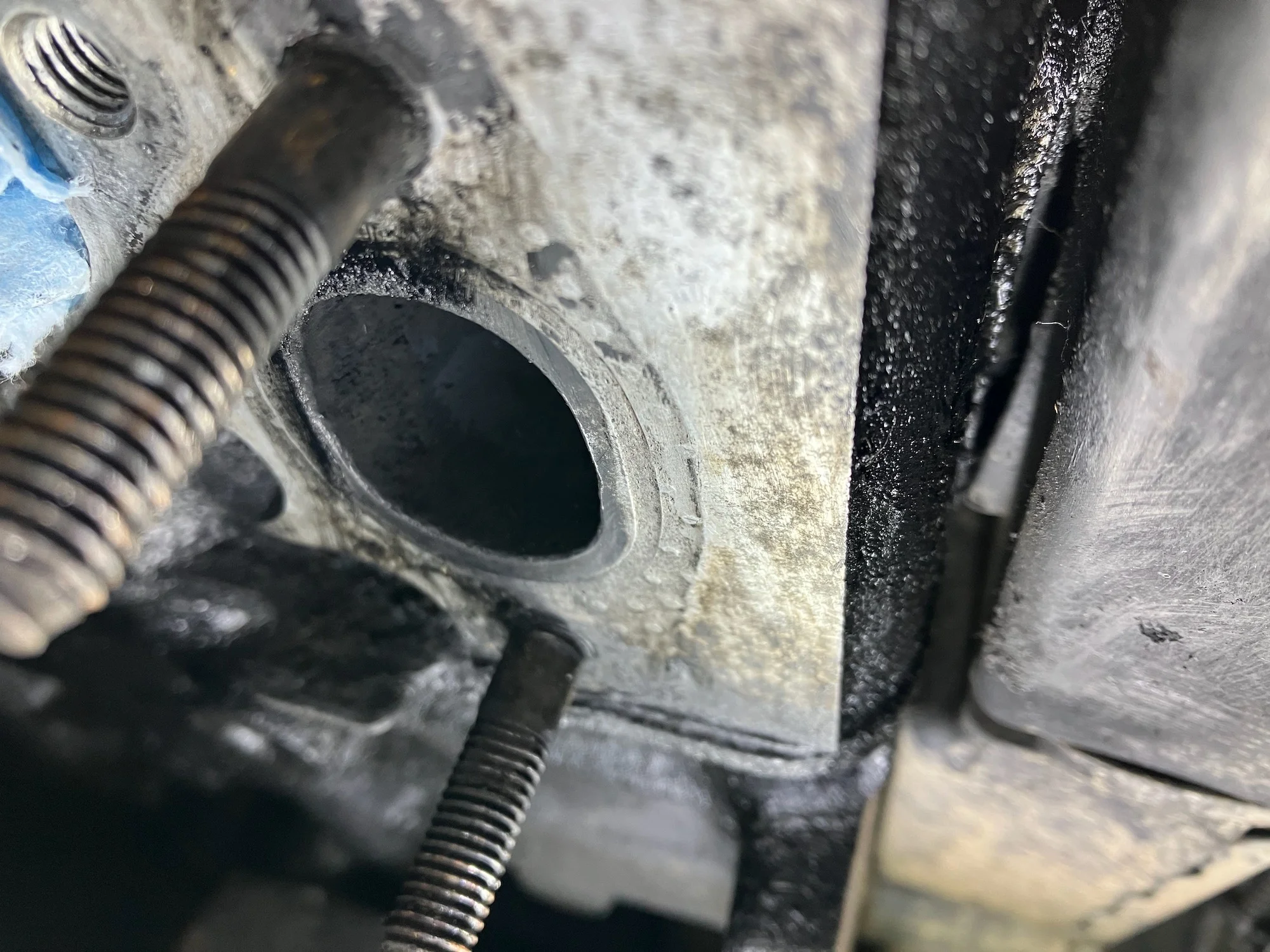

Taking a closer look at the head this evening and I was able to get a decent photo of the #1 exhaust port, this is the one that I suspect to be leaking due to a bit of wear around the port. The first gasket failure was due to the manifold nuts loosening on the #1 port, causing the gasket to vibrate like a reed under engine load and wearing a slight groove into the head. It isn't super deep, but I can definitely feel it with the tip of my finger and my finger nail just catches.
Do you have any more material options for this gasket? Something that may seal against a less than perfect surface compared to the MLS?
Looks like there are graphite composite gaskets available that would fit, seems like that would probably seal better on a damaged surface.
Is the manifold flat with a straight-edge check? If not get a machine shop to face it. MLS gaskets are used because they're the only thing that lasts and allows the movement necessary.
