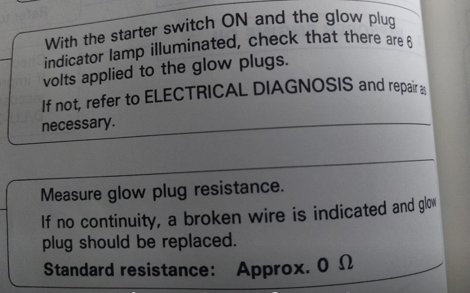

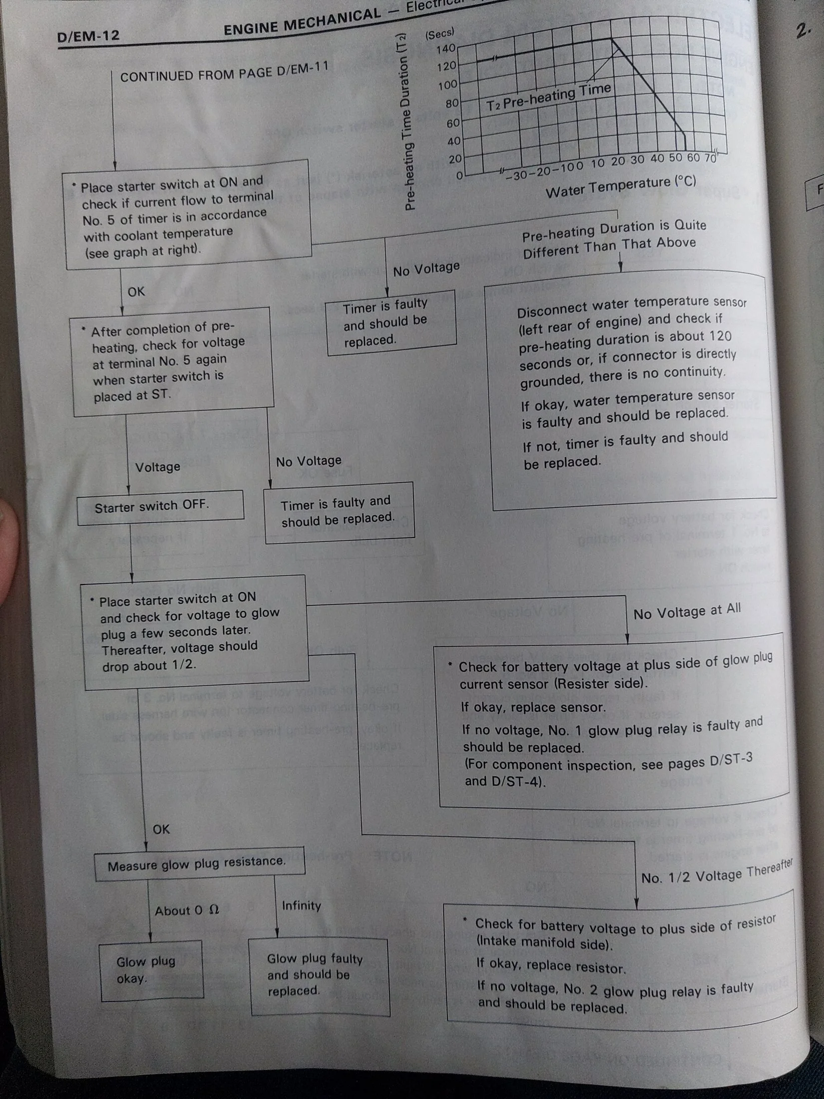

Forgot I've got the service manual for this motor.
Relevant info below.
OK so I put a volt meter on each glow plug. With the key in the on position they seem to be getting power. Starting around 2V and slowly climbing. I let it climb to about 4v and that took like 5-10 seconds. Manual calls for 6V which I expect it would have gotten to eventually
I think this sort of tells me the system is working but maybe the dash light is the problem. I'm going to ignore it for a while and see if it fixes itself
Something seems off with that; pretty sure the glow system should provide 6v right away and then taper off.
haha, self healing cars are rare! you want fresh hot glow for beautiful crisp ignition.
Fingers crossed lol
Shoot, I was hoping the dash light was just acting up... s***... I'll poke around a bit more and see if anything stands out .
Check earth (grounds), check your relays as per the FSM.
There is a chap on the 70 Series forum who diagnosed bad resistors on the glowplug controller, that may be deeper than you want to dive in.
