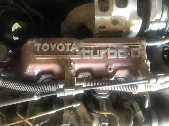

I believe the engine model is the 1C-TLC

How does this motor get fuel,where is the fuel pump,how is it powered
Injection pump is rotary VE pump.
VE pump design is licensed from Bosch, they are used in a load of cars & light trucks from Toyota, to VW, to Dodge Cummins, to Mitsubishi . . .
Pump is driven by the camshaft timing belt.
Timing belt, i would guess would be a 100k km service interval.
This means swap the belt, the tensioner and idler pulleys, and tensioner spring every 100k km.
If the engine hasn't been touched in 5 years, it would be something to swap regardless of mileage.

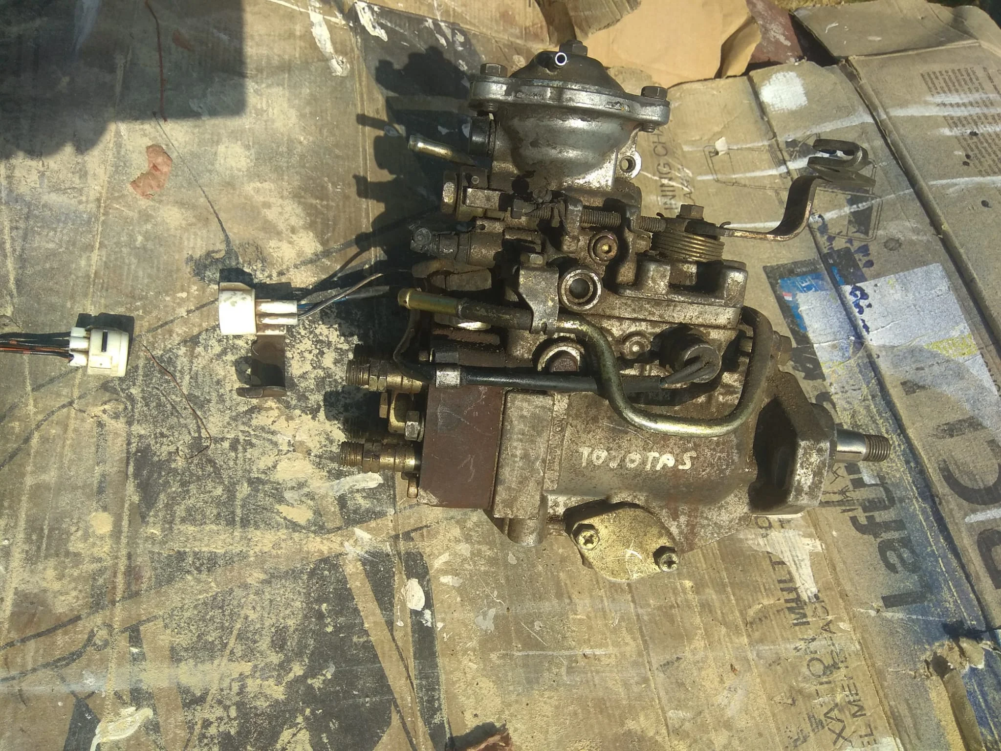

Here is a fuel pump from a 2C-T, which is the 2 litre version of that engine.
It is Toyota's first generation of rotary injection pumps (alongside the L and JDM 3B) and probably the first turbo diesel. The design was unchanged until about 2000ish. Probably the last part of the engine you need to worry about.

Alright so give me some general diesel knowledge. I know a little bit but curious of stuff like :
- What rpms would a turboed motor like this be happy cruising at ?
- What do I do in the winter time with fuel ? It has a block heater which is kinda cool but he says it's not necessary to use most of the time
- Are you swapping fuel filters often or can they go for a while
The 2C-T fuel injection pump is rated to 2400 rpm, meaning the engine can theoretically rev up to 4800 rpm. I would imagine something like 2500-3500 rpm would be the sweet spot before it gets too noisy and loses efficiency. Unlike a petrol, peak torque in a diesel (especially a turbo diesel) should be much lower than the redline. Maximum efficiency is probably around this engine speed.
In cold areas, winter diesel should be sold as standard at the pumps, so no need to worry too much I would say.
Fuel filters are changed somwthing like every 25,000 km but there should be a float sensor in the fuel filter housing to tell you if the sedimenter needs draining. If the tank is rusty inside (not so common in a diesel as a petrol) or full of diesel bug muck (unlikely in MT climate) you may have filter problems. Otherwise, not really an issue.
The only thing I would really check before a long journey is the cooling system - make sure the thermostat works, the radiator flows, the radiator cap seals and that the hoses are not deteriorated.
