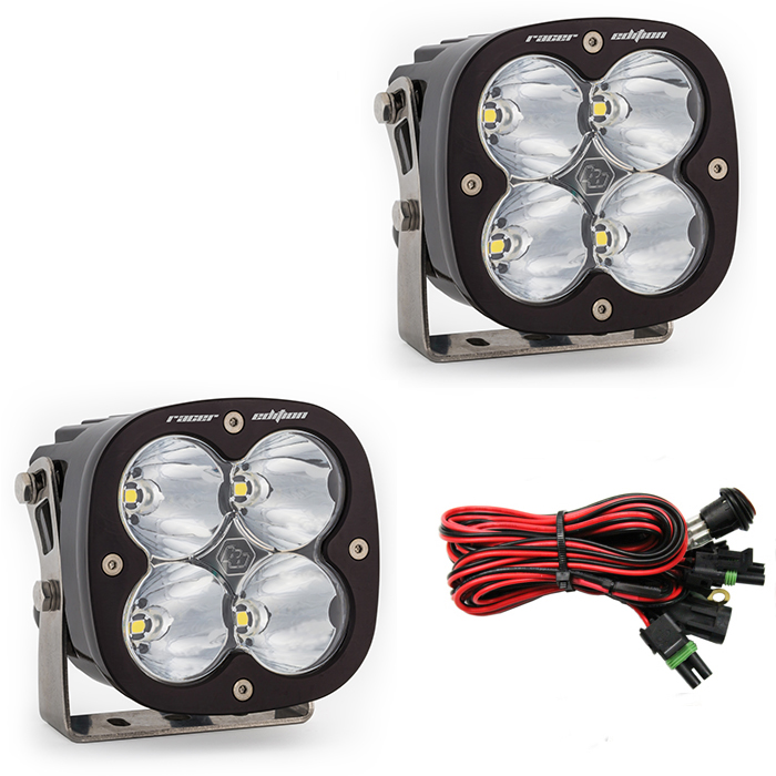

Thinking the next task will be to get a new voltage regulator and replace the battery/alternator/starter cables with some 4g welding cable. Might also redo the headlight wires as I'd like to go to a higher wattage bulb. The pattern on the Hellas is great but currently wishing for brighter light output. I have a set of IPF driving lights I may throw on as a suplement or I might also put a set of these bad boys on to really boost the output:

Headlights. My Hellas pattern is great but the base bulbs just are not bright enough. For now I’ll upgrade the harness and bat cables and then go to a stronger bulb. Probably get some Baja designs LED lights on their too. Eye strain due to low light is an amazing energy sapper.
