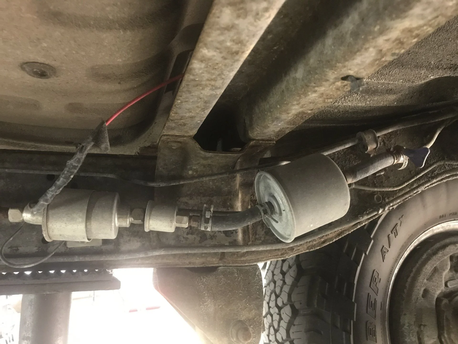

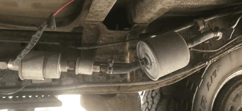

When I first got my 60 a couple years ago I could hear a pump go to work every time I turned on the ignition and this I found perplexing because I knew it was stock mechanical. I also had a suspicious single red wire running out of a hack splice on the front of the fuse panel. Eventually I spent some time looking and found the red wire went to power a pump mounted on the inner passenger side frame rail. I unplugged the pump and noticed no difference in performance.
So on thursday I finally had some time to remove all these bits. I wasn't too thrilled to find that this hack job of a repair had cut the factor hard fuel line. I put in a piece of fuel hose for now and will replace with hard line eventually.
So why was this there? I am pretty sure that at some point in the past the original owner started having a hot start issue (because the carb cooling fan wasn't triggering on because the wire to the sensor was broken)....so the previous owner took the truck to some random garage and that guy said...well sure you have a vapor lock problem. I bet I can hack up your truck, put in $50 worth of crap components, charge you some money and not fix the problem. Needless to say at least I've removed all this crap now.

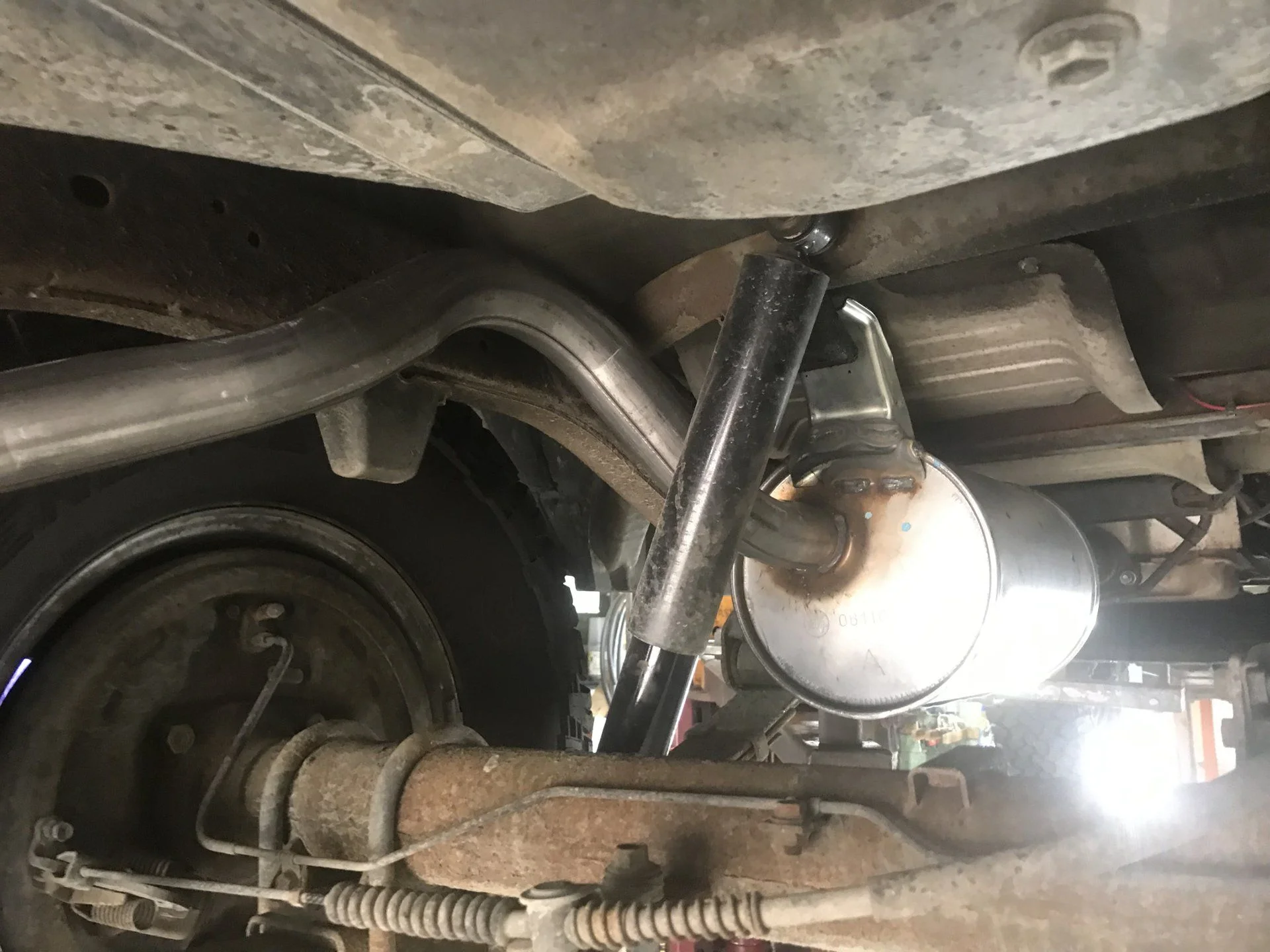

The main task of the day was to install my new Toyota muffler/tailpipe combo and that pieces is all in now. No real drama here other than I learned about the rubber isolator blocks because both of mine were toast. So I had to bolt the exhaust in place with a spacer until I can get the new proper cushion blocks in place.

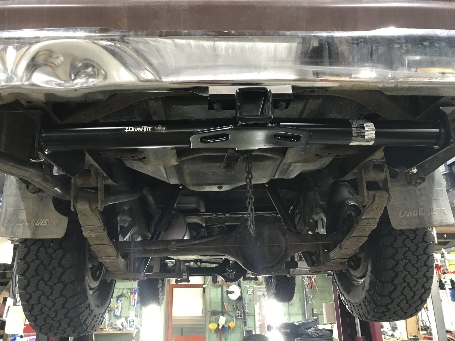

The last project was putting on the trailer hitch. This is a class III hitch made by Draw Tite and its not designed for an FJ60 but it lines up with two of the bumper mount holes and two of the frame holes. I drilled 4 1/2" holes to align with the remaining mount holes on the hitch. I also used 2 fender washers on the fore and aft most bolts to space the hitch away from the frame and the factory rivets. We found a piece of scrap aluminum at the shop that worked to be the correct spacer for the under bumper mount and I reused the two tow hook bolts to mount into the bumper holes. Then I used the two carriage style bolts and lock plates on the aft most holes and used new hardware on the remaining holes.
Good to know you figured out that fuel pump. I saw that photo before and wondered what I was looking at.
