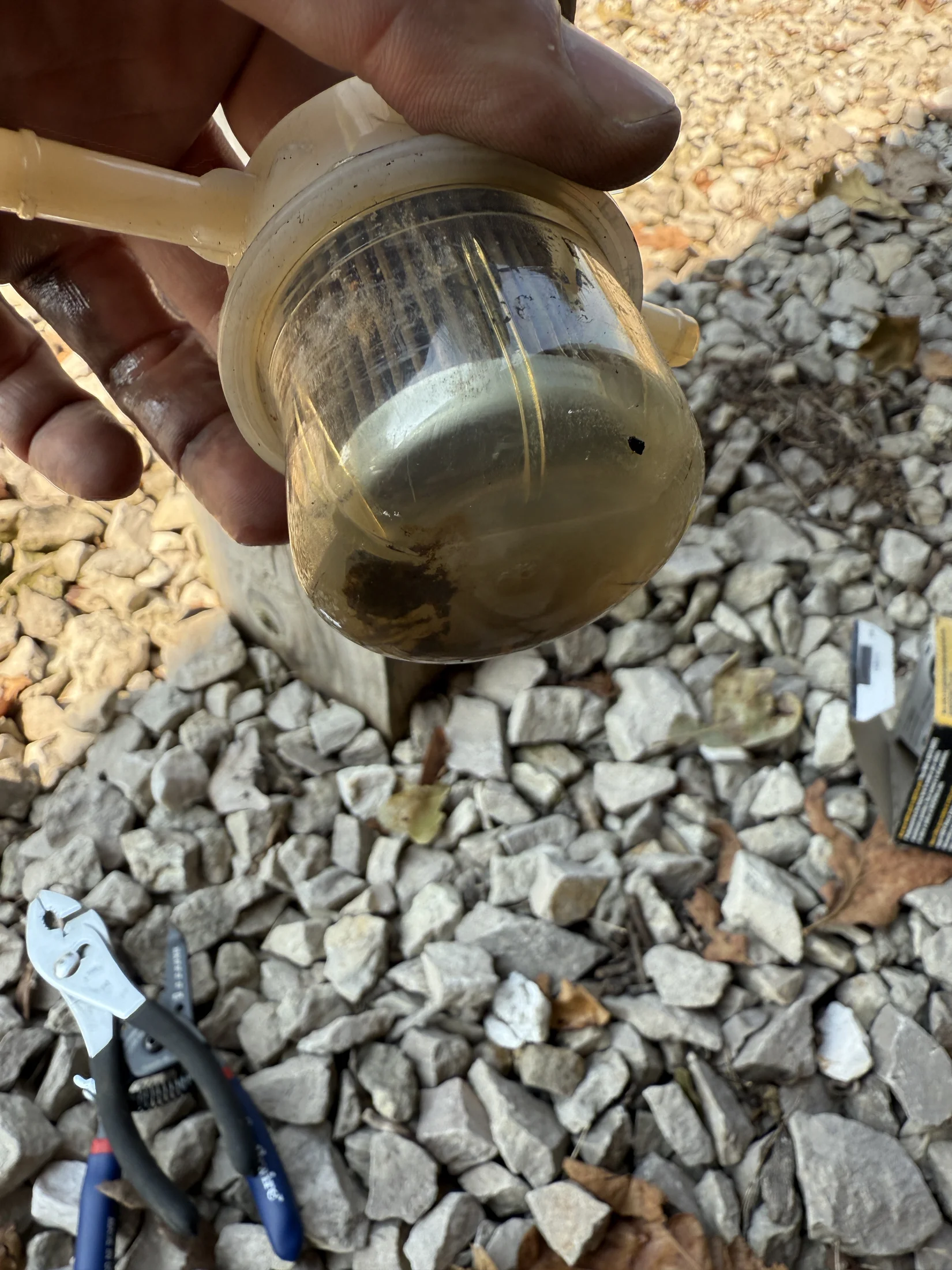

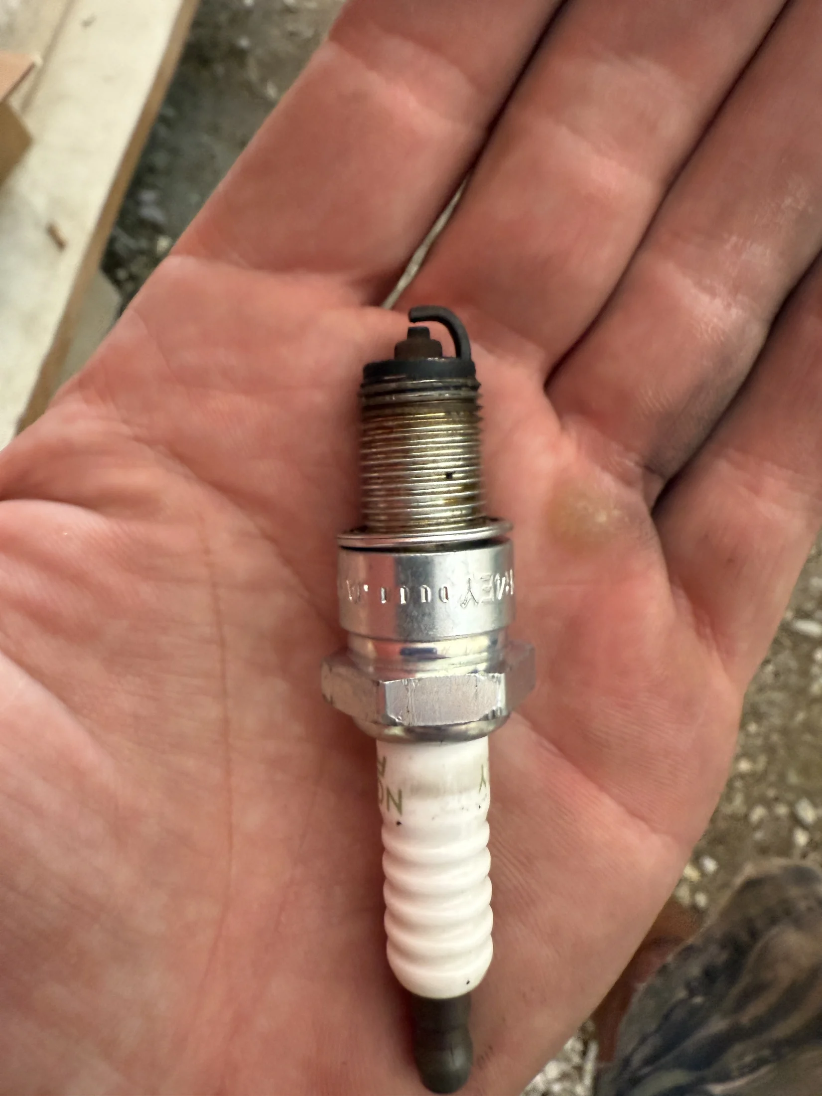

Ok, i have removed and cleaned and checked the gap on all sparks. Put cables back. Removed and cleaned fuel filter (it was nasty).
Took her for the spin and magically everything is back to normal...she idles like nothing happened.
Now, look at the sparks, all are looking the same. This does look like she is running little rich to you?
Also, old fuel filter
These old engines can get the spark plugs oily and then black by running the engine for short jaunts - not allowing everything to get real hot and burn crud off.
Short trips play hell on the spark plugs.

Do you have a filter sock on your fuel tank pick up tube? You may have some rusty dregs in your fuel tank. The spark plugs do look a little too black.
Agreed, there had to be some garbage which went into the tank...
@Spark plugs - I'm trying to drive more and more at the longer distances now that i plowed through the basic maintenance and tuneup.
This car was sitting basically for the last decade or so. It was drive from time to time around the neighborhood but that's pretty much it. Let's just say that car wasn't in the "highway ready" condition. That all changed now. Baby steps.
Today I hope to check timing on it. I already did compression and vacuum tests - all is looking great. Once with all the results in hand, I will probably look into the carb tuning. Maybe my 60 is running little too rich...

Awesome, yes, i put the can of seafoam too. I strongly believe it was dirty fuel or some dirt got into the carb. All is working fine now tho.
