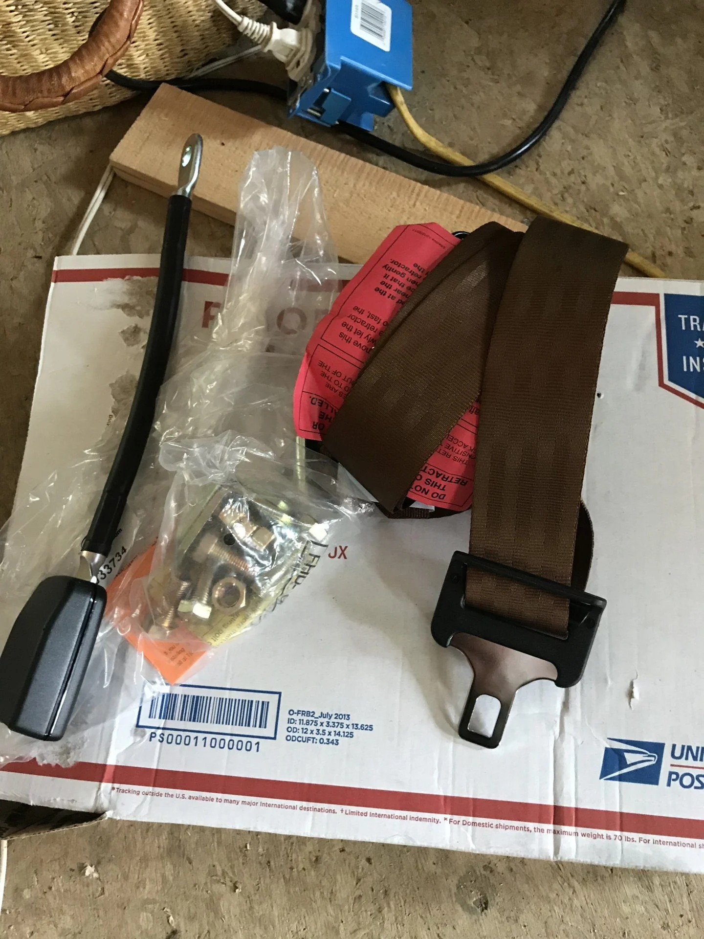

Seatbelt planet. $284.90 shipped for driver and passenger front brown belts with hardware. Looks decent. Have not put them in yet. Lots of colors to choose from and about 10 days from when I ordered to when they arrived.

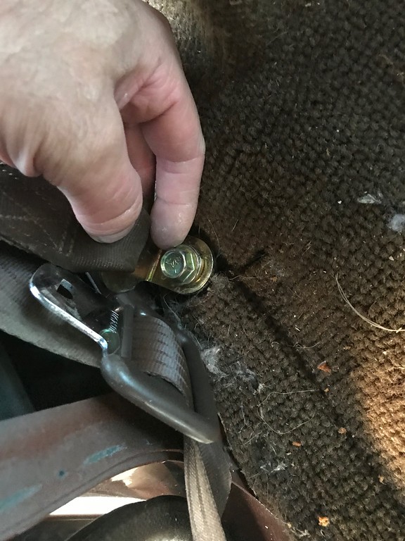

Last night I replaced the rear dome light with a new one from SOR so now I have.....not one....but two properly working interior roof lights (its the simple things). I also attacked the driver's seatbelt replacement.

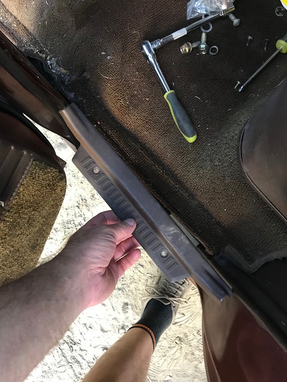

Step 1: remove thee 4 screws holding the plastic floor edge trim piece down:

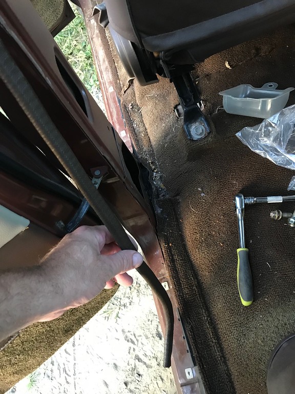

Step 2: Pull back the door opening seal:
Step 3: Remove the screws holding the floor plastic at the rear door:
Step 4: Pull the Door seal back
Step 5: pull the B pillar lower plastic cover out of the way....should pretty much fall out. No picture

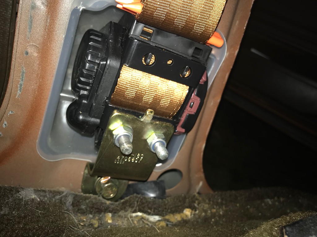

Step 6: Remove the 3 bolts that hold the retractor belt in place. 1 bolt up high on the B pillar, one bolt down low under the recoil mechanism, and one bolt on the floor just behind and under the carpet of the B pillar (follow the belt).

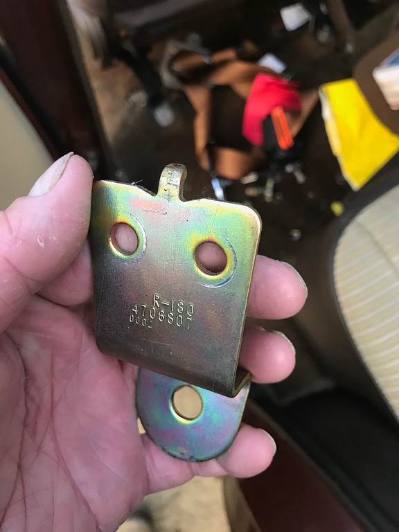

Most of the swap is pretty obvious and self explanatory. I did have to take the old bracket off the original belt and bolt it to the new belt. I luckily had a pile of bolts to sort through for this but all were too long. So for now I have two longer bolts in there so I could use the truck and I'll pick up 4 grade 8 bolts of the appropriate length today or tomorrow so I can fix the drivers side and reassemble and then do the passenger and be done.
I should also mention that I put copper anti-seize on the two bolts that mount down through the floor as they are exposed to the world on the bottom side.
