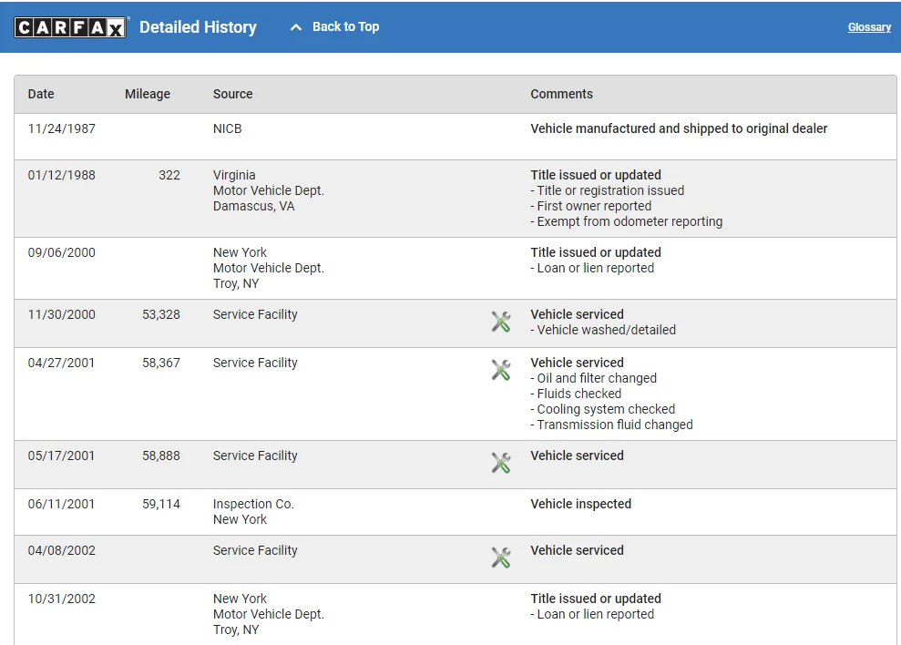

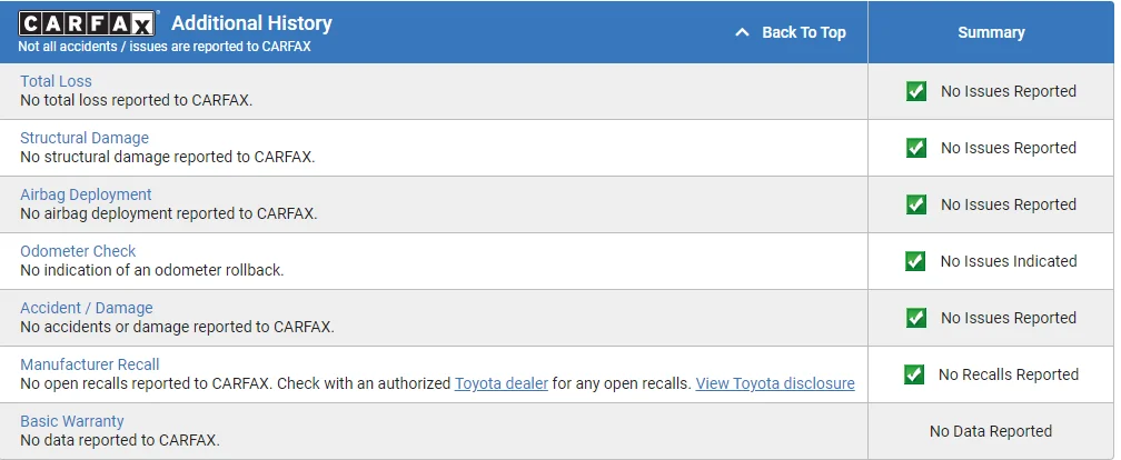

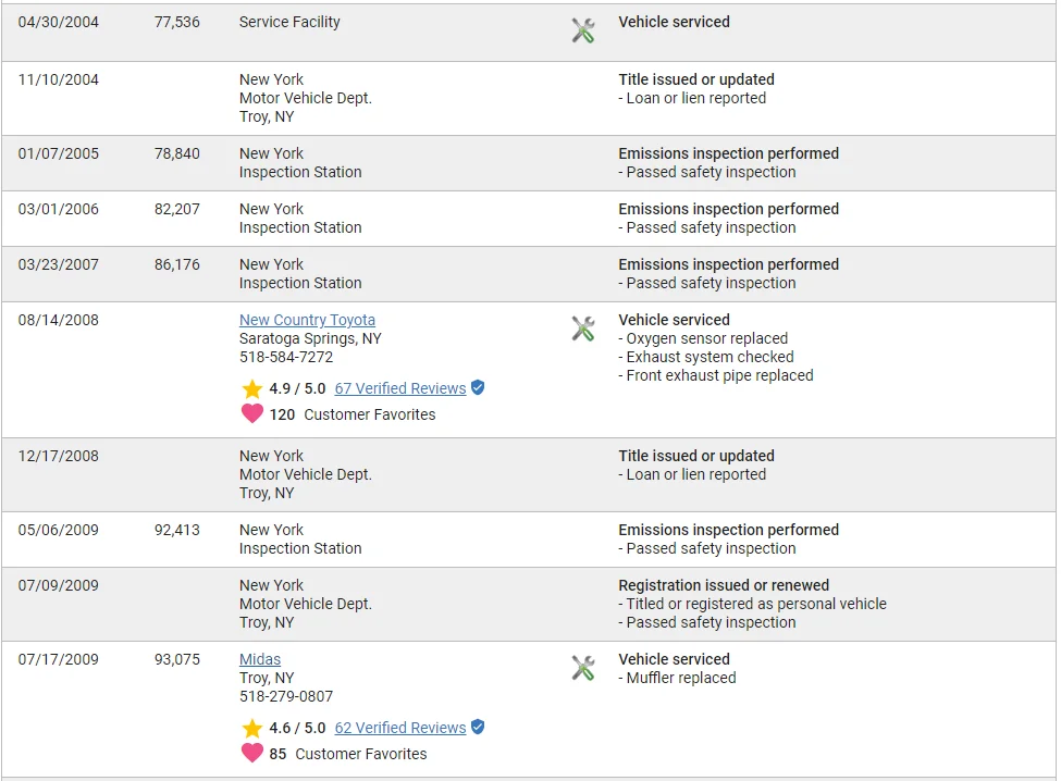

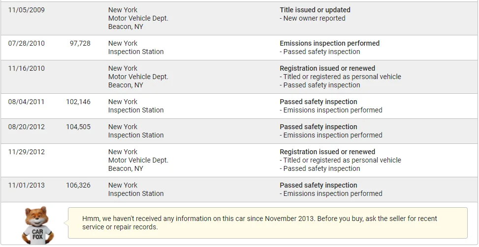

Looks like the mileage could be actual. Well that would be a nice win.

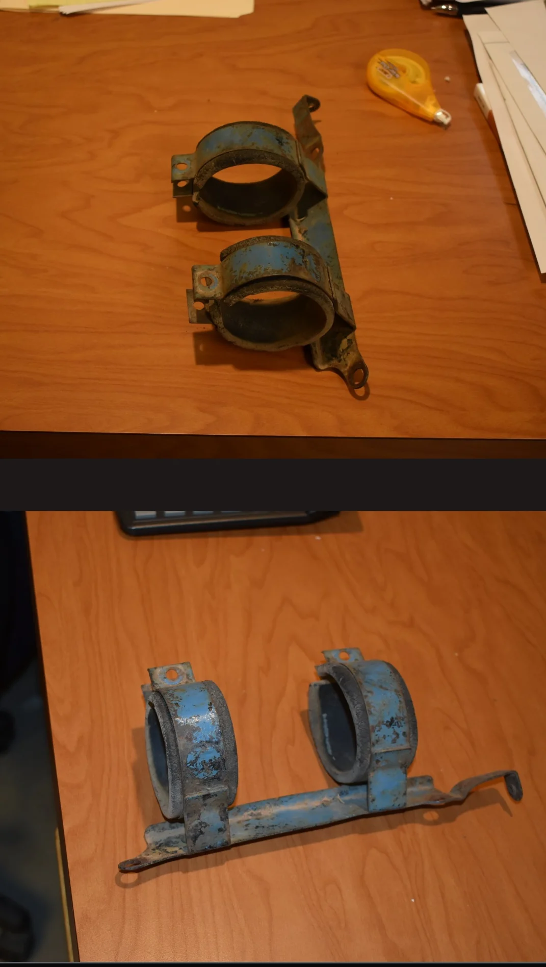

Have an A/C rcvr drier bracket?
I'm going to wager i do. The engine bay appears to be 100% stock. The only component I noted was missing was the headlight washer bottle but thats not surprising. Got a picture of of what you are looking for? I'll put a thread up in Parting out to keep this one from derailing much more :D
I put up a thread... Unsure if pic i have is rhe bracket

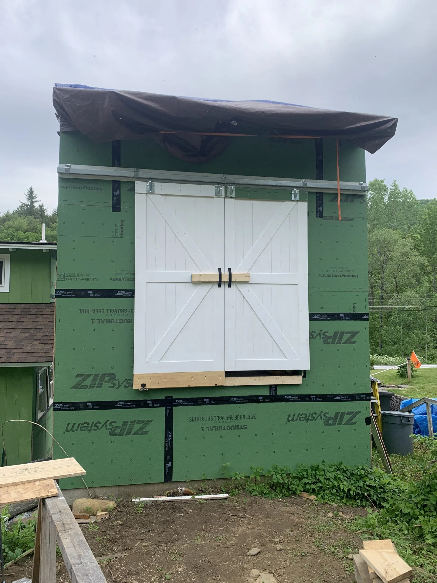

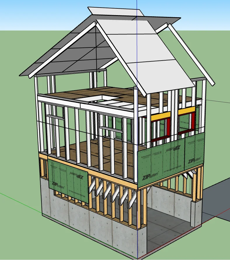

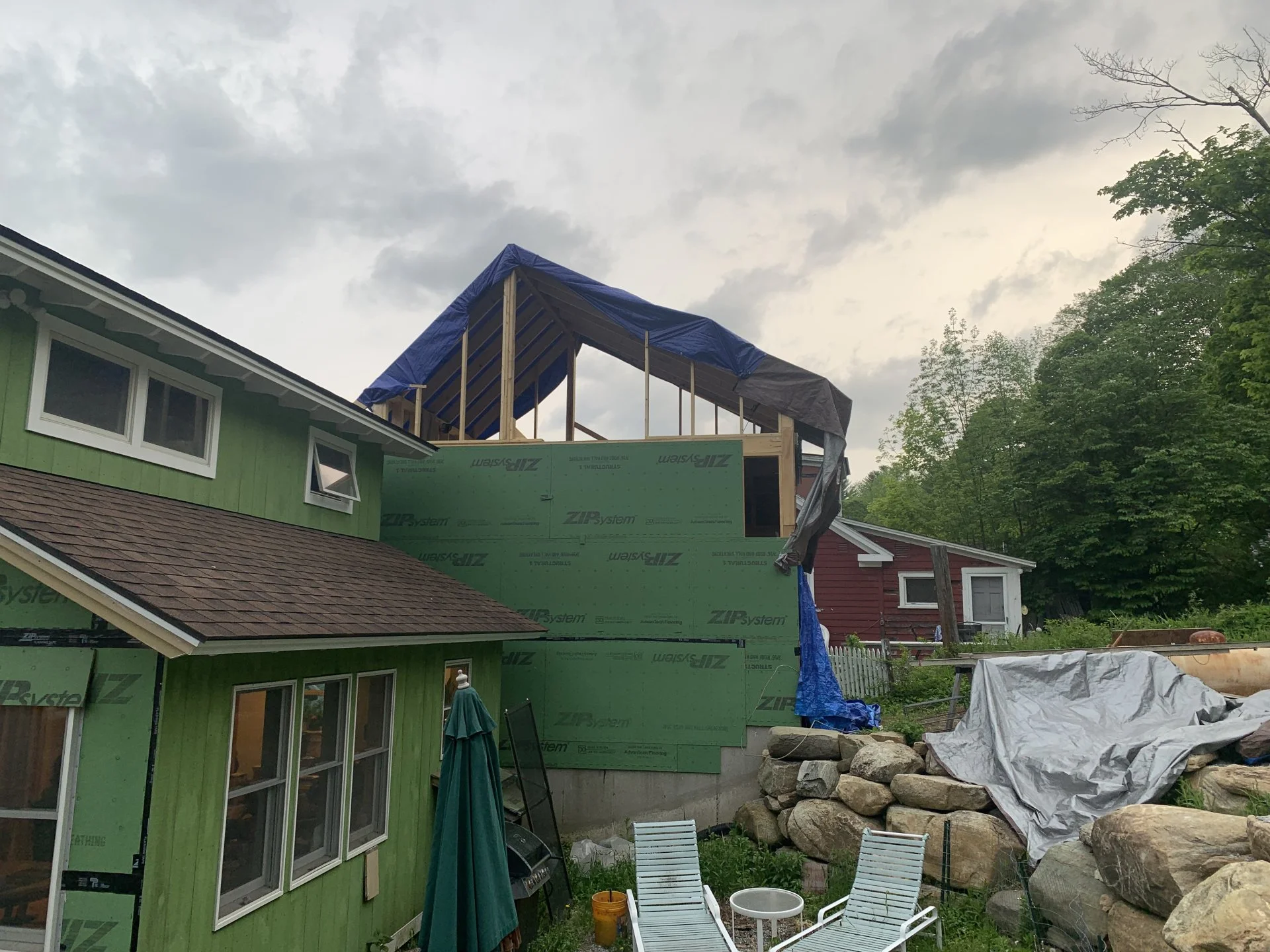

Been pretty quiet over here in this part of the world. Cruiser is hiding in my garage until I have time to get at the engine. So at least it’s out of the sun and weather. I’ve been trying to finish my garage…it’s a mere 12x18 foot print but it’s basically 3 stories tall..but if a tower 😂.
This is the working drawing.
The white doors are on he second level where the workshop is. I’ll be building the deck back here pretty soon…make life a lot easier to get in and out. Building materials right now are atrociously expensive. $12 for a 2x4 10’ long. Luckily I bought most of the materials when prices dipped.
