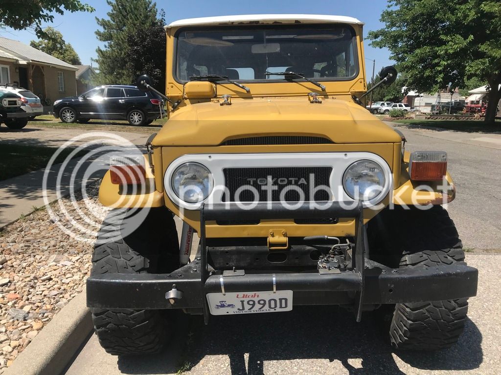

Update time. Getting ready for a lot of work to be done on the 40. I'm ordering new quarter panels for it and will be getting the whole thing yellow again. Mostly trying to clean it up now. It has been running great and I drive it at least once every week. Decided to show off some of the paperwork mountain that came with this thing.
