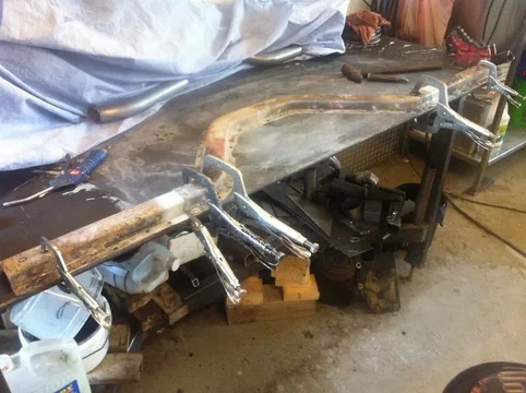

Merb, I have a mask that works good. It's a 3M I think. Today I just went one spot at a time and cleared the air with the blower. I had to go one at a time because I forgot my auto-dark helmet at work and had to use the old school flip - not my strong suit given the delicate nature of the thin metal.
Some pics
Had to weld the three parts of the x-member together straight and flat
Took an old bit and ground the end flat - then ground the back of the flutes. Made it like an end mill
Works real good to remove the primer
yep, burns through real good.
By the time I was done I had the welder dialed in :lol:

I match drilled the cab mounting holes through the 2x4" tube. Took the tube to work and used the drill press to make the through holes straight. Then I opened them up with a hole saw to about an inch to fit a bit of small round tube through (not shown). Then I used the new TIG to weld the round tube inside the rect. tube to prevent it collapsing when the cab mount bolts are tightened. I just bolted it in place for now. I will have to set the cab back on the frame to complete the miker method and mark out the exact locations of the roll cage.
Now, to the front landing points for the cage. The worst rust in the cab is at the drivers feet where the factory put the drainage hole, a.k.a. the landing point for the cage. In order to properly access the rusty spots for repair I had to remove the cab mounting structure.
It may look worse here than it really is. I started cutting until all the rust was gone. I welded a brace across the door opening in case it decided to move because I cut away the rigidity of the A pillar.
Started new metal with the main post. Shaped and welded in the patch.
ground it smooth
Then welded in the floor portion of patch, ground smooth. I used a big chunk of aluminum clamped in place to hold the floor panel flat while welding. Also used a chunk of copper to keep the welding from turning to "drilling" of holes. And that is where I ran out of Saturday to work on my rig. Sunday I was at the shop working on bed parts - check the other thread for details if you like.
