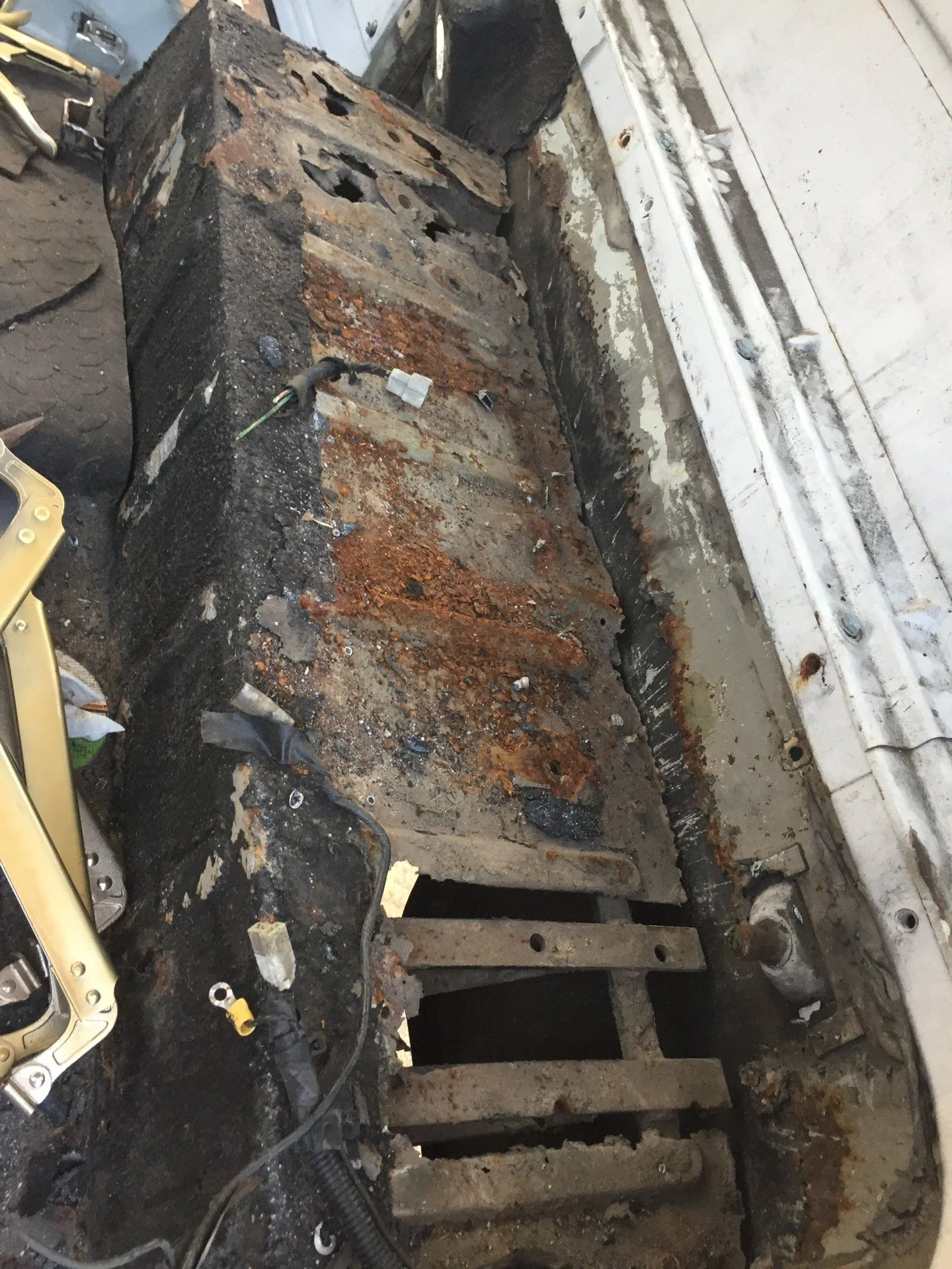

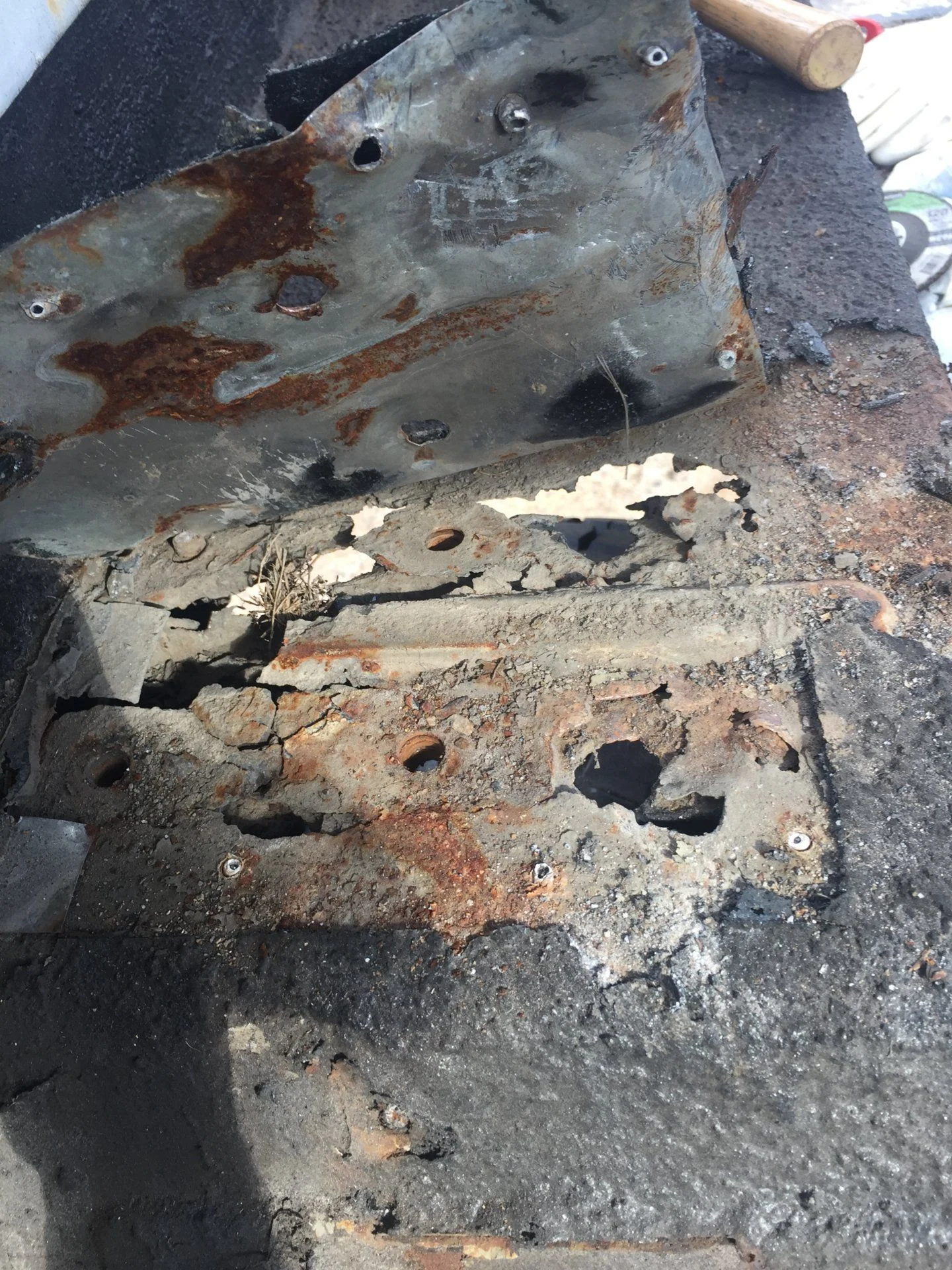

I removed the old seats, transmission cover and tank cover to find that he had riveted a floor pan over the old floor, sandwiching some quikcrete in there where the floor had rusted through. I haven't gotten to the drivers side yet, but instead of an actual floor pan, he just riveted a sheet of aluminum over that side.

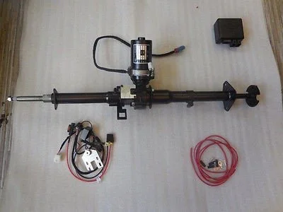

What have you liked about the electric power steering?
It was super easy to install. It's clean. No welding necessary. A little bit of cutting or grinding but nothing crazy. It's no longer embarrassing trying to parallel park in front of large groups of people.
I've driven @adistler1 's Cruiser and the steering is a little surprising. It's no saginaw setup but not bad at all. If you don't want to cut up your truck for power steering, this is a decent option.
So, not bad at all, but a little surprising. Could you describe what makes it surprising? Do it have artificial feeling?
I had a saginaw setup in my Cruiser and it was kinda like driving a 70s Buick. Super super easy to drive with one finger. More impressive on the trail in a tight bind... Still easy.
This setup was different in that it felt more like driving a 70s Carolla. Works fine. Steers easily. Just not the same. I also bet it's not super easy in a bind. So my advice is that this is fine for maintaining a clean frame on a street Cruiser. If I were to build a trail rig again, I wouldn't think twice about slapping in a saginaw.
I hope that helps.
And, this electric setup is not invisible. The unit on the column is noticeable under the dash.

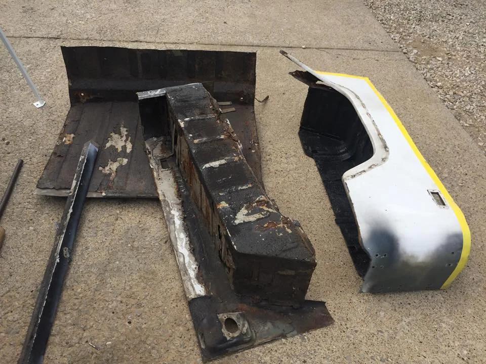

So, after a couple of weeks, I was able to get back up to KY for a day and a half and we tore into the truck. I started by cutting out the floor. It was so rusted, it basically peeled back like a can of tuna. We taped off the quarter panels and started cutting. I was able to remove it all in one piece, so that went quickly. All in all, we had pretty much everything out in about 3 hours.
Harry's buddy Jimmy has a 67 Chevelle that he's working on. He said the car "was pissing him off", so he came back to work on mine. Man, these guys love it. Jimmy grabbed my grinder and started on the rivets holding in the supports coming off the rear cross member. Mine were completely rusted out, but the cross member was still in good shape, so we removed those and will build the replacement for them.

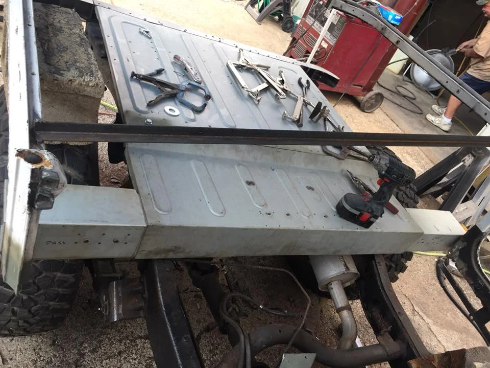

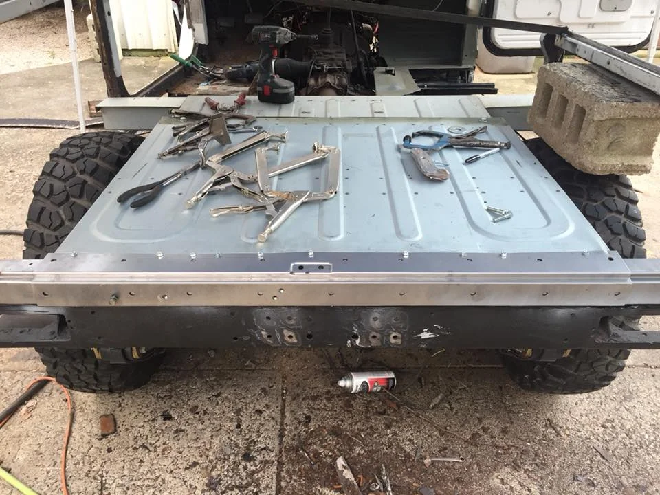

After that we got the sill and floor put on.

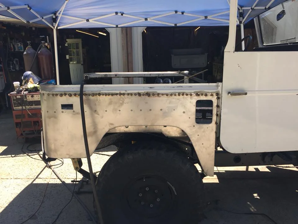

And then the mid bed and wings. Everything is held together with sheet metal screws.

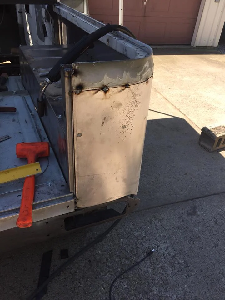

From there we grabbed the wheel wells and the channel at the back of the truck. Everything squared up perfectly back there so we tacked it together with some welds, then put on the quarter panel. There was hardly any work getting fitment right. We had to work a couple spots with the hammer and dolly on the curve, but for the most part, everything lined up and was square and tight, so we tacked on the wheel well top to the quarter panels and started on the spot welds on the top of the panel.
