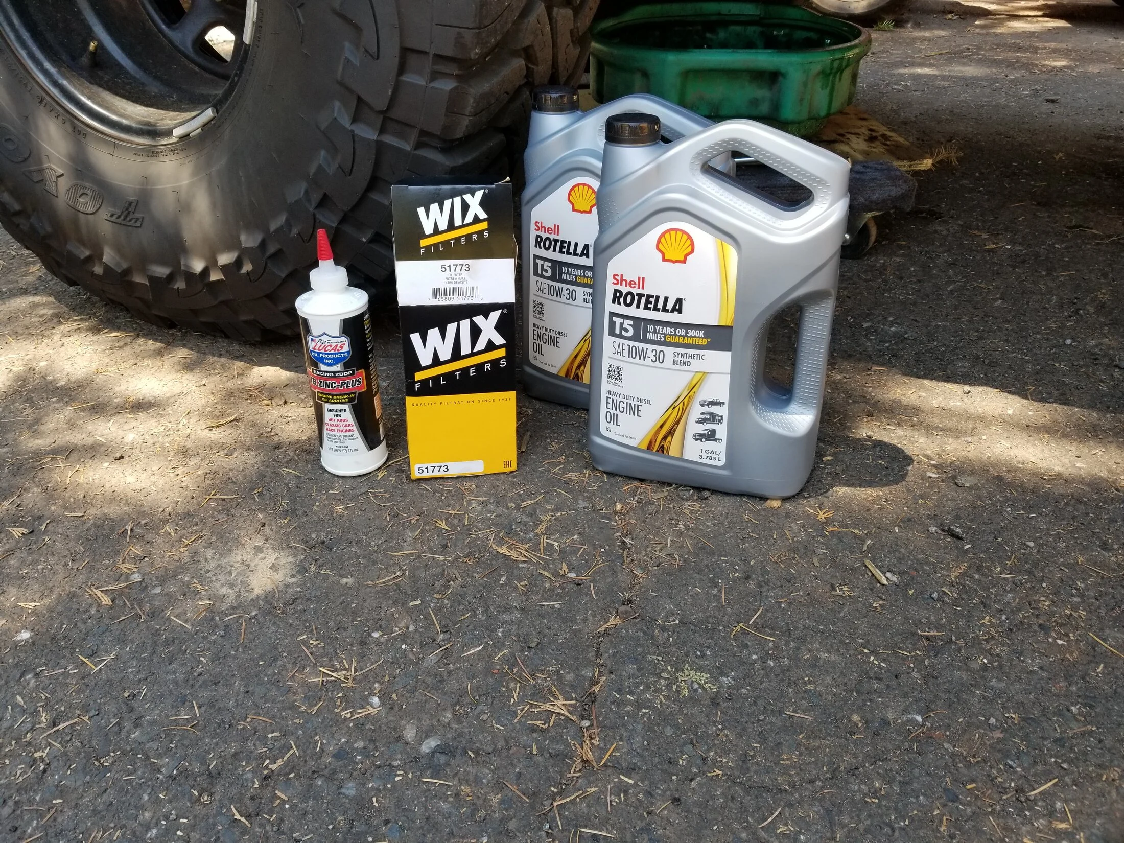

So many different options people are talking about. I want to pick up the right stuff!
Is this the right stuff???? Also do I need any additive?
