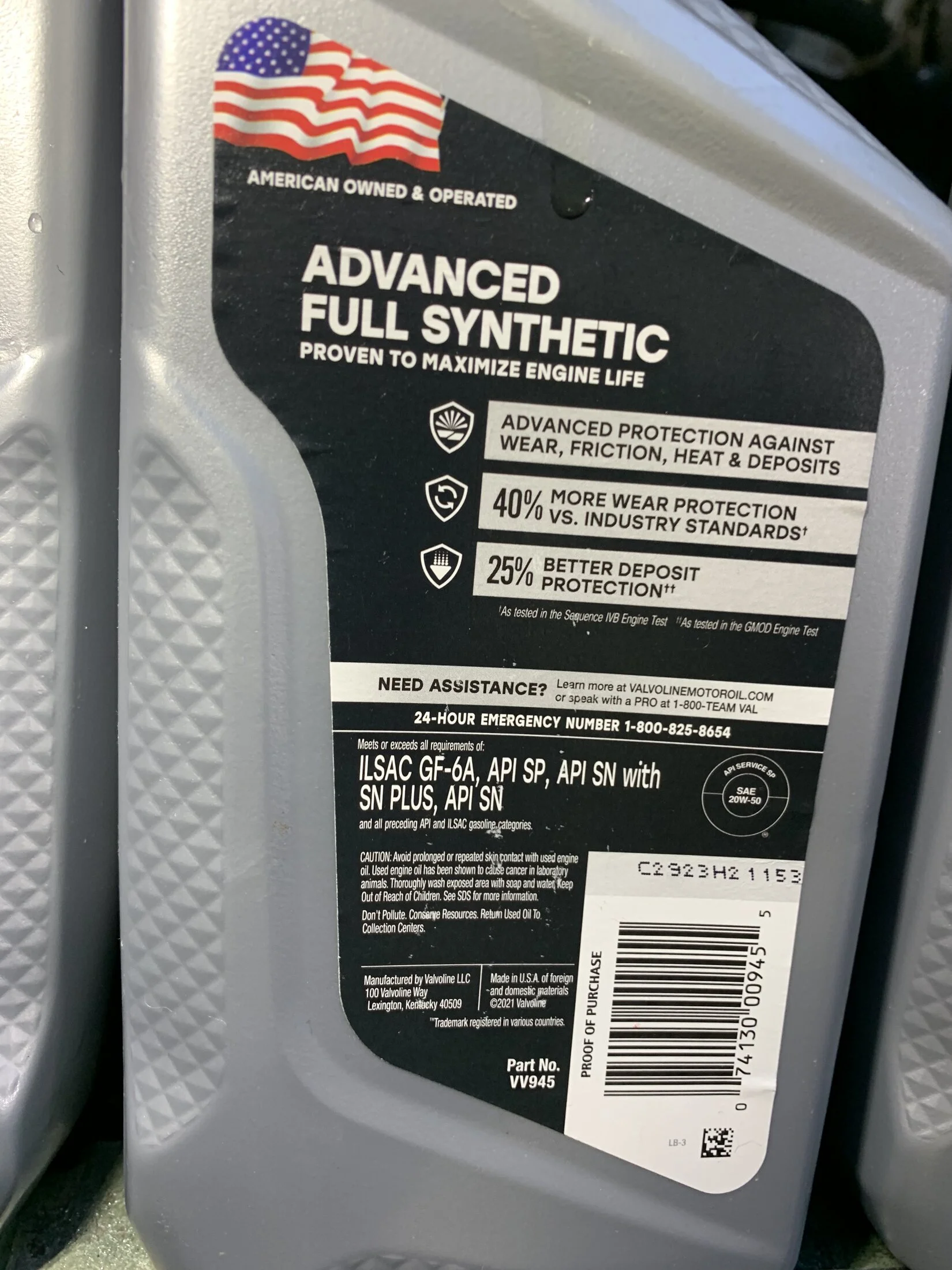

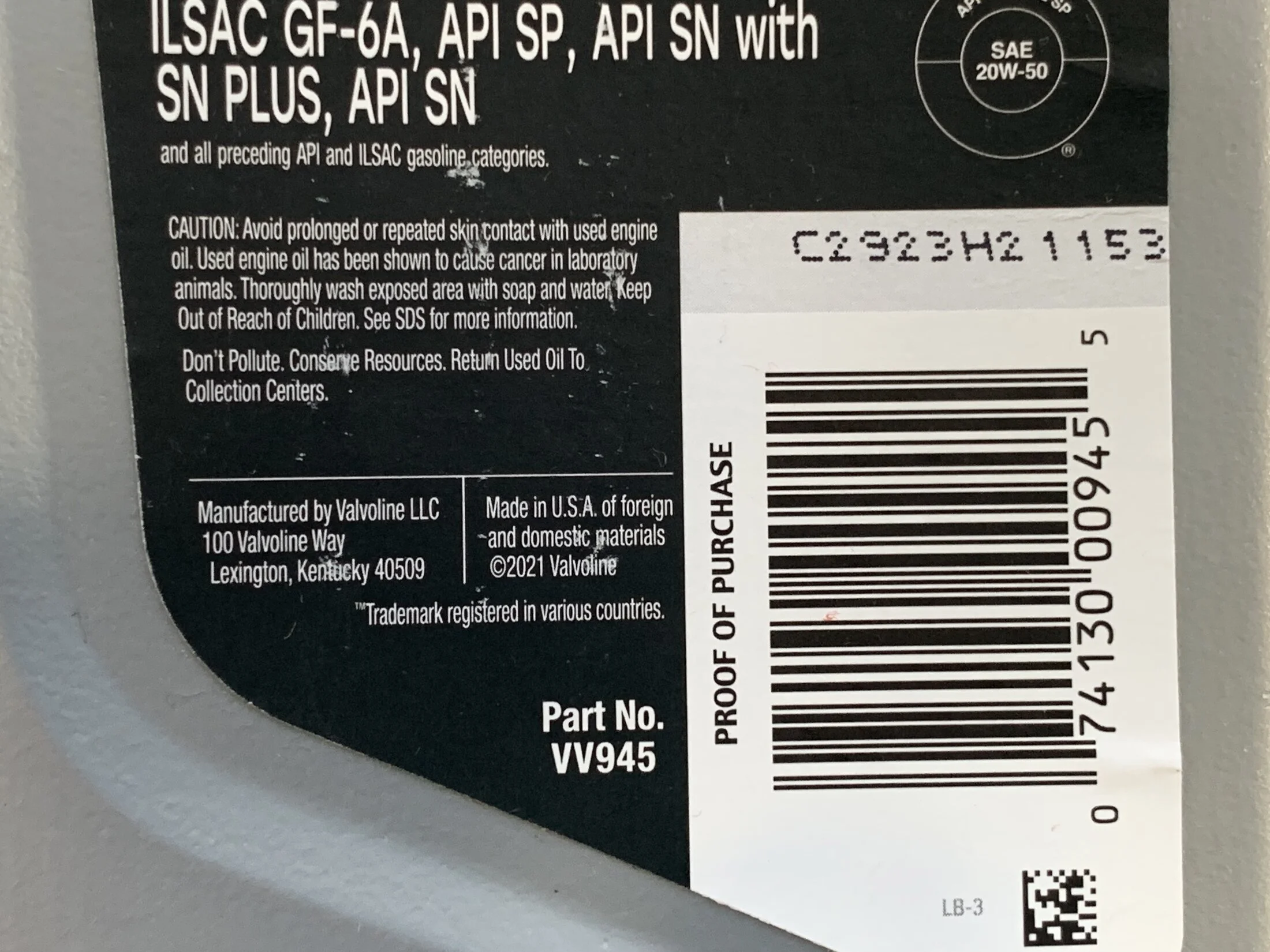

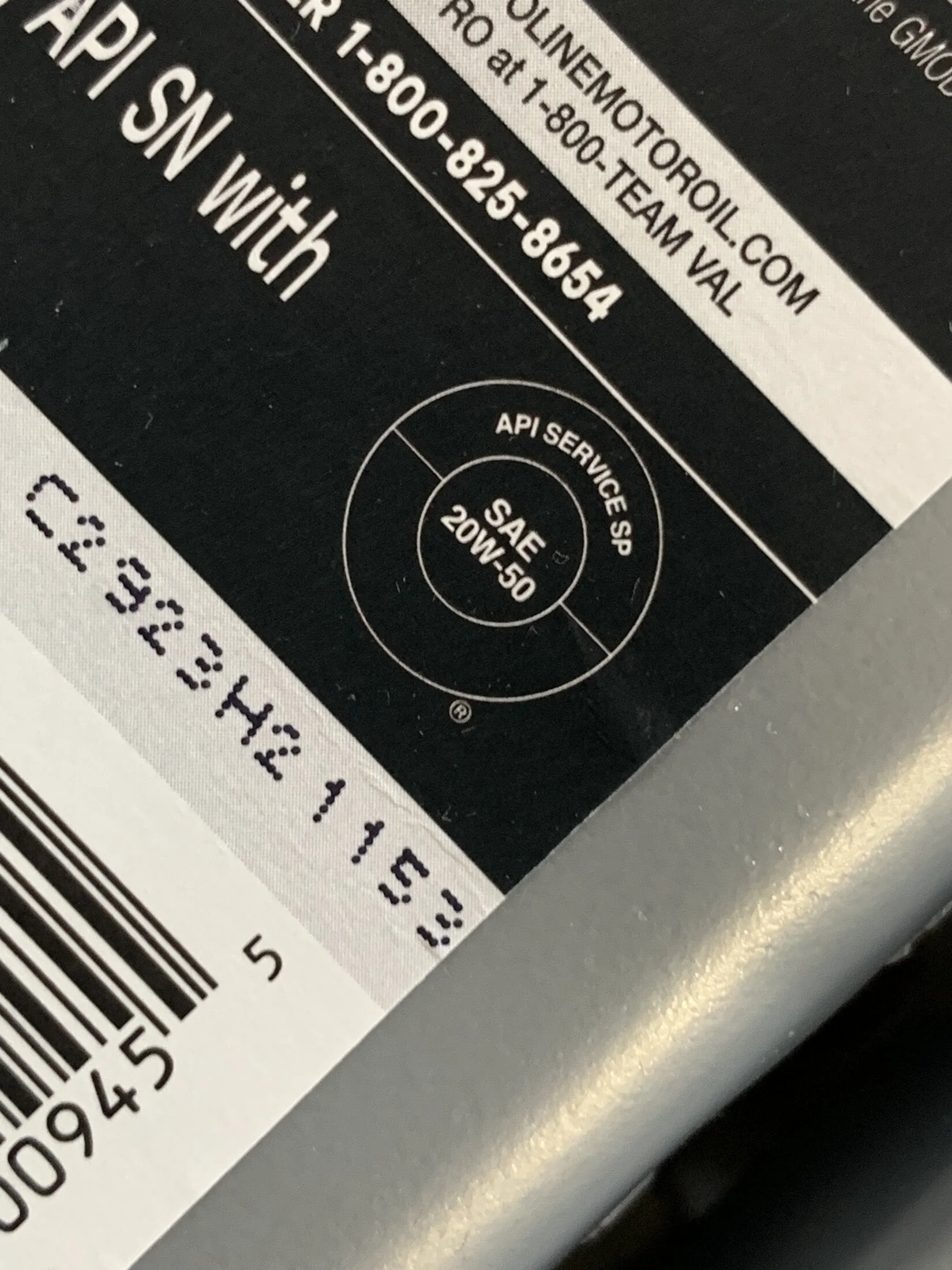

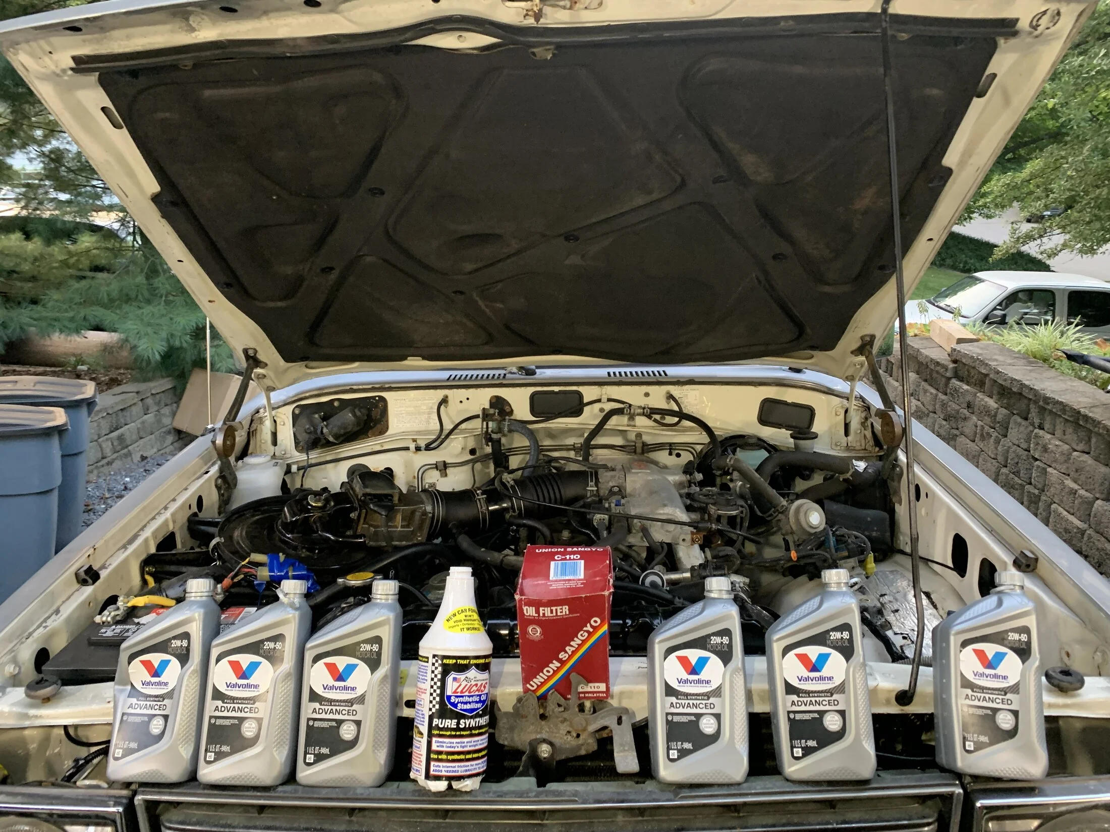

Only the below ⬇️ Valvoline 20w-50 is API Certified ( American Petroleum Institute )
My 3F-E still runs Catalytic Converters , so it’s particular ZINC-Recipe Level is Safe for them …

Personally my vintage stuff always gets non synthetic, I have been using Castrol Classic 20W50 in my 78’ FJ 40, it’s typically available at any local parts house. I used Valvoline VR1 with an additive on a later year 2F after rebuild in my 60, but have now switched it to Castrol Classic.

X2 for valvoline 20w50 Vr1 @Skreddy . Like said earlier, it has the higher zinc compared to Most other brands. Also, they have a $5 rebate through PayPal for every jug of oil you buy. It's a double win and ends up being cheaper than the other brands. My 1f engine really loves it, i noticed a reduction in engine clatter, especially during the summer .....as for another popular oil, The rotella 15w40 has been lowering their zinc levels over the years, and it happens to be an oil often recommended here in mud. I don't think it's so good anymore. If people want high zinc, I think the highest you can get is Lucas hotrod brand. It's a bit pricey
